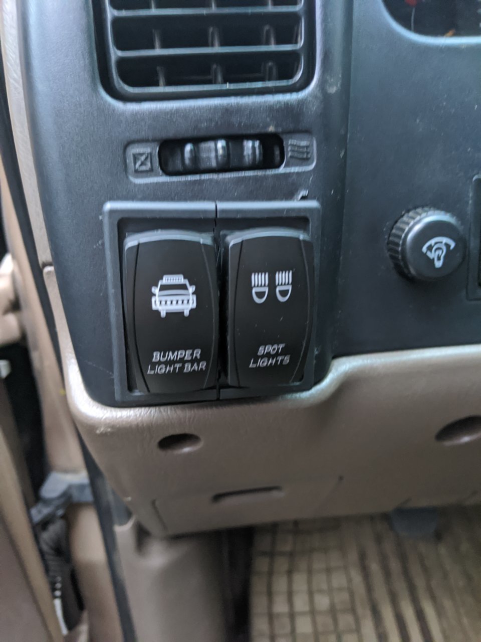

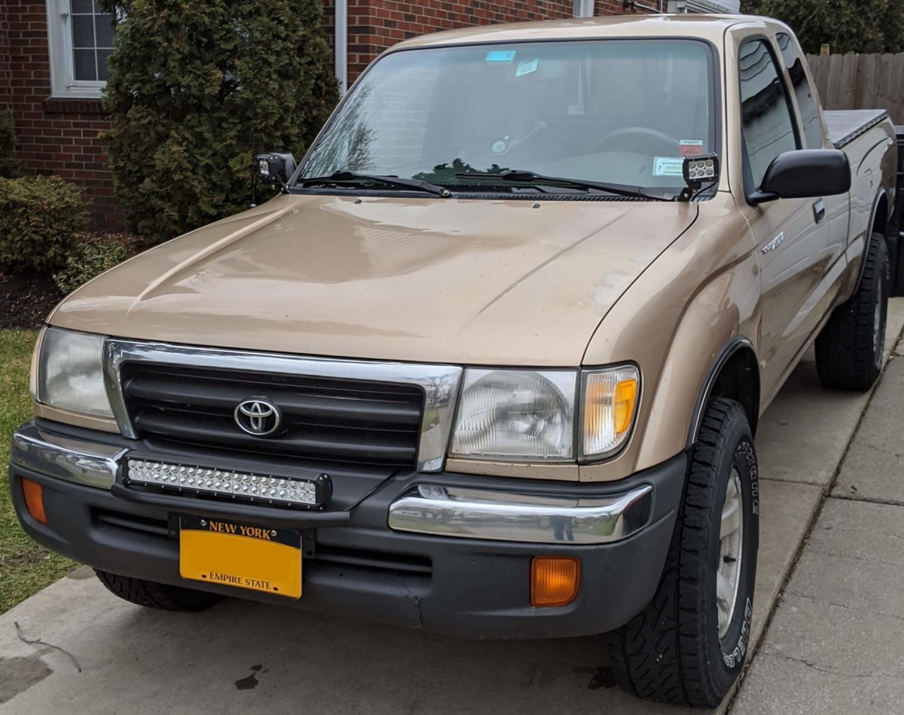

    Since I attend college in a rural area, I often find myself driving on two-lane highways in the dark. My high beams just didn't cut it, so I decided to invest in a light bar (with spot lights). I also purchased a license plate mounting bracket as I didn't want to drill any holes or cut anything. To mount the spot lights I bought a custom bracket off of eBay.
    I also purchased 2 light up switches and wired them so that the word illuminate with the parking lights, and the pictures illuminate when the switches are on.
    The wiring harness that came with the light bar had connectors for all 3 lights and 1 switch to control them all. I wanted to be able to control the spot lights independently from the light bar, so I bought an additional wiring harness and just cut the extra connectors off of the first harness.
    Since I don't have a diff locker, I moved the "clutch start cancel" button to where the diff locker button would be (closer to steering wheel). I made the original "clutch start cancel" hole bigger to accommodate my switches.
    Front end after installing everything.

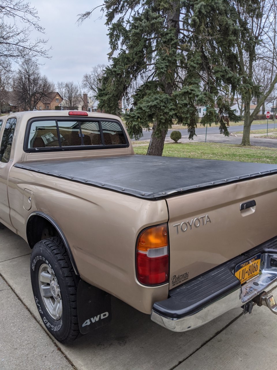

    The next order of business was to put a proper cover on my bed. A family member just so happened to have a snap on tonneau cover from when they leased a '99 tacoma. It took a LOT of heat to get it to stretch at first, but now I can snap it back into place with no problems.

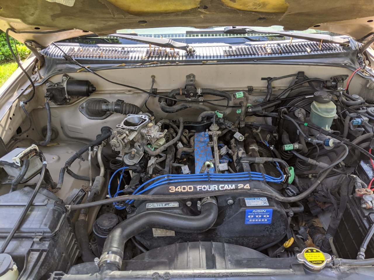

    Ever since I bought the truck I've had a check engine light (P0172). I decided it's probably time to fix it properly so I don't need to worry about passing inspection every year. Apparently the engine was running rich for so long that it caused my O2 sensors to go bad after putting new ones in shortly after purchase.
    I replaced the O2 sensors and I'm currently in the process of replacing the fuel injectors and fuel filter, as I believe those are likely culprits. Spark plugs, coils, and wires have already been changed by the previous owner shortly before I bought it (I checked for myself).
    I'm now waiting for new fuel injectors and gaskets to be delivered. Everything should be here by June 10th.

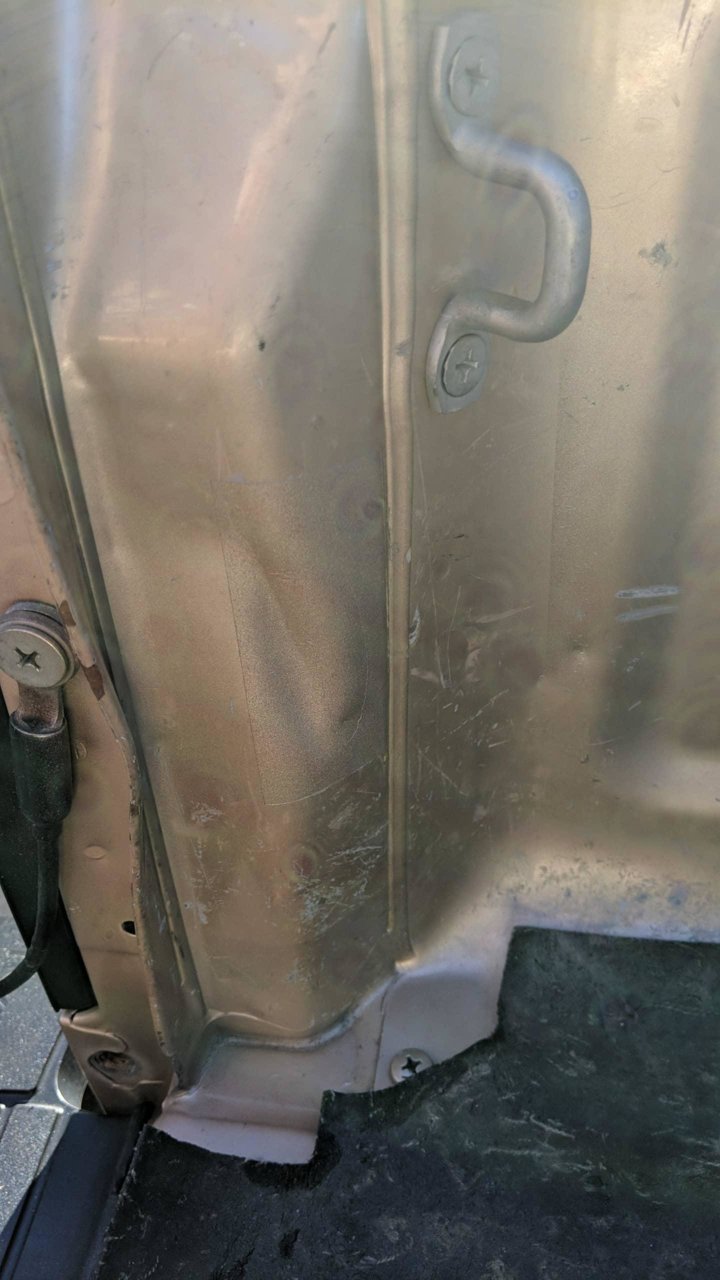

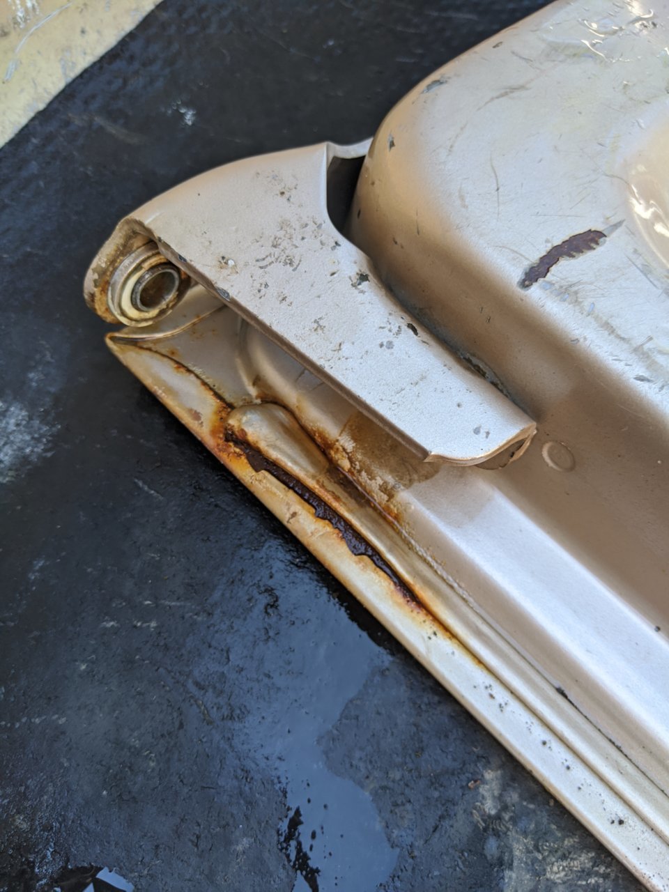

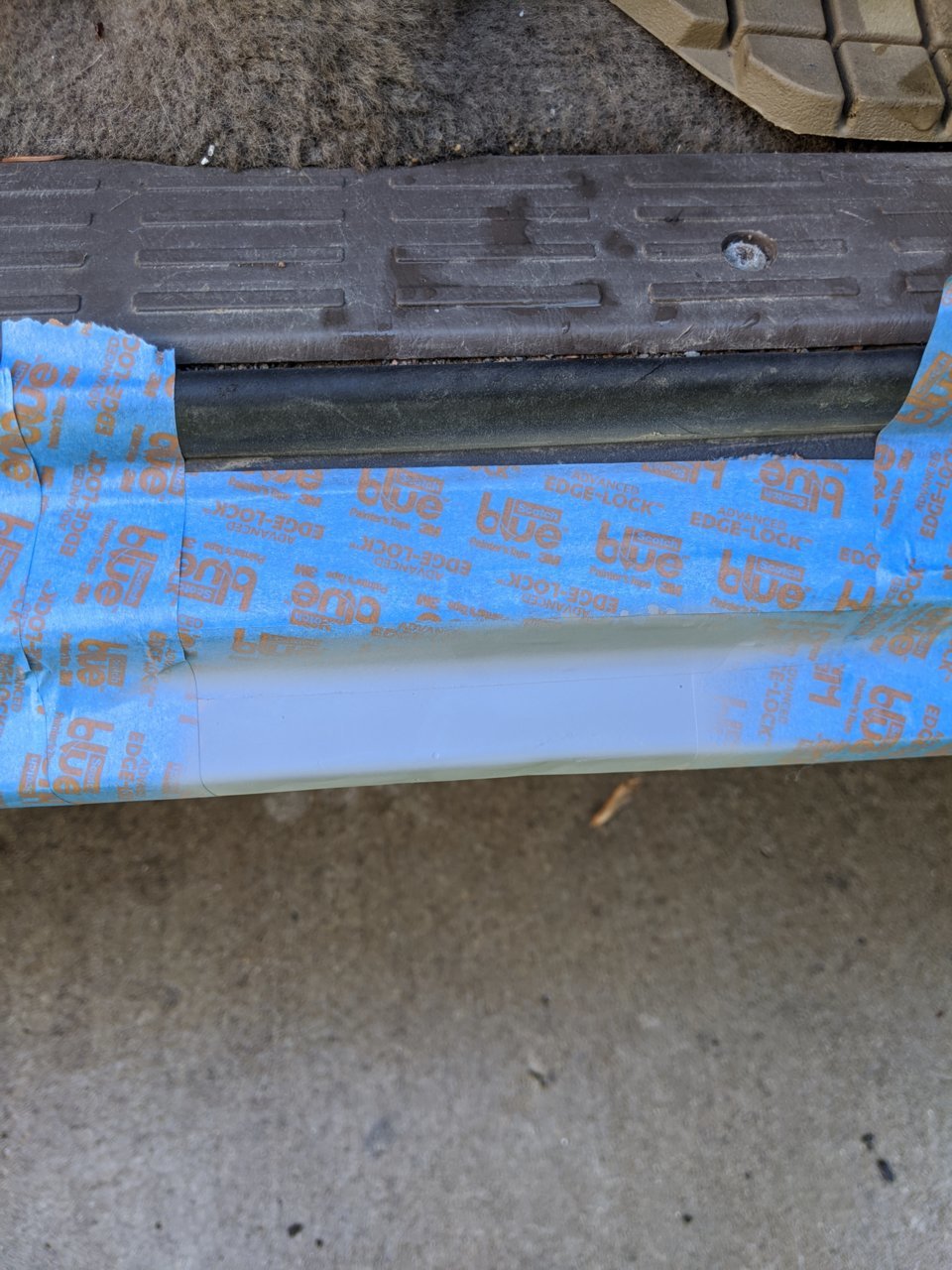

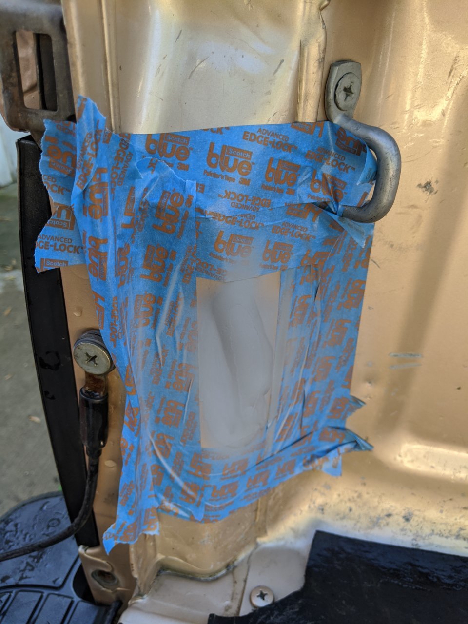

    Today I covered up some rust spots (I didn't get before pics for anything other than the tailgate).
    It's not the best job, but it's better than rust!

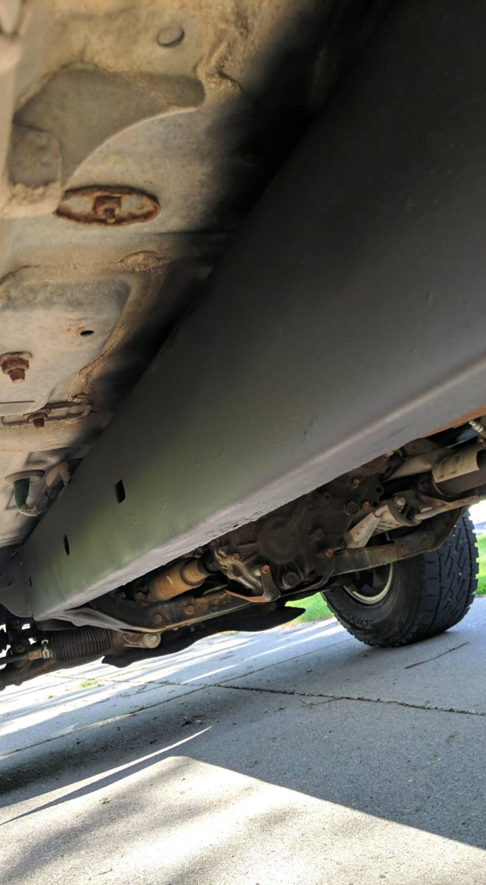

    I did this last week, but here's a pic of my frame mid-undercoating

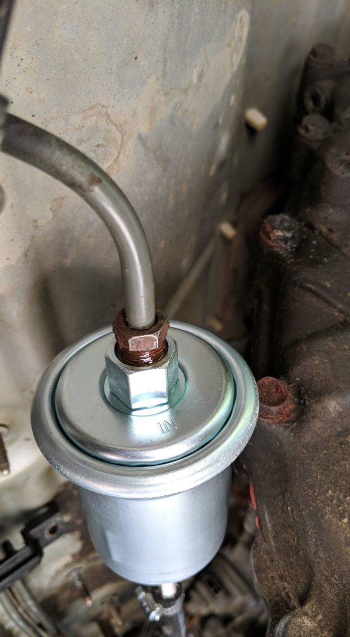

    I ran into a problem with the fuel filter while attempting to change it after putting in the new injectors. My truck hasn't been started in about 2 weeks as of right now.
  11. Jun 23, 2020 at 6:01 PM
    djm228
    djm228 [OP] Professional Dumbass
    Jun 21, 2019
    #297006
    133
    Dan
    Buffalo, NY
    1998 Tacoma SR5 V6 4x4
    The nut I ordered ended up fitting. The compression fitting that I have doesn't fit over the stock fuel line. It does fit over the new fuel line though. I decided to just add a small section of nylon fuel line that I'll clamp onto the hardline. The fuel line and clamps should be here within a few days.
  12. Jun 25, 2020 at 6:59 PM
    djm228
    Jun 21, 2019
    #297006
    133
    Dan
    Buffalo, NY
    I went to advance auto and got some fuel injector line. I cut it and slid it over the new fuel line section and the old fuel line and just used clamps to hold it on.
    The only problem I ran into now is a small leak on the "in" side of my fuel filter. It has the original nut and fuel line. I'm gonna try to fix it tomorrow, but I ordered another flare nut just in case.
    I'm honestly just happy that my truck is running again at this point. The fuel injectors and fuel line repair are the most involved/difficult jobs I've had to do on a car so far.

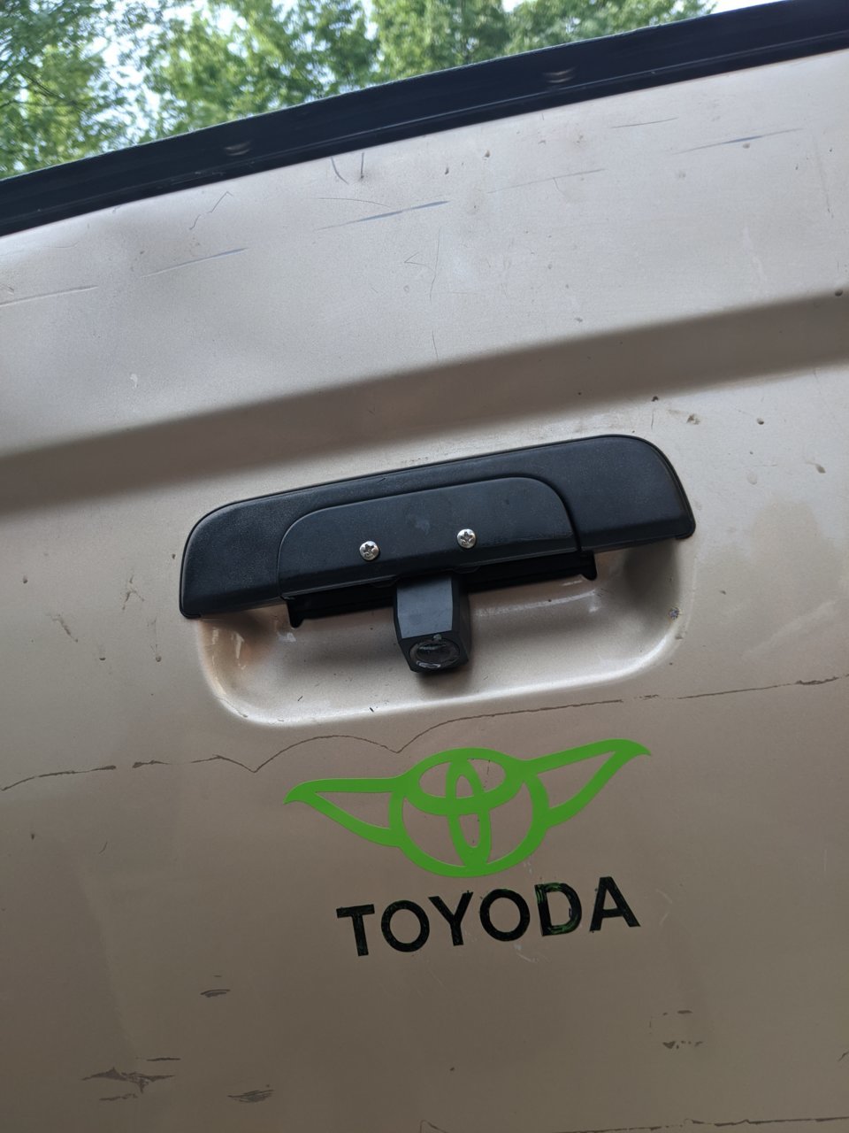

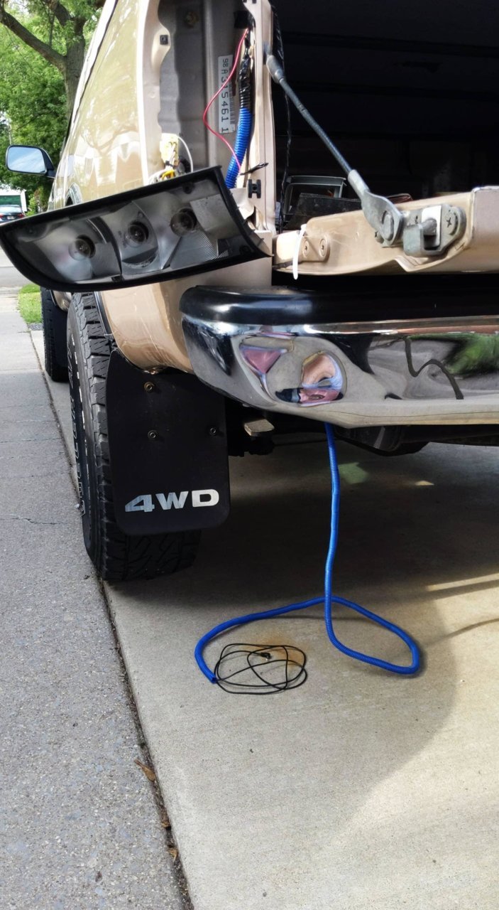

    I installed a rear dash cam/backup camera recently. I need to wire the camera to the reverse light tomorrow, but everything else is done as of right now. The one pic is towards the beginning of the install. I'll also get an interior pic soon.
