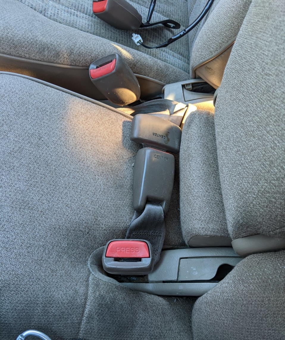

    I also put in a new seat belt because my old one was frayed and the retractor was kinda iffy. In addition to this, I got a new buckle. One of the wires on the original one was broken.

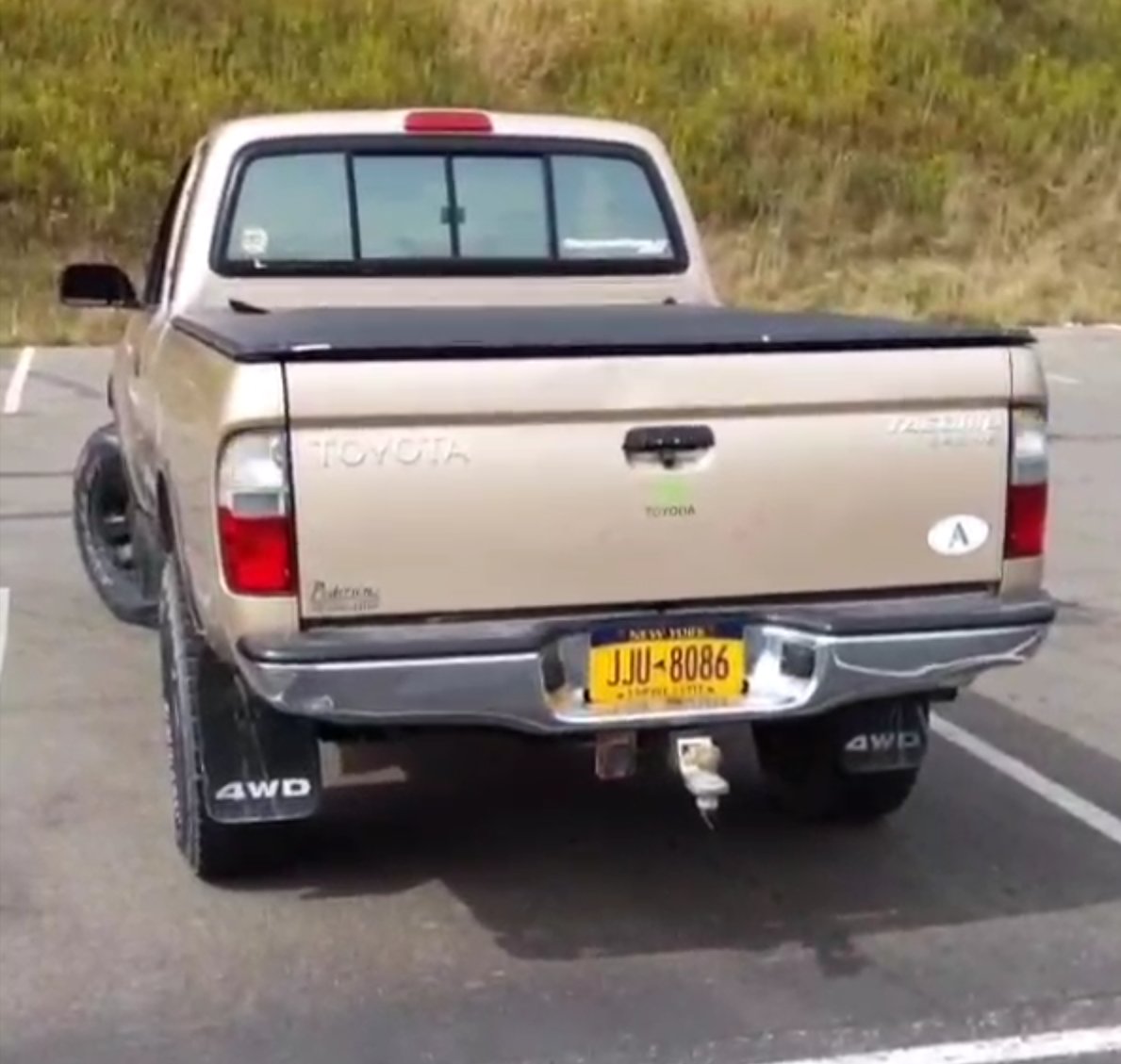

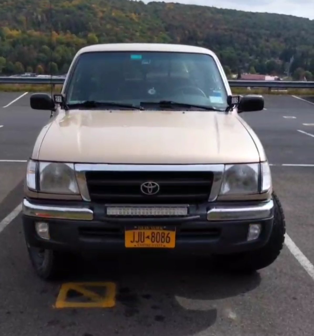

    I DID get pics of my new clear turn signals, parking lights, and clear(ish) tail lights.

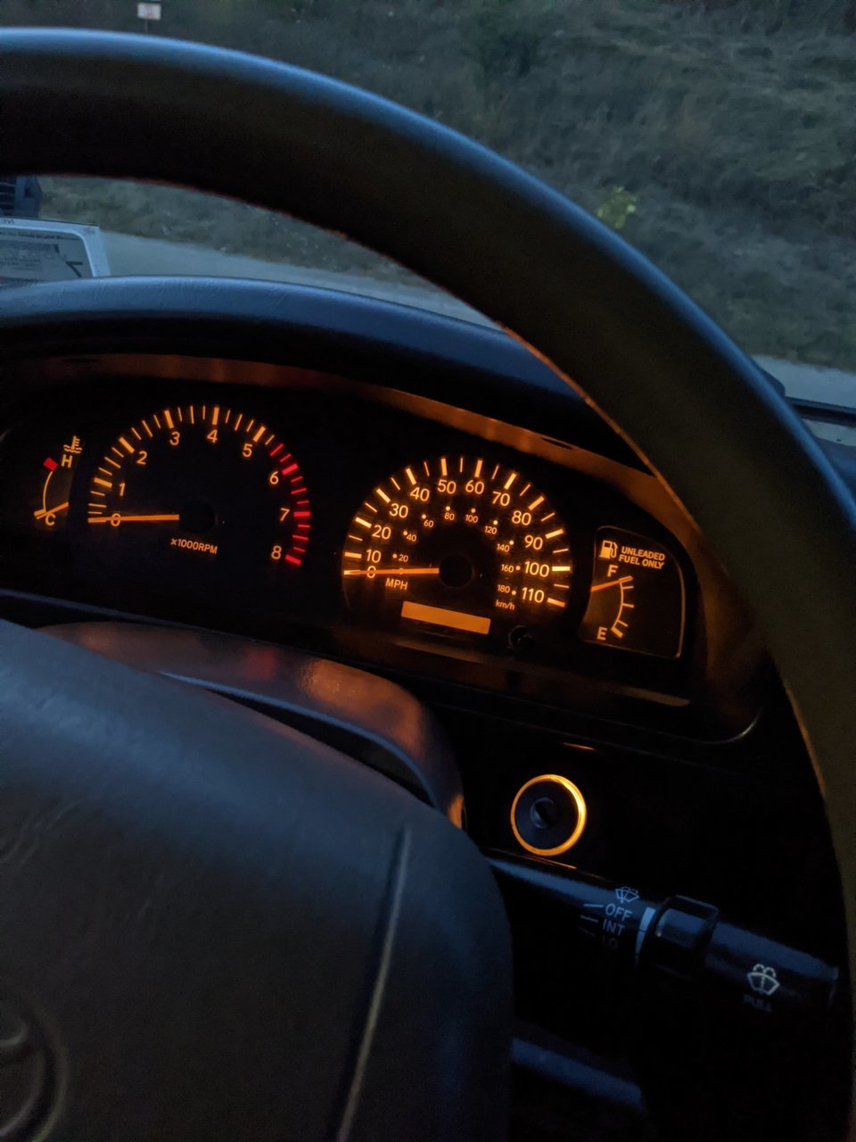

    I tried to replace the light that burnt out behind my climate controls, but I ordered the wrong bulbs :facepalm:. I found out that I had a functioning light ring around the ignition, so I just moved the working bulb into there.

    I removed all the green rubber caps from the bulbs. I think I might swap these out for amber or white LEDs. I can't decide what color

    Looks good - I put some blue dash lights in there and while they look cool, red / amber in my 2nd gen is definitely more we’ll suited to night driving.

    I've seen a few people do blue lights. It looks cool but I know it wouldn't help with driving at night. I decided on white, but I put 2 of the bulbs in backwards so I have to take care of that. I'm also having trouble finding LEDs for the climate control lights, so I have nothing there right now.

    I forgot about this thread :facepalm: whoops! I actually figured out that I needed T1 3/4 74 LED bulbs with base type W2.1x4.9d (seen in my post here). Was such a pain in the ass to figure that out.

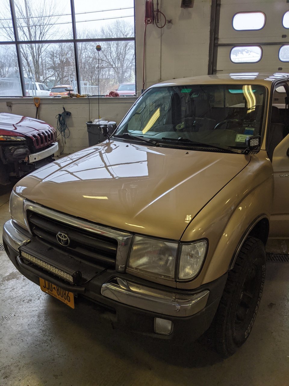

    I also got my hood repainted last week since the clear coat and paint were real rough towards the driver side. Had a family member do it and he didn't charge labor so it was worth doing.

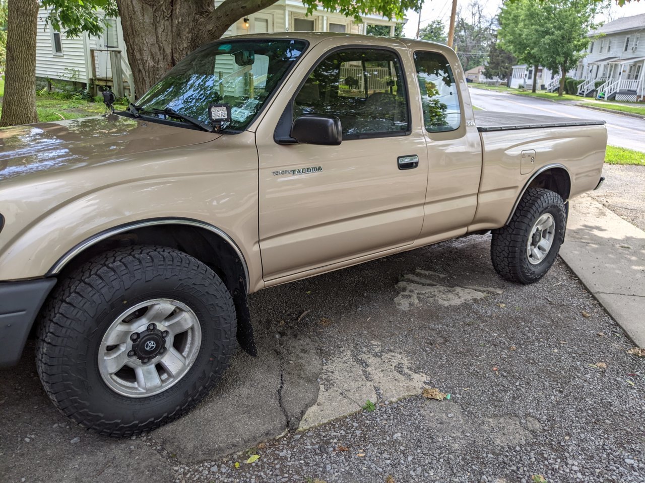

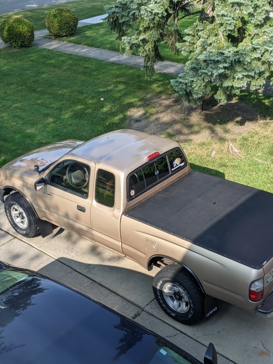

    I bought some Falken Wildpeak AT3Ws last month in 31x10.5xR15 and it feels like I'm driving a brand new truck. New tires really make a difference in ride quality. I also removed my plasti-dip because it was peeling in some spots.
    Old Bridgestone Dueler A/T tires 31x10.5R15, 7 years old
    New: Falken Wildpeak AT3W 31x10.5R15

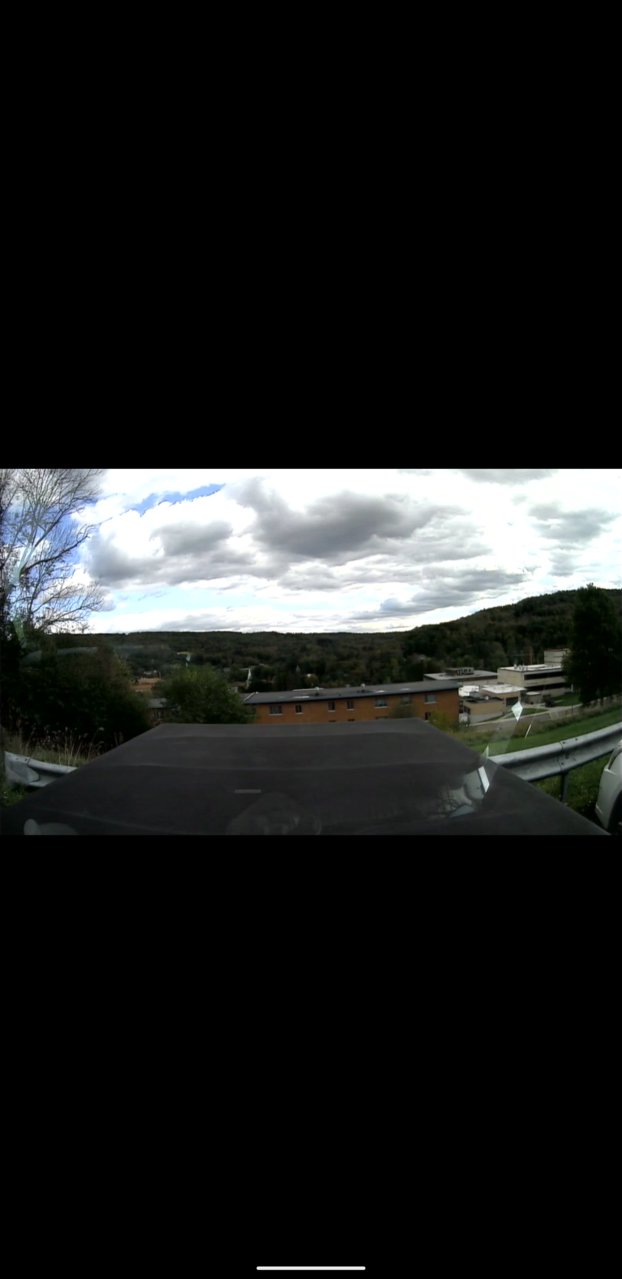

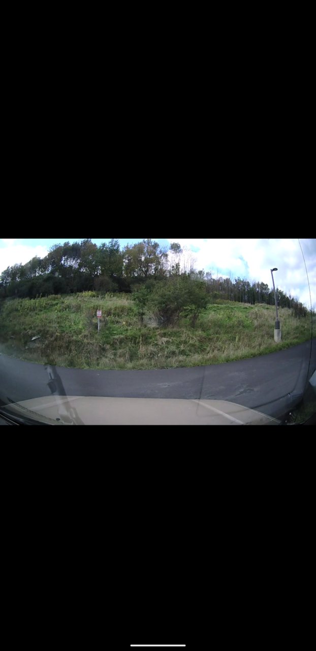

    I installed a Thinkware F200 Pro front and rear dash cam with GPS, which is much better than my no-name Amazon dash cam. The old dash cam was too wide and interfered with the visors, which caused some issues. I also removed my backup camera, as it stopped working a few months ago. I got better at backing my truck up without it, but having it for a short period of time definitely helped me gain a better idea of how long my truck is. I didn't grab pics of the dash cam installed, but I have pics of the video output.
    I really like this because of the wide angle lenses and app support. I can view and download saved videos right to my phone. The app even labels them as "incident" or "continuous", meaning the g-sensor triggered an "accident" recording vs constant recording with ignition on.
