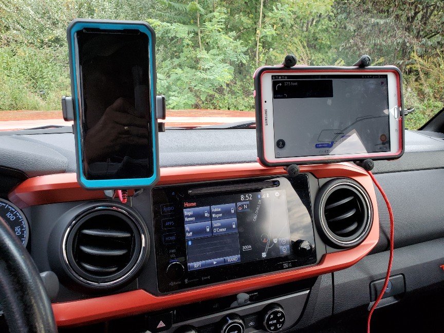

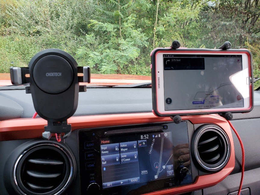

    I bought quadlock to use on my motorcycles. the cases were terrible. I went with this mount in the truck. Ordered holder from Amazon as well as dumbell adaptor to 1" Ram mount. works great!wireless phone.jpg wirelessmount.jpg

    I ran all the wires inside the dash to a power supply. Both on the passenger side Micro and C can pull out and be used by the passenger or power Tablet/Phone in the passenger mount

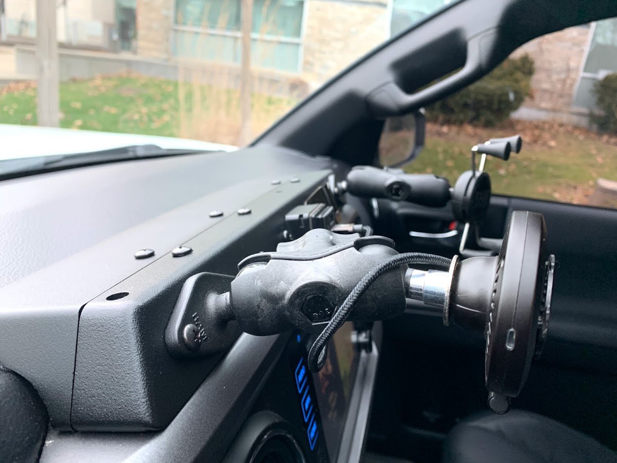

    I modded Quadlock wireless charge head to fit on a Ram mount actually. I've been using it since March and it's been awesome.
    I have it mounted to my EE 3TPAM. I used the ball mount from this it: RAM-B-367U
    Take the back cover off the charge head and ditch their mounting piece. Then use a bolt, nut, and fender washer to tighten down the ball mount.

    Thanks SRC. That’s exactly the scenario I was hoping for in mounting the charging head to the ball. I just couldn’t find any info about the back side of the head. I appreciate the post and info! Nice setup btw.
