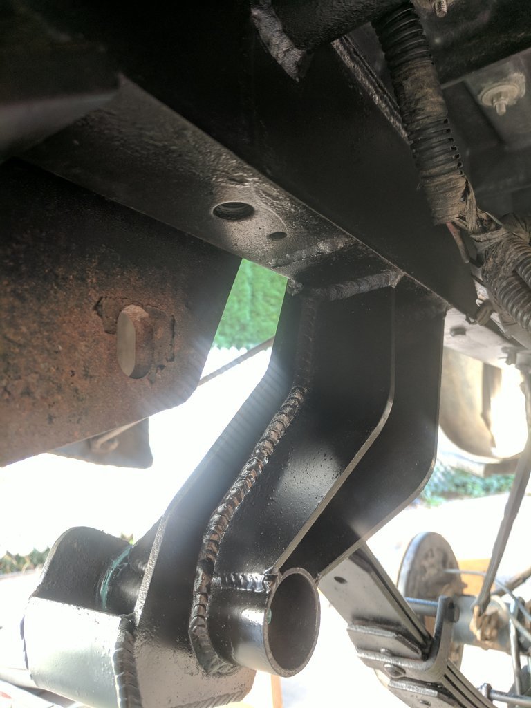

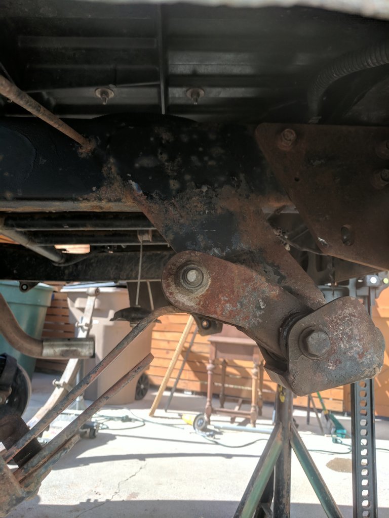

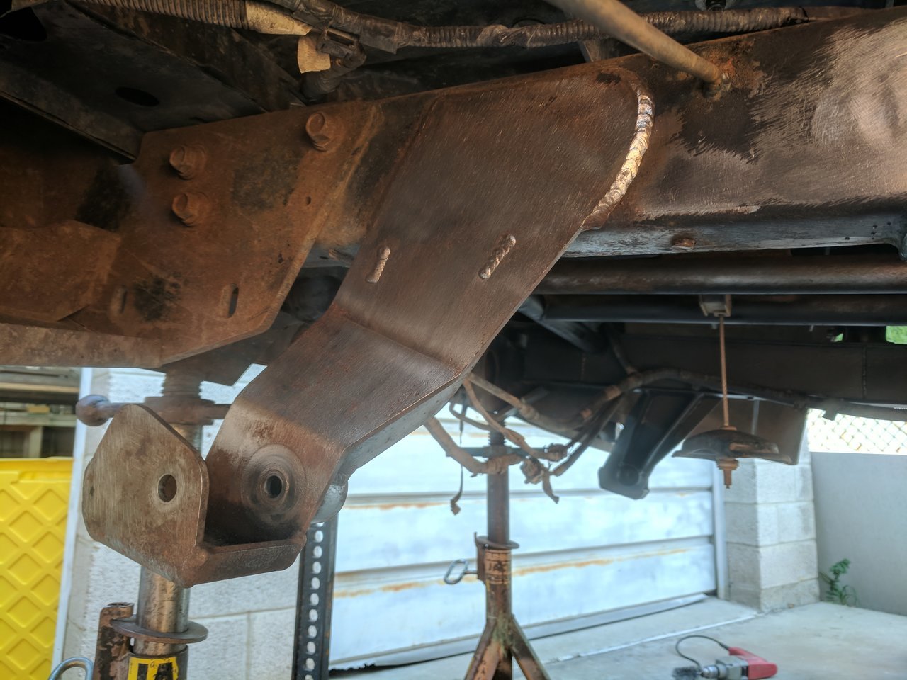

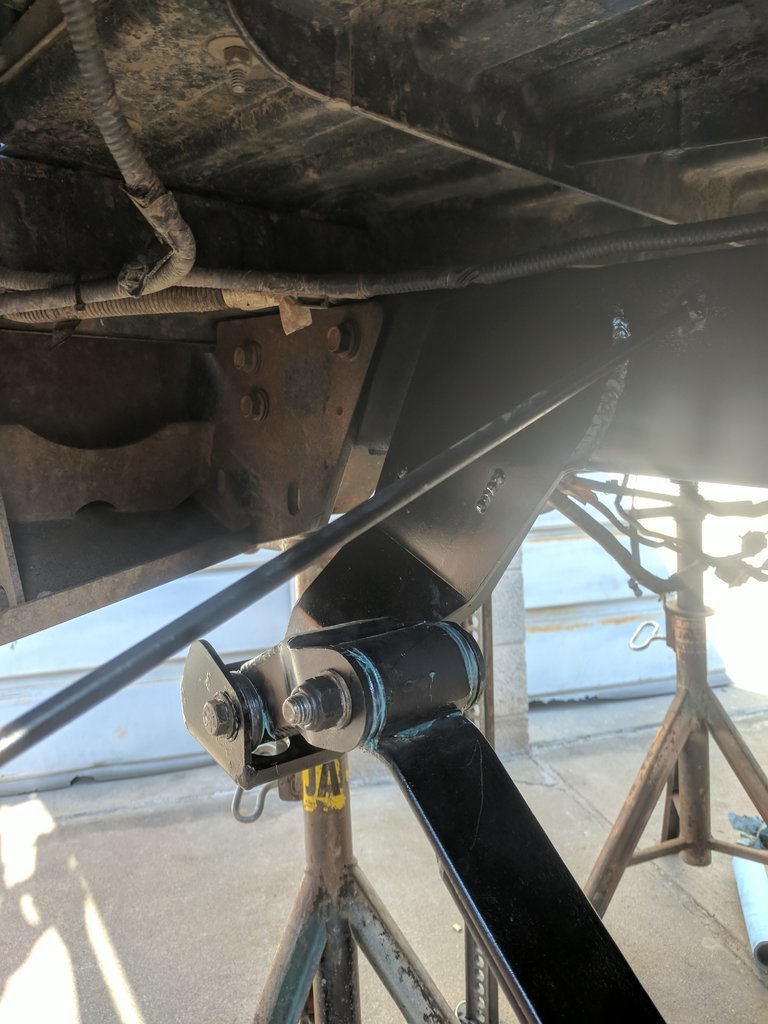

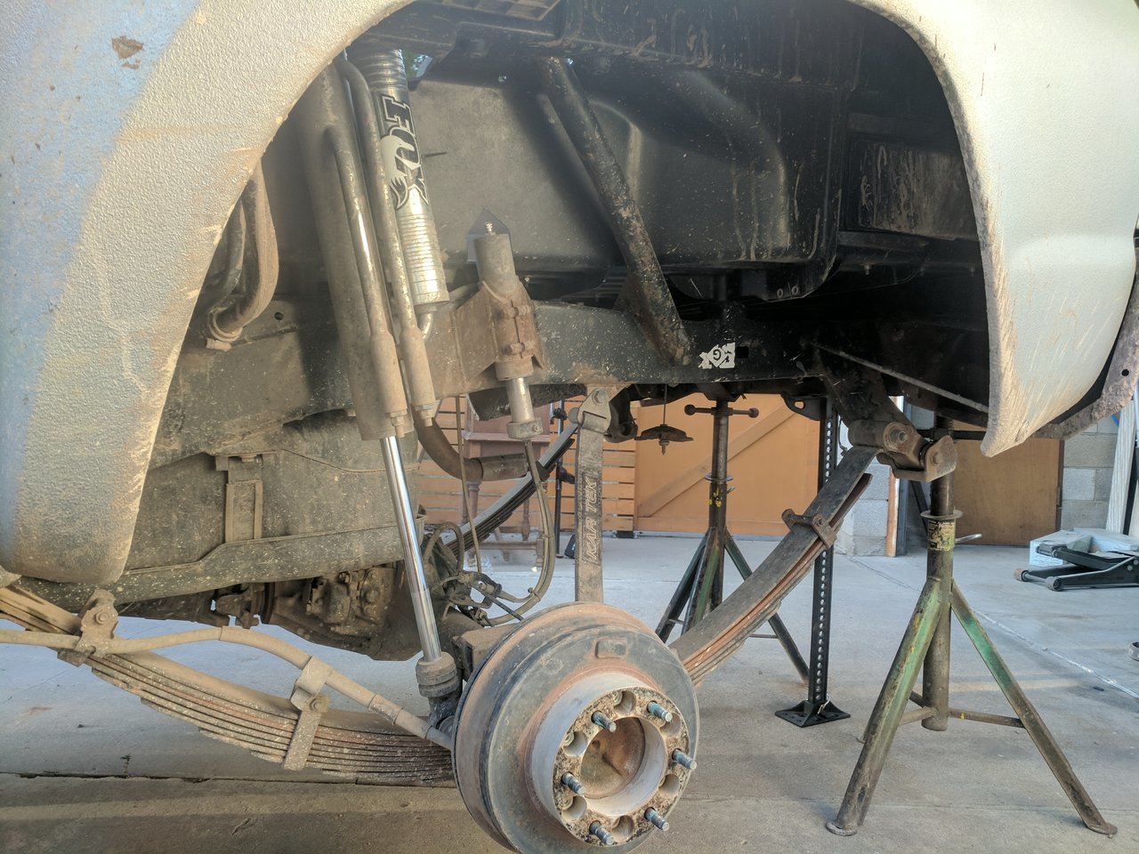

    Its been about 3 years since I had my DMZ SUA installed and I finally wore out the old bushings. I also took the time to wire wheel the frame from the cab back and prime it with Eastwood Rust Encapsulator and then did a Final coat with Eastwood Chassis Saver. I couldn't remove the bed but I did my best with 5 wire wheels.
    Not going to lie, but the project was a huge pita in the 95+ degree temps here in Salt Lake. When the SUA was installed, no one greased the bushings (cmon' Solo Motorsports). I was mainly focusing on the frame since that was starting to get pretty rusty. I greased everything during the install, and now the truck doesn't squeek at all!

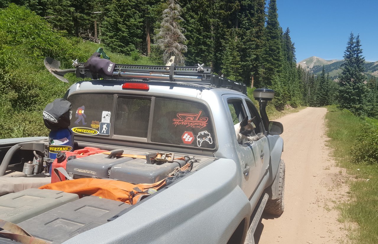

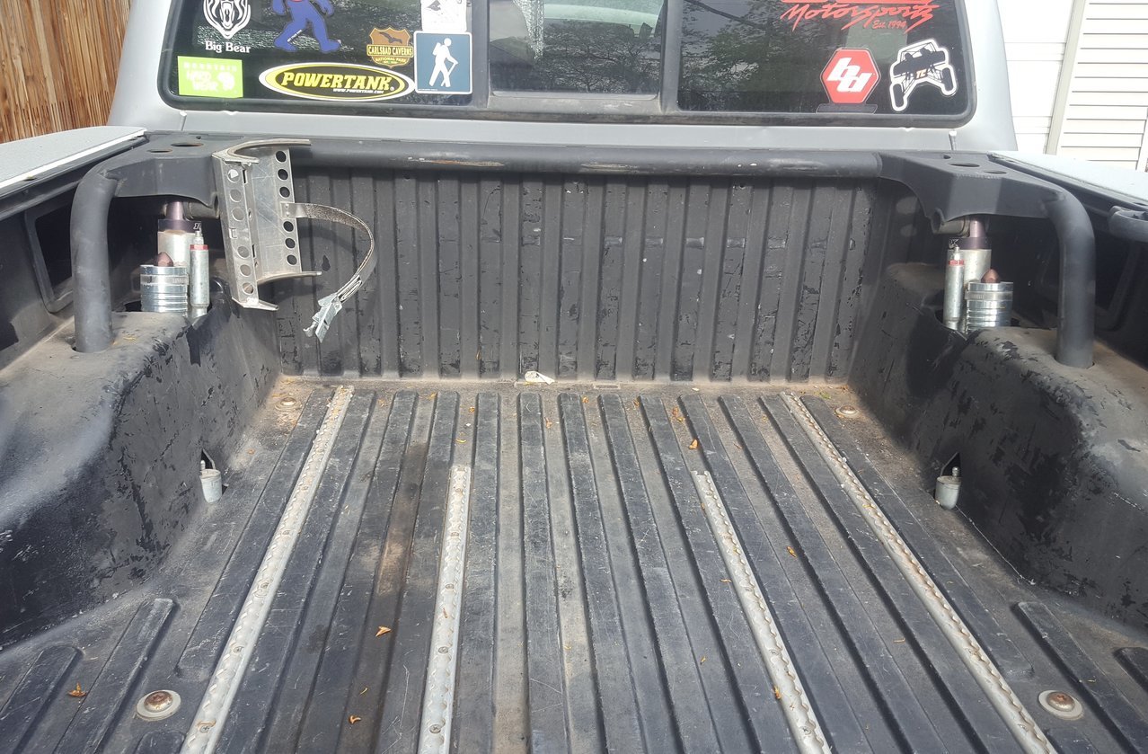

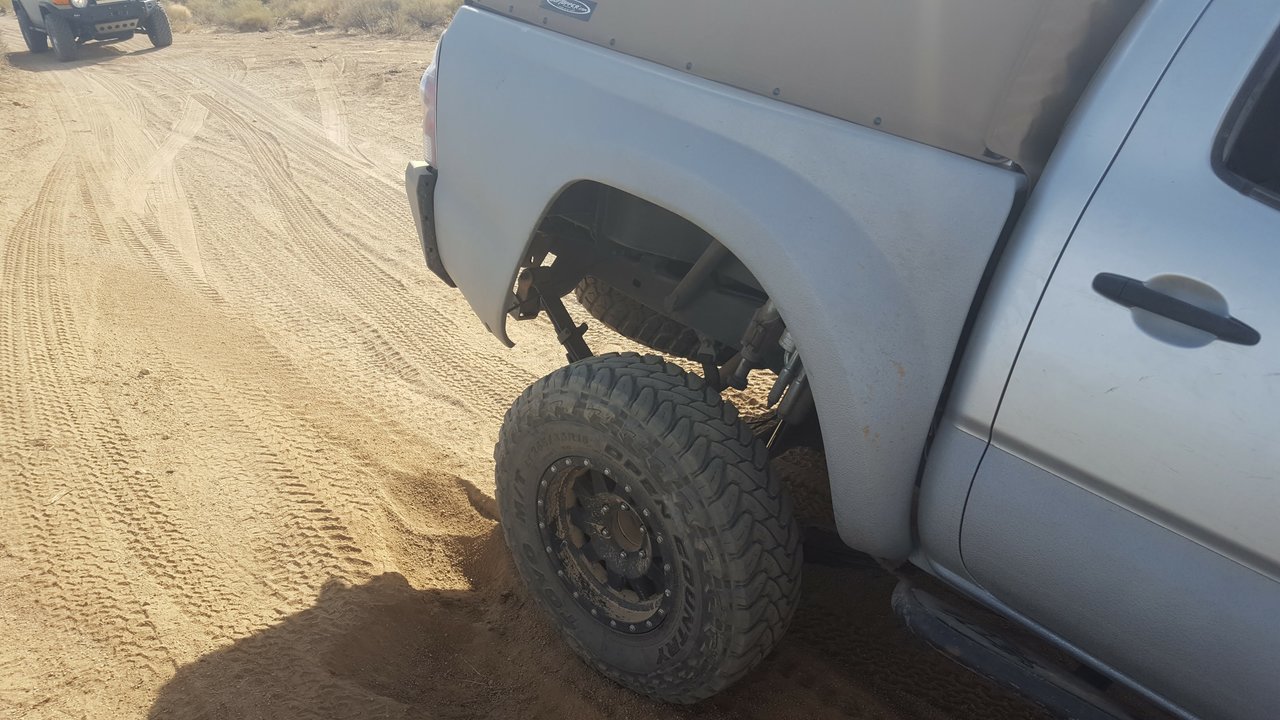

    Here are some pics. We do a lot of camping and wheeling here in Utah. I can't stand trucks with bed cages that take up the whole bed. The frame from the cab back is also boxed. I had Solo motorsports cut out the factory x-member and put a new tube one so I can still fit my 33" spare under the bed.

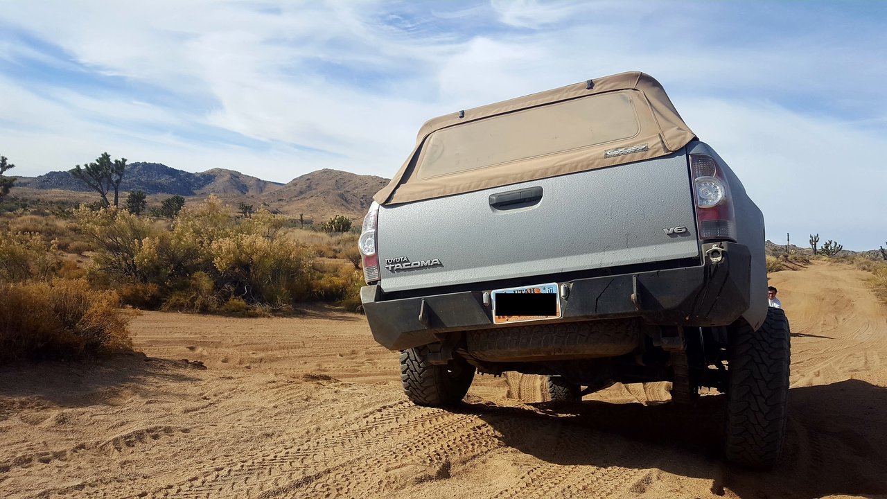

    This is all I have unless I go outside and lower the Tire. In the first pic, you can see the factory tire "winch" and part of the new cross member (right of pic). The second pic shows the tire under the bed. I think the mounting location was shifted back from stock to allow the differential to cycle without hitting it. The tire occasionally touches the ground if I am on a very steep incline transition but it is usually only for a second. I run 255/85/16 tires (Tall and skinny 33's) the spare is also this size . If I am going on a long wheeling trip, I will also throw a ratchet strap under the spare to lock it in place. The stock tire winch occasionally gets loose.

    @concentric_killa where did you get your bushings? What grease did you use? I need to get some for a set of deaver F55's I just bought that need new bushings and hardware. Interested to see if you have any tips!
  9. Nov 13, 2017 at 9:41 PM
    concentric_killa
    concentric_killa [OP] Well-Known Member
    May 26, 2016
    #187951
    844
    2011 4x4 DBL Cab Taco
    +3.5 TC Long Travel DMZ Spring Under Nitro 4:56 Gears Custom Snorkel List Goes On..
    I got the bushings from DMZ. The kit was like $50. Just bushings, no sleeves. The grease I used is called AquaShield. Its a marine grease that I have had from work. I use it on all parts when I put them back together. It hasn't failed me yet. Honestly you could use any good quality grease.

    Are those stock leaf hangers? Or does the DMZ kit replace it?
  13. Nov 17, 2017 at 2:00 AM
    Dalandser
    Dalandser ¡Me Gustan Las Tacos-mas!
    Feb 19, 2015
    #149090
    16,809
    Anthony
    Downey
    08 PreRunner Regular Cab / 98 4x4 Extra Cab
    Empty Wallet Mod
    It replaces everything
