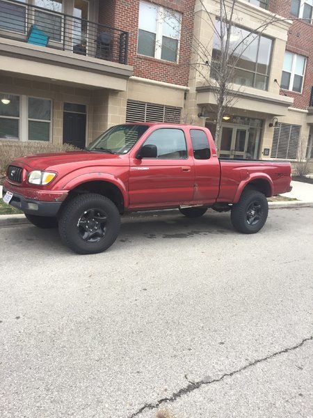

    IMG_4484.jpg Might as well post a pic while I'm at it...

    Turned out really clean. Waiting for the completed project pics..............
