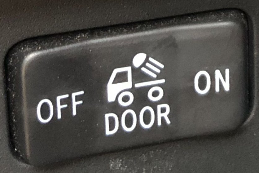

    there isn’t a setting to make them come on when you approach the vehicle, in the same manor the interior lights do.

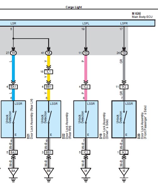

    The UNLOCK DETECTION switch inside the door lock assembly provides the signal to allow the cargo lamp illumination upon smart key proximity or FOB signal...
    Check with your dealer...could be a region/dealer thing.
