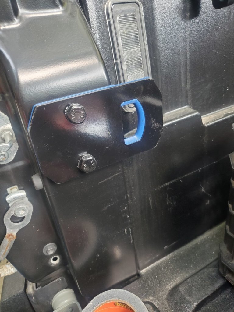

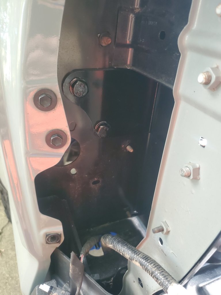

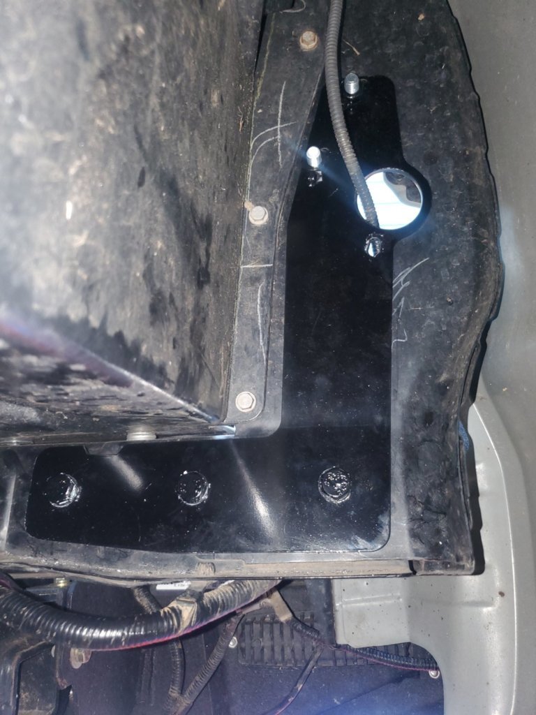

    The issue the bed reinforcements fix is the hard angle of the bed.
    The sharp right angle of the bed wall to the bed floor makes the functionality of the pickup bed physically useful. But to properly distribute the load of the bedside into the lower frame section, a 45 degree triangular piece from the top side of the bedside to the floor would perform the job the best. However this has the adverse side effect of closing off the bed, and it's no longer a pickup.
    Aluminum can work, but aluminum thermally expands differently, as well as fatigues differently. So it's a less than ideal material to add support to a mild steel structure.
    All any of the bed stiffeners are doing is adding parallel lengths of material to distribute the load over a larger surface area, the same fundamentals as how any structural I-beam works.

    The new failure point with any stiffener is the through-bolt mounting locations. But the design of the stiffeners would only allow forces to "exit" the bed space.
    Frankly, if the bolt holes shear on a stiffener, its likely the stiffeners bore the entire weight of the truck during a rollover.

    Great explanation. Thank you. My concern was by not allowing the flex in the bed walls and transferring that would I be kicking the can down the road. By this explanation I feel more confident that this is likely not the case.
    Yes, Sports Chiropractor so I deal with biomechanics a lot. Oh every type of brace has a purpose but also has a consequence as well somewhere else.
    Close...see above. I do use a lot of kinesiology.
    Thanks great explanation. No concern about it becoming to rigid? Some flex is needed no?
