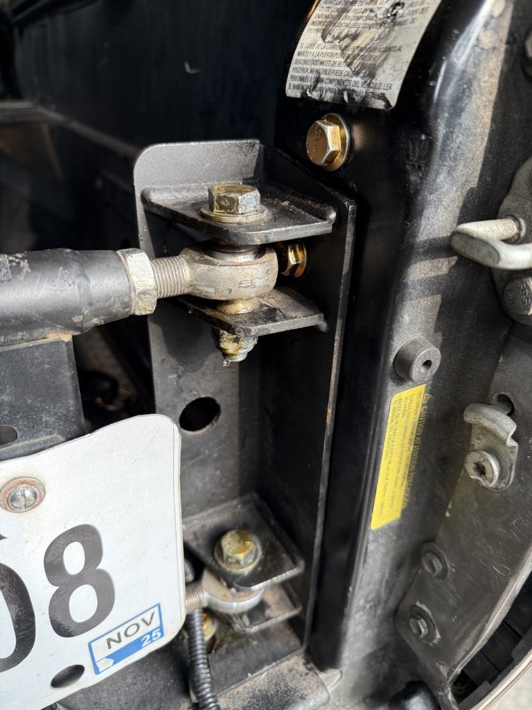

    Step 1 - We'll start with removing the two 10mm bolts that hold your tail light in place. The exterior bracket that's shown there should be ignored.

    Step 5 - With your holes drilled, you will now install your exterior bracket as it will be attached with your internal bracket.

    Step 10 - Once the holes have been drilled out, you can now torque down all of your bolts and enjoy your new mod!

    Just installed these today. Took about 2 hours with plenty of breaks. The last three holes on each side are the hardest part of the whole install. Measurements were easy, instructions very clear, and parts provided were well made. Much better bed stiffies than the other external options out there!
    My only additions to the instructions were using blue loctite and torquing to 44nm. I also used a step bit for all of the holes to give some wiggle room.
