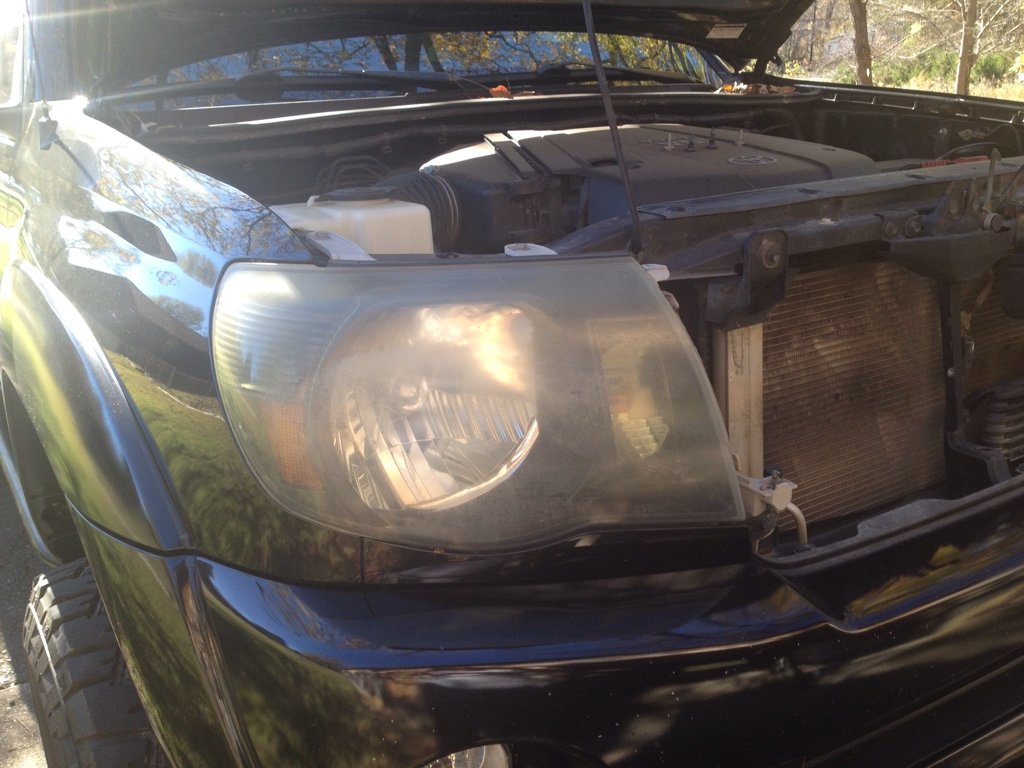

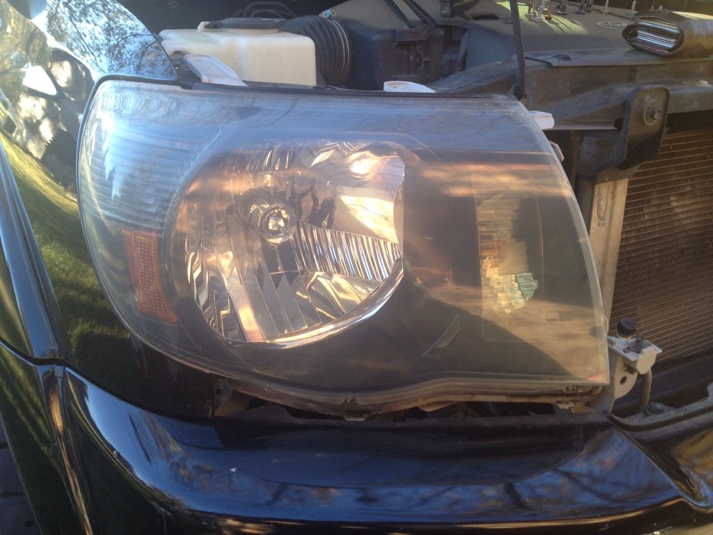

    So I've finally decided to "restore" my headlights. I used sand paper to do it. Went from 800 to 1000 to 1500 to 2000. Then I used rubbing compound and a drill with a mothers headlight ball on it. There's a definite improvement but idk if they could get better. What you guys think? 398d5f1bd7f4dfc2d9bb2cc6f46ed2fb_62994b9726d569516976bc269b276ce9d91da274.jpga4309bfe887279bee1f1b17fbab87586_e373506d5273a23ccac965eb71e49c41204def77.jpg

    You should be able to restore them to crystal clear again. Keep working! An actual buffer helps a lot instead of the drill.

    They're still a bit dull. Keep going!

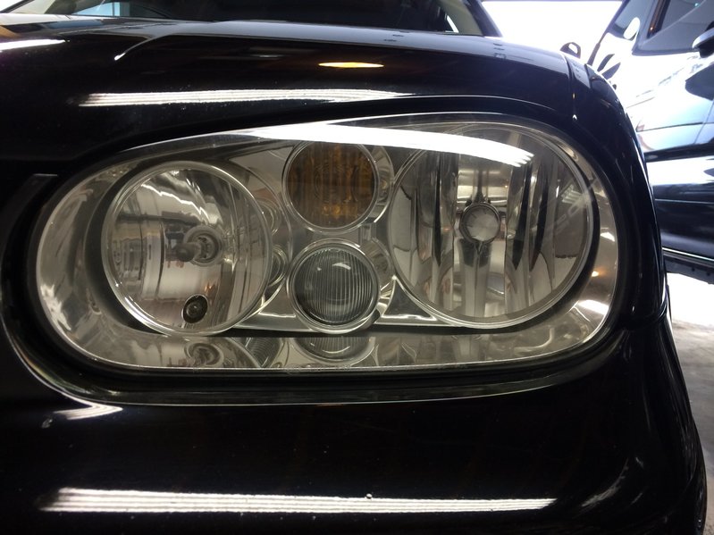

    You can get it back to crystal clear, but it takes some time. I have a 2002 VW GTI and the headlights were awful. I got the meguiars headlight restore kit and used a drill. I did it almost a year ago and they still look great. Below are the before and after.
    Before
    During
    After

    Man if I could get them like that I'd be stoked! I'll keep working at them. PITA!

    It took me several hours to get it right on both headlights but I was very please with the results. Are you using the meguiars kit?

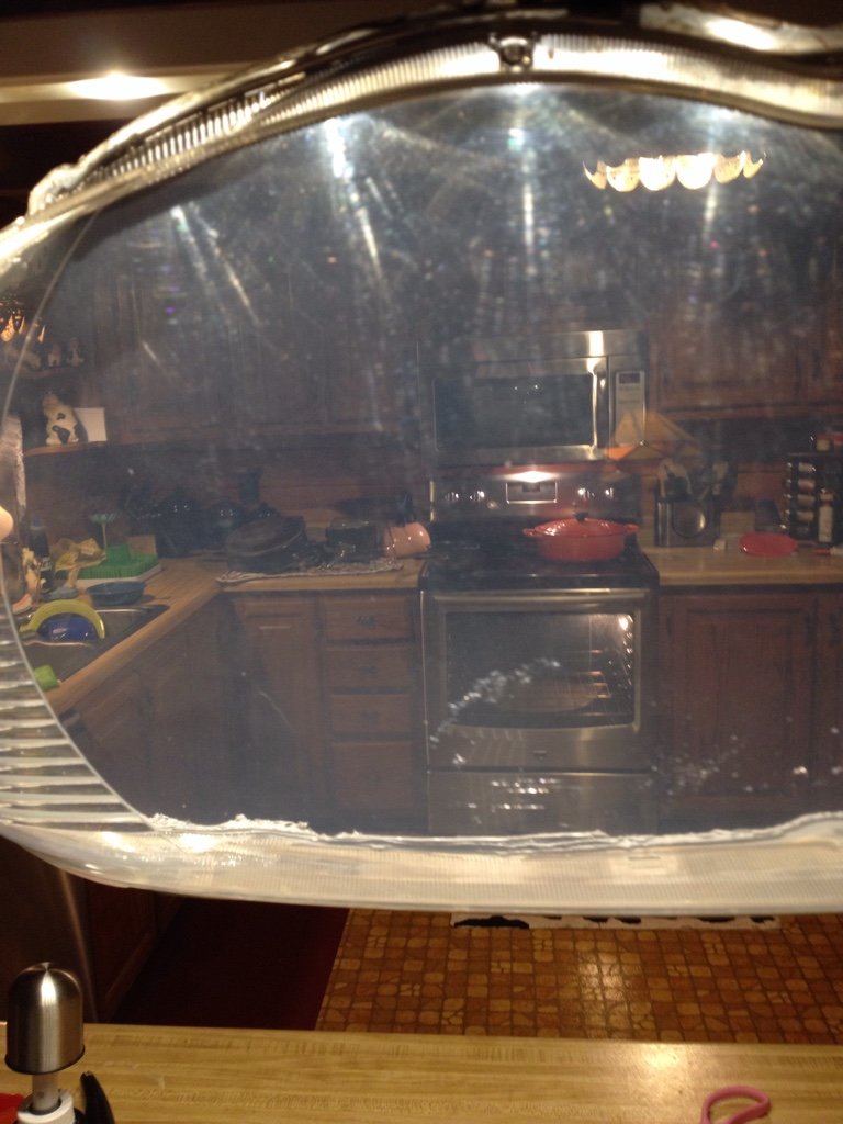

    Well I went and sanded one light for an hour. Working my way up to 2000. Then polished for a while. It looked like there was a haze on the inside so I took the light apart and polished the inside. Idk if I can get much better. 5e25d98f9d69f2d7b7967f1656177a20_6ade30138e7f3c57970fffc4c766e1288846e3e6.jpg

    That's pretty good now you need to use a lens compound. That why I like the mothers. It comes with a a polishing ball for a drill and the compound
