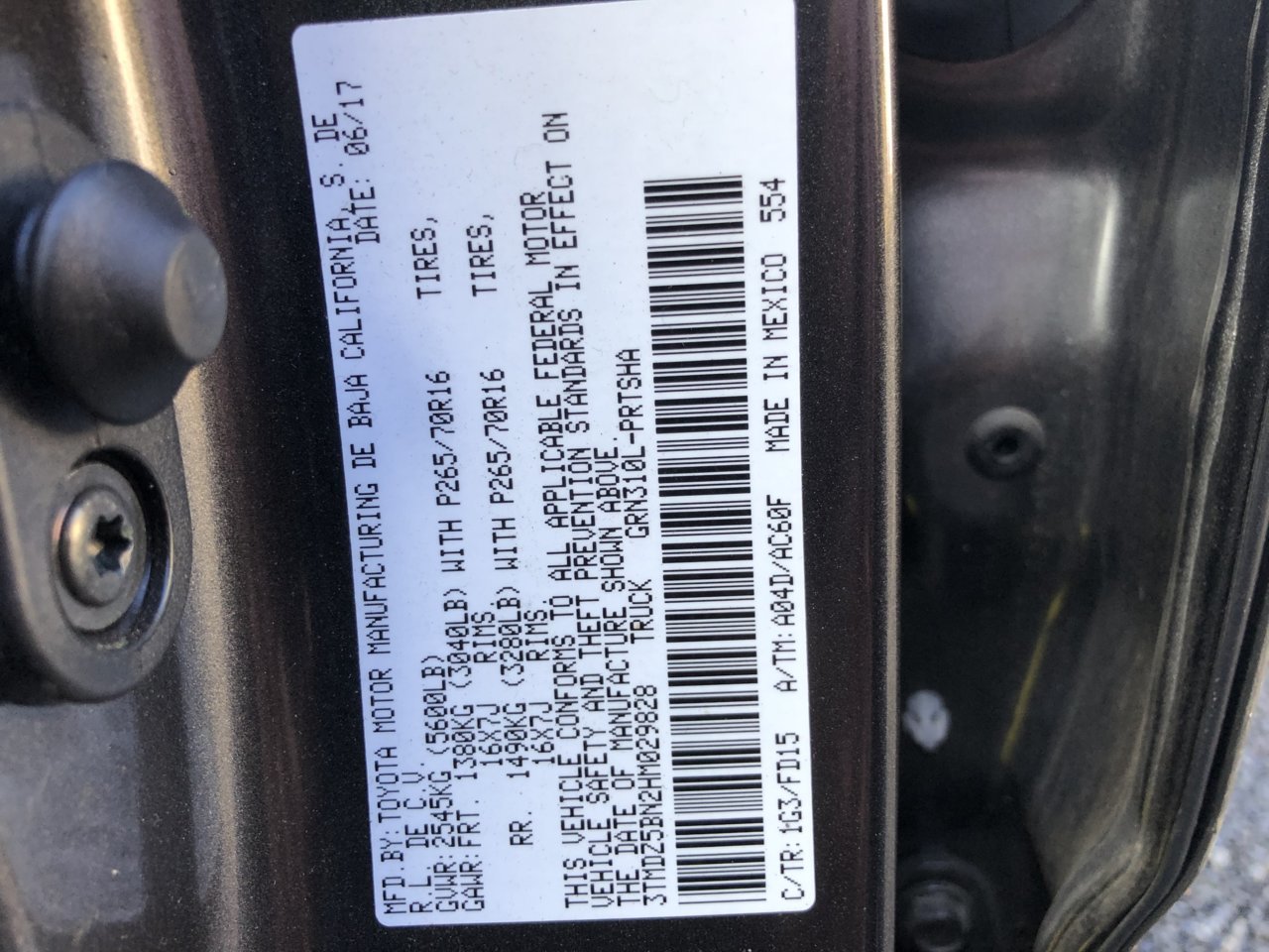

    Here is my door jam sticker. The only thing I can find on this says that the 4 in the code means I have 4.56 gears. Can anyone help me out? I just got 33’s and have been thinking about regearing especially since i will be adding Maybe a front bumper and winch in the future and I already have a tool box. Mostly highway driving with driving on logging roads and trails pretty much every weekend. Anyone have any recommendations for a gear ratio that would work well for my setup? Everything I’m reading points to 4.88.

    is your truck an automatic?

    Autos are 3.90, manuals are 4.30....never heard of any others.

    Whatever the case, you don't have 4.56.
    If you have 33's you're going to have two very good options, 4.88s or 5.29s. The difference between the two is not a huge leap, but they do perform differently. Many say that 33s or higher should go with 5.29 because your 5th and 6th overdrive gears kick in more and keep your mpg at a manageable level.
