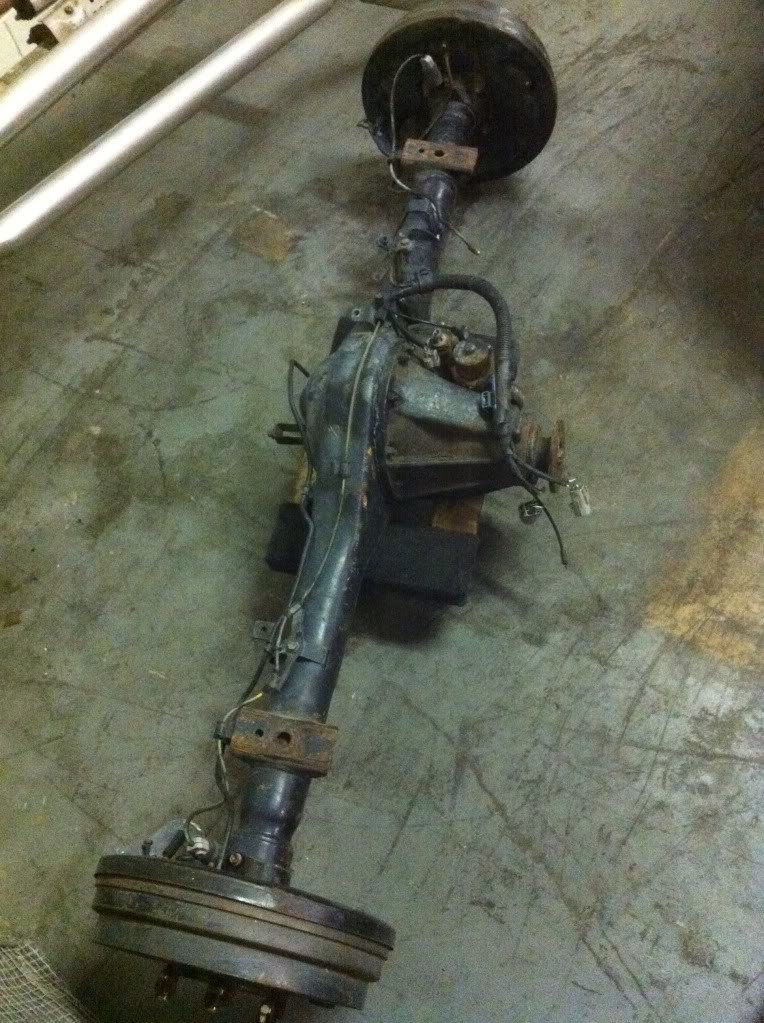

  2. Mar 28, 2011 at 1:19 PM
    Unknown
    Unknown He who angers you conquers you
    Apr 18, 2010
    #35554
    8,133
    Brian

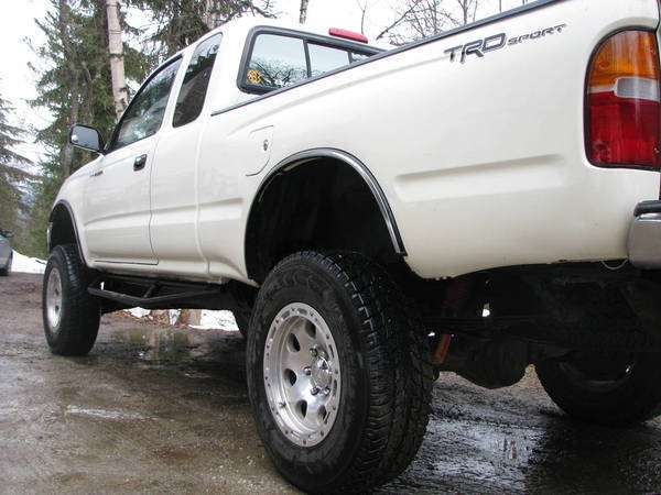

    You have to watch the stickers...a lot of trucks have TRD stickers and aren't TRD's. In your case they didn't come out with the TRD Sports until 2nd gen's if IIRC.

    I have the exact same truck as you. 1996 TRD. Check thumbnails you can definately see the locker on the diff. On 2nd pic you can see where the line goes up.
    In my cab I cannot find the diff lock button for the life of me. Instead I have a "no clutch start button" in the position of rr diff lock in the 2nd post picture.
    I wonder if it is because we have Canadian Tacoma's there was a slight difference with some of the design???

    ^^This^^
    The locker would be on the front of the diff, not the rear. You do not have a TRD

    See that thing on the left side of the third member, that's the e-locker.

    YES!! You saved me extensive googling/crawling under my truck to take a picture. That's what you're looking for.

    Since Ben is too lazy to circle it (its because hes a mod now..:D)
    The ugly blue circle narrows it down for ya'll
