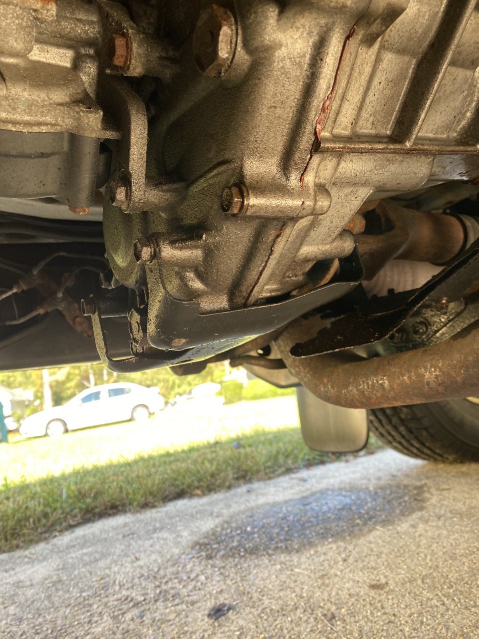

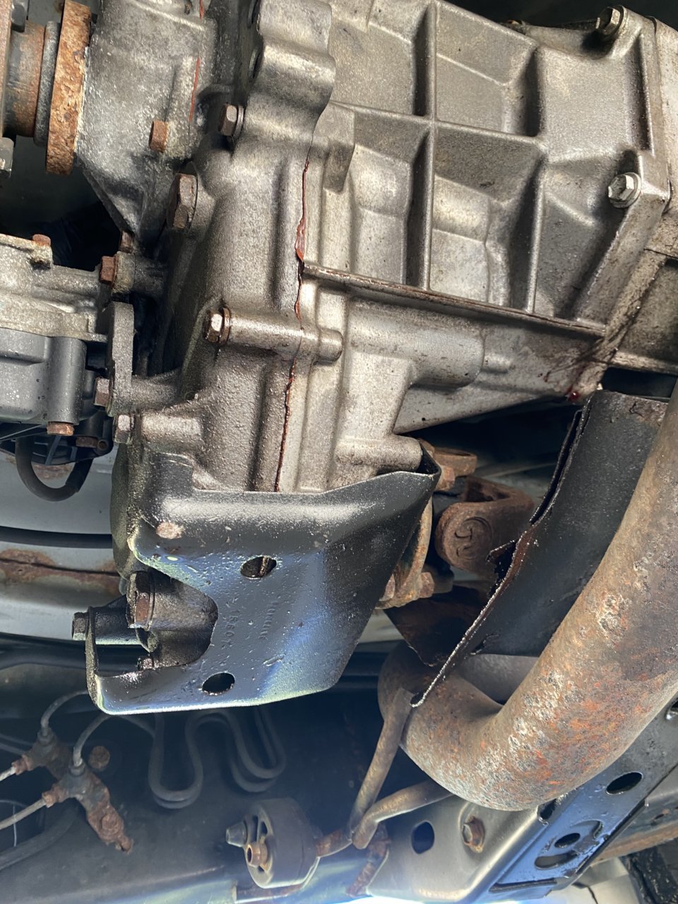

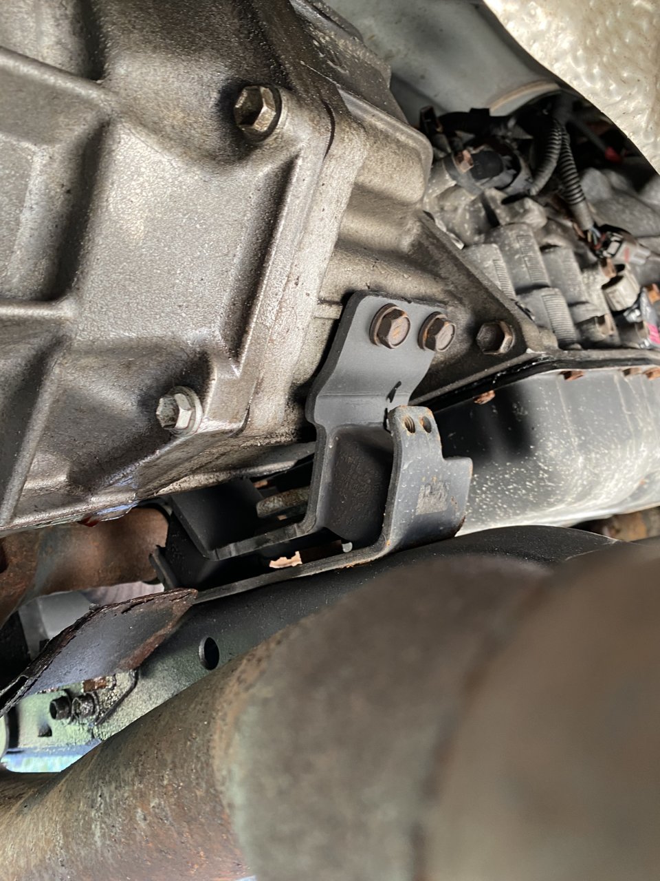

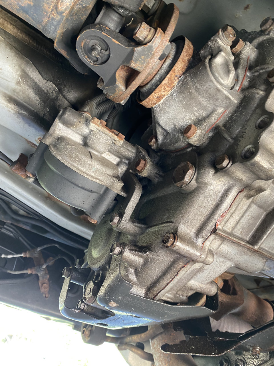

    I have a Toyota Tacoma 2007 that I believe has a transmission leak I am going to upload pictures. Can you all tell me what’s wrong and how to fix it would be greatly appreciated!!
    I want to keep this truck in good condition and fix as soon as possible thanks

    Your positive it is ATF and not engine oil ?
    How many quarts of transmission Fluid do you need to add every day??
    First step would be to wash everything off and figure out where it is coming from.
    then you would have a better idea.

    Place a pan with a white paper towel under the "leak".
    The color of the fluid should give a clue to its origin.
    Another technique is to clean and dry the area. Then puff some powder in the area. Any powder will work, flour, corn starch, talcum. The fluid will make a track in the powder leading to the location.

    Does your truck have trans cooler hard lines up against the tranny on one side? I developed a pinhole leak from corrosion in one of mine there and it eventually started slipping and banging shifts. The leak was only visible whilst the engine was running and once the fluid got on other stuff it did make it more confusing as to where it might be coming from. Have at look at yours and see if it makes sense that the fluid could be coming down from these lines. I curse the fact that Toyota did not give us tranny dipsticks else I would have caught this problem sooner.
    Here is my thread on this... ignore the first 34 posts... that was just speculation about possible electronic causes until I discovered the leak... shown in post #35. Pic of new part installed in post #42.
    2009 V6 auto - first real problem - trans | Page 2 | Tacoma World
