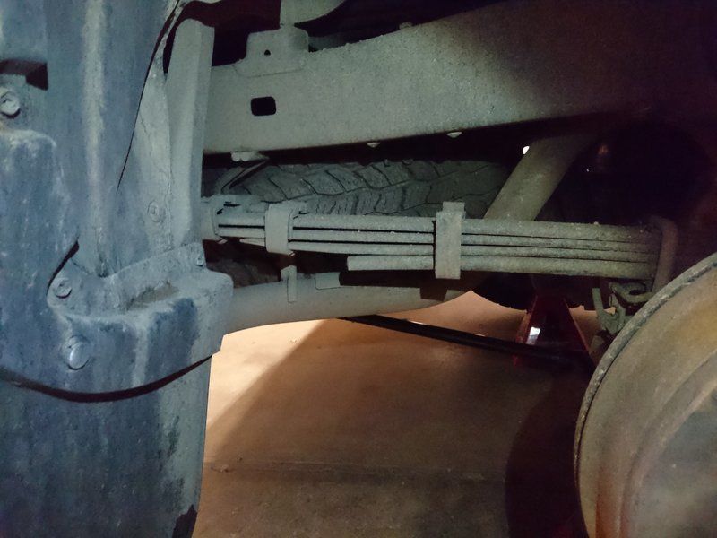

    I don't recall what exactly I was looking for but, when looking, happened to notice "inverted" leafs - what others are referring to as negative arc. I thought something was wrong and when I took my truck in for its next service, asked about what I thought was a problem. They had it on a lift and the service manager took me out to look and mentioned that that is how they're manufactured. Sure as sh**, one mounting point was higher than the other, giving it the inverted fit.
    To this day, I still don't understand what the reason is behind it. I don't recall ever seeing this configuration on any vehicle I've owned. For the time being I'm going to run it until they need to be replaced and then I'll change them out.

    What's not to understand? It's called cutting corners, whether it's cheep steel, poorly tempering the steel, putting SUV grade leafs on a truck or all of the above, it's that way with many components. As for the Service Mg. telling you "that's how they're manufactured" as if it's right, that was just a song and dance to get you to move along.

    It being right or wrong is irrelevant. I saw with my own eyes that that IS how it's manufactured. Now, WHY it is manufactured that way is as a result of cutting corners - I don't know.

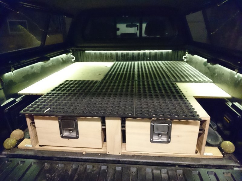

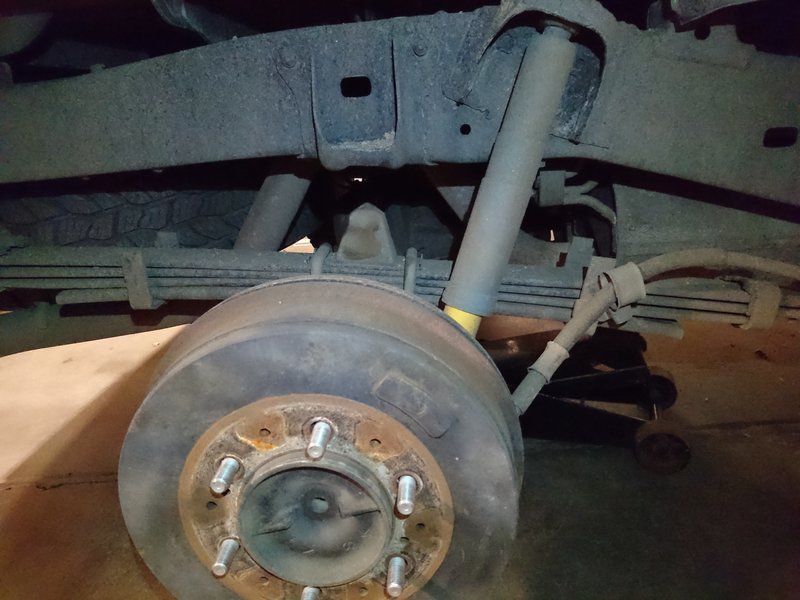

    Well, I'm glad I searched before either posting anything or buying anything. I had a squeak in my right rear and I noticed the flatness/inversion when I took off the wheel to investigate. I was worried that with my Leer topper and the drawer system I built that I had too much weight on there. I still might buy something like sumosprings or bumper stops since I noticed, also today, that when towing my pop up she leans pretty froggy.

    Wouldn't a flat or 'inverted' leaf spring theoretically give you more droop?
