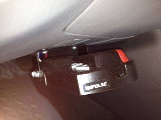

  14. Jun 25, 2012 at 5:28 AM
    J Gibson
    J Gibson Well-Known Member
    May 3, 2012
    #78108
    509
    J
    Knoxville, TN
    '12 DCSB,4wd,TRD Sport, tow pkg, MGM
    katzkin leather, toyota step bars, pro grill, advent overhead DVD player, cargo extender, bed mat, husky liners, impulse digital brake controller, avs bugflector, tinted windows, Firestone ride-rite air bags, ARE camper top with tool doors, ScangaugeII, ProEFX tow mirrors, ImMrYo rearview mirror lift bracket, Salex glove box and console organizers, 2020 Tacoma Pro styled wheels, 265/70 r17 Michelin MS2 tires, LED map lights, drivers seat extended and raised, ram ball tech deck installed, blacked out badges, tinted taillights, upgraded climate control knobs, ultimate headlight upgrade with Osram superbrights and wiring harness along wit OEM pro headlight housings.
    YES!! I have an Impulse digital controller and love it. It can be mounted anywhere (with in wires length of wiring under dash). Does not have to be mounted level. Has an easy to adjust digital read out. If you have the factory tow package you can get a plug and play harness for it that allows you to plug it right up to your truck with no splicing wires etc.
