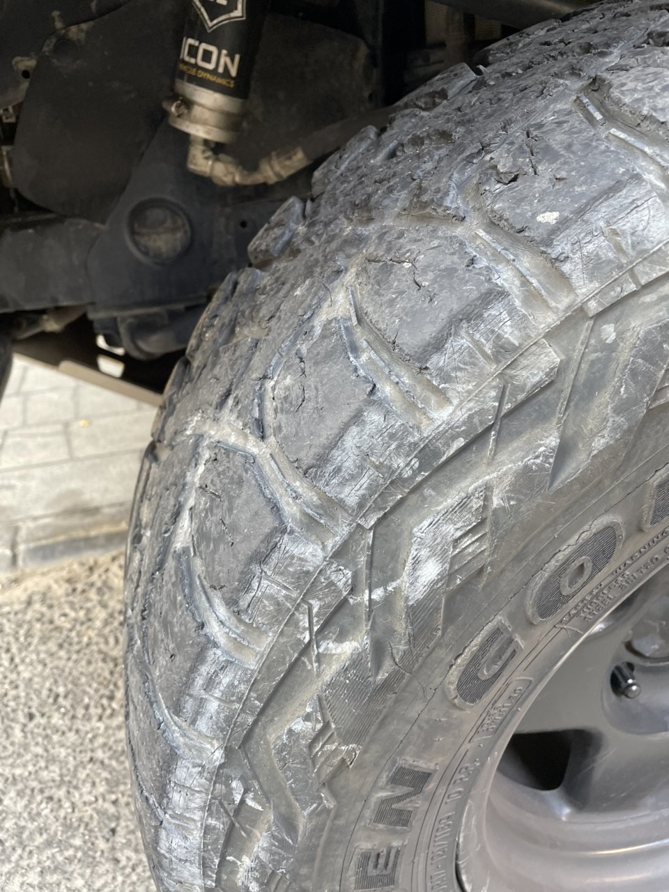

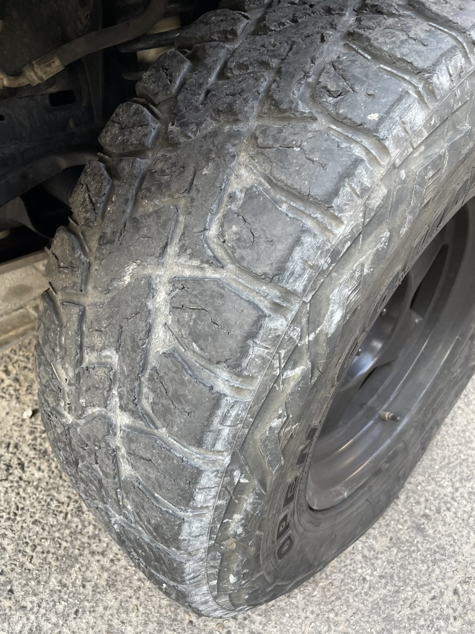

    If not, how much longer do you think I have on them? Thanks
    toyo open country RT.

    Uhh yes

    Buy a tread-depth tool at Autozone, about $3.50. Then Google “safe tire tread depth”. Compare your depth to the charts on Google. Or just say screw-it and go buy a set.

    It is time

    Fuck. Ok switching to KO2s.

    Looks like your inner tread has more than your outside tread in the pic. Alignment and new tires. My 2 cents.

    This!
    Those look like shit!

    You have at least 10K more miles left on those bad boys.
    Run them until they are bald.

    You got your moneys worth!
    I dont run all terrains past 6/32nd, those look beat up to hell and back.

    Not a problem....cords ain't even showing.

    "Like new tires for sale. Plenty of tread left! :burnrubber:"
    Lol yes, looks like it's time to make a swap, OP.

    Legally, in Michigan, your tires are illegal below 2/32nds of tread. You really don't want to go below about 5 or 6 for winter. But given that you're in Texas I suppose it just depends on what type of driving you're doing. If it is just on road you probably don't have to be in a big hurry but if you're off roading you're only hurting yourself.

    I think (hope) this is the law everywhere in the US. And, I totally agree that 2/32" is nowhere near enough to be safe in winter!

    Those aren't safe in Houston either.
    A simple rain storm will make the roads like covered in ice.
    Plus......the speeds and short space between vehicles makes for a bad situation on dry roads with good rubber.
