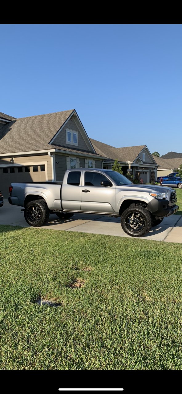

    upload_2019-5-26_21-56-55.jpg!

    The only reason to regear is if you don’t like how it drives with that diameter tire. So if you are happy, don’t waste money on regearing.
    But 33” tires will absolutely rub, you just haven’t used the full articulation yet that’s all, but with the size you picked, you obviously don’t intend to go off-road, so you may never feel it rub, unless you hit an entrance ram at just the right angle / speed

    Oh that makes sense yea see it’s not an off road truck at all it’s actually a paint truck going from house to house so if does a lot of driving and so it won’t blow my tranny if I ride like this forever also do you think theyd cover any issues with Toyota’s new lifetime power train warranty which I’m told have
