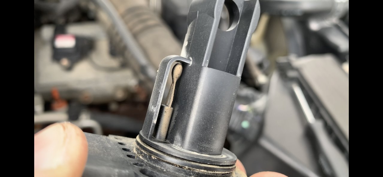

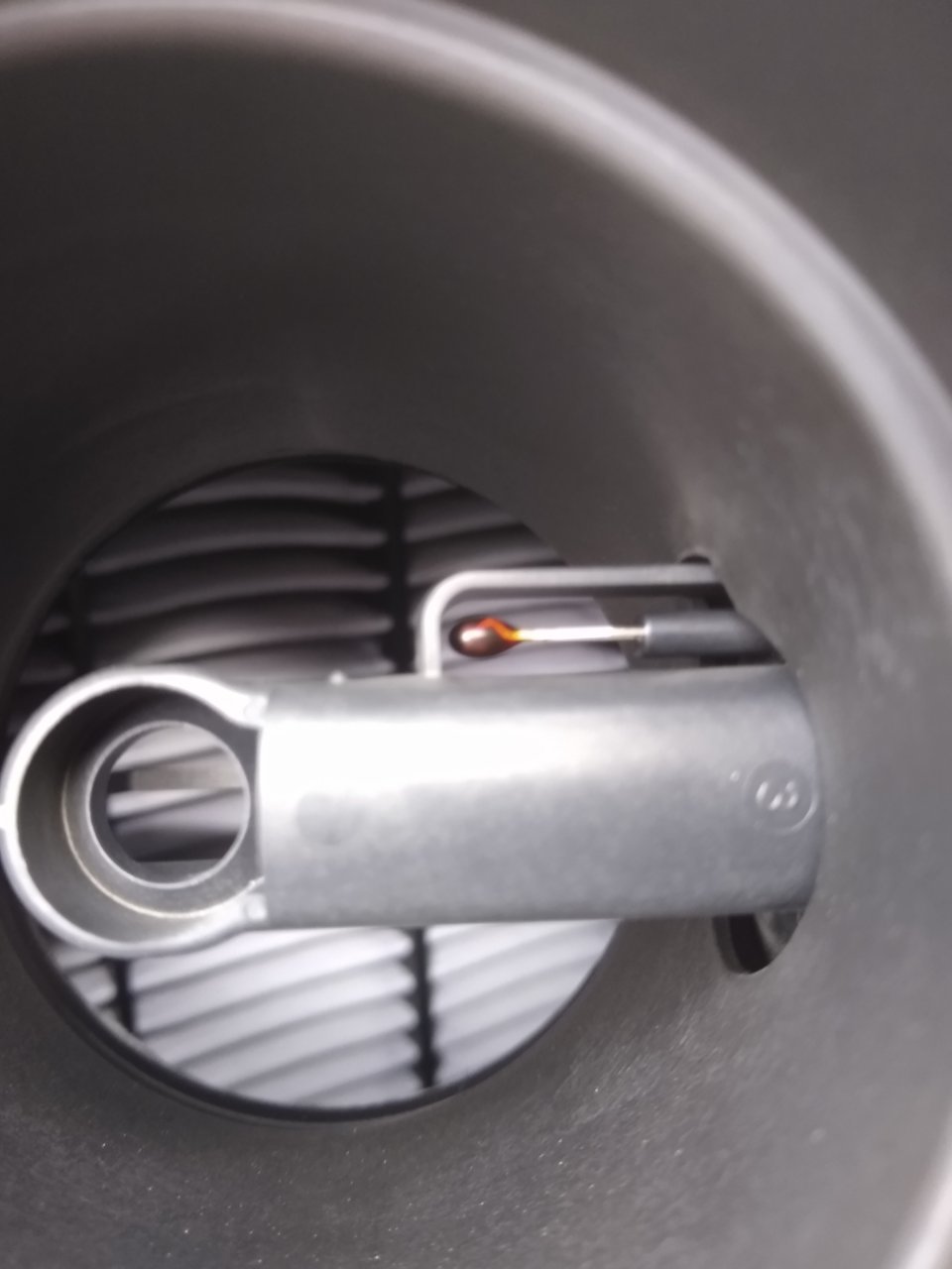

    Hi guys, today I did the deckplate mod.
    When I removed the mass Airflow Sensor, I noticed the tip looks brown/burnt. Is that normal?

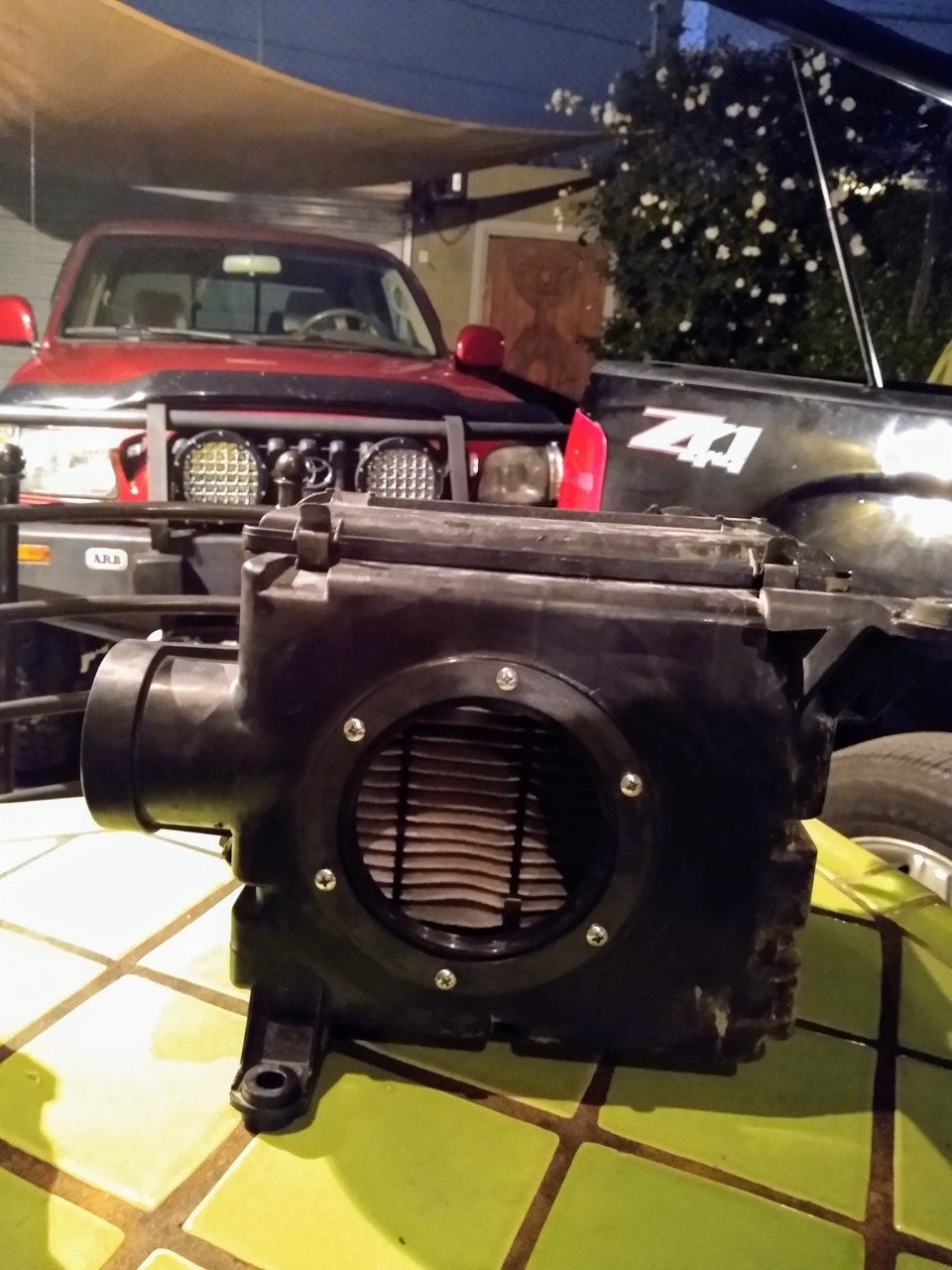

    Pictures below + bonus pic of the deckplate.

    #197244
    6,244
    Planet: EARTH
    Normal

    Super Springs
    Is it causing any Codes to trip??
    If not most likely it is fine.

    2020 Tundra GFC 33’s Borla Pro XS FOX 2.0 2020 F150 33’s Magnaflow FOX 2.0 2001 Tacoma 4x4 2.7 5spd access cab new frame 217k 2” lifted Always for sale.
    Thats the cleanest MAF ever.
    Is it new??!
    usually there will be a crud buildup on the tip and the shaft down— like this:
    ...then use the maf cleaner to make it look like the one you have above. Check regularly

    Toytec coilovers. Height adjustable Bilstein's. 265/75/16 MT. TRD wheels. Rebuilt r150f. Marlin clutch kit. All kinds of new parts...
    If you have a hot air intake it will look like that ;)

    King's, Camburg UCA, Dirt King LCA, armor
    There are also “wires” in the MAF sensor, at the bottom of vertical tube that should be cleaned.

    TIM
    The thing with the dark brown bulb isn't what you need to clean. It's actually the wires pictured in post #7 that sense the amount of air coming into your intake.
