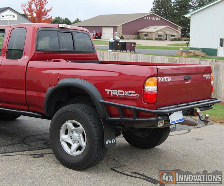

    Are you looking to protect the rear quarter-panel of the cab like this:
    Or of the bed more like this? (I know you're not looking for the full bumper)

    Yes, but ima keep my stock rear bumper i just want the wrap around part at the rear quarter panel by the end of the fender flare
  10. Aug 30, 2020 at 7:18 PM
    MuddySquirrel
    MuddySquirrel Well-Known Member
    Feb 19, 2016
    #178710
    206
    Will
    Phoenix
    2015 Taco 6-speed Off-Road
    Copy. I'm not aware of any that don't include the rear bumper; the engineering on that would be difficult due to the applied torque. Hopefully one of the other 1st gen folks knows of something or you can go custom. Good luck!
