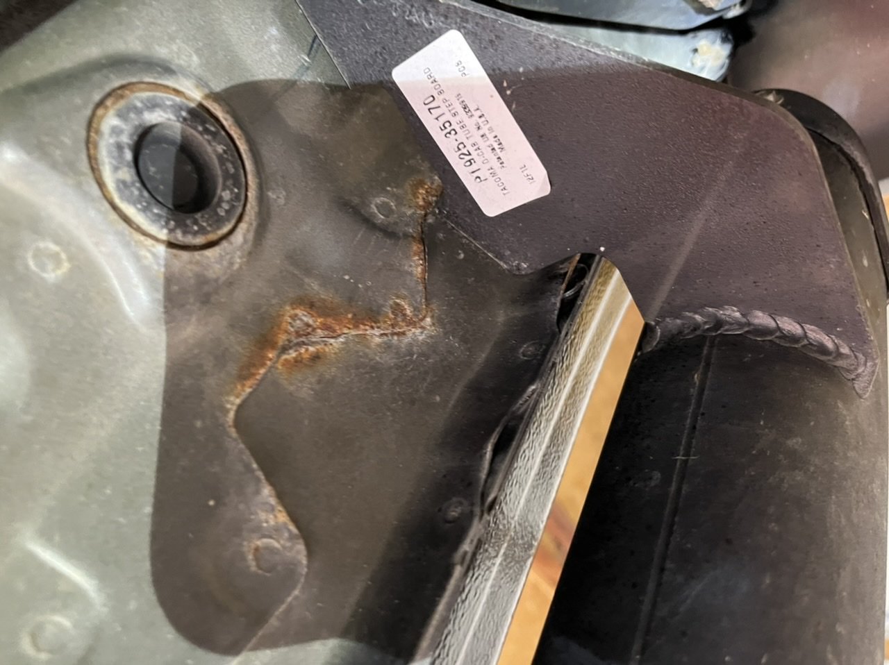

    I live in Great Lakes so a lot of salt in winter months on roads. Rust is a major issue here. I just had my 2018 done and there is rust in a few parts but not bad. Where you live I probably wouldn’t but here a 10 yr old truck can be destroyed by salt. Drives me crazy we can’t find a better option. This is concerning as in my door jamb above this the paint is bubbled up and showing rust in a truck with 29,000 miles on it 0E990614-3633-450F-B000-B8CBCD23E36F.jpg

    But that was the worst spot so we did every nook and crannie with fluid film so will see how it holds up. I assume the seal is bad in jam. Or this is where it’s getting in. It’s right at plastic piece in jam where your feet go basically and this seam is under that so gotta think it’s getting in there. Rest if truck is super clean so that’s why I had it done as I’ve never done a vehicle before.

    pull all of the plugs in the bottom of the rocker. HOSE the corrosion inhibitor in a 360 pattern all the way around each hole. then spray in the rocker from the bottom in every tiny opening, and all a long the pinch weld. this is where water gets in, and stays. water gets in, it freezes, and expands the metal joints. yes, it happens. these areas are multiple thickness of metal, spot welded together. even with weld through primer, and then paint, the rust has already started from the manufacturing process. if you dont believe me, take two pieces of bare metal, weld them together, and let it sit for 8-12 hours unprotected... corrosion will have started from the weld heat. think about that when shift workers are building cars. Ski

    I hear you. I’m a welder and have been for 23 years now. so I know exactly what is gonna happen. That’s why I’m so bothered by the issue. I know it’s only gonna get worse. Was a chance this was gonna be my last truck but now will have to sell it and get another some day before I retire probably. Dealership said they would “fix” it for $616 bucks but I assume that was to just repaint the spot not fix the actual issue and so will only comeback imo. I don’t see them actually fixing the cause just the result. That’s been my only complaint with my Gen 3. My gen 1 is a 02’ and is finally rusting out. Besides the frame but they replaced that

    I would bet if you pulled the plugs in the rocker, and sprayed heavily in there, then sprayed heavily up in the pinchweld edge, voids, and coated that area that has started, you could keep that rust in check pretty well.
    Regarding the inside the jamb thing, I believe is caused from dirt, sand, grit getting between the weatherstrip, and the inside rocker area, then the opening closing of the door and driving vibrations, cause a sandpaper like action. you can remove the scuff plate, and weatherstrips, clean it up, and coat the rocker from that side as well. Ski
