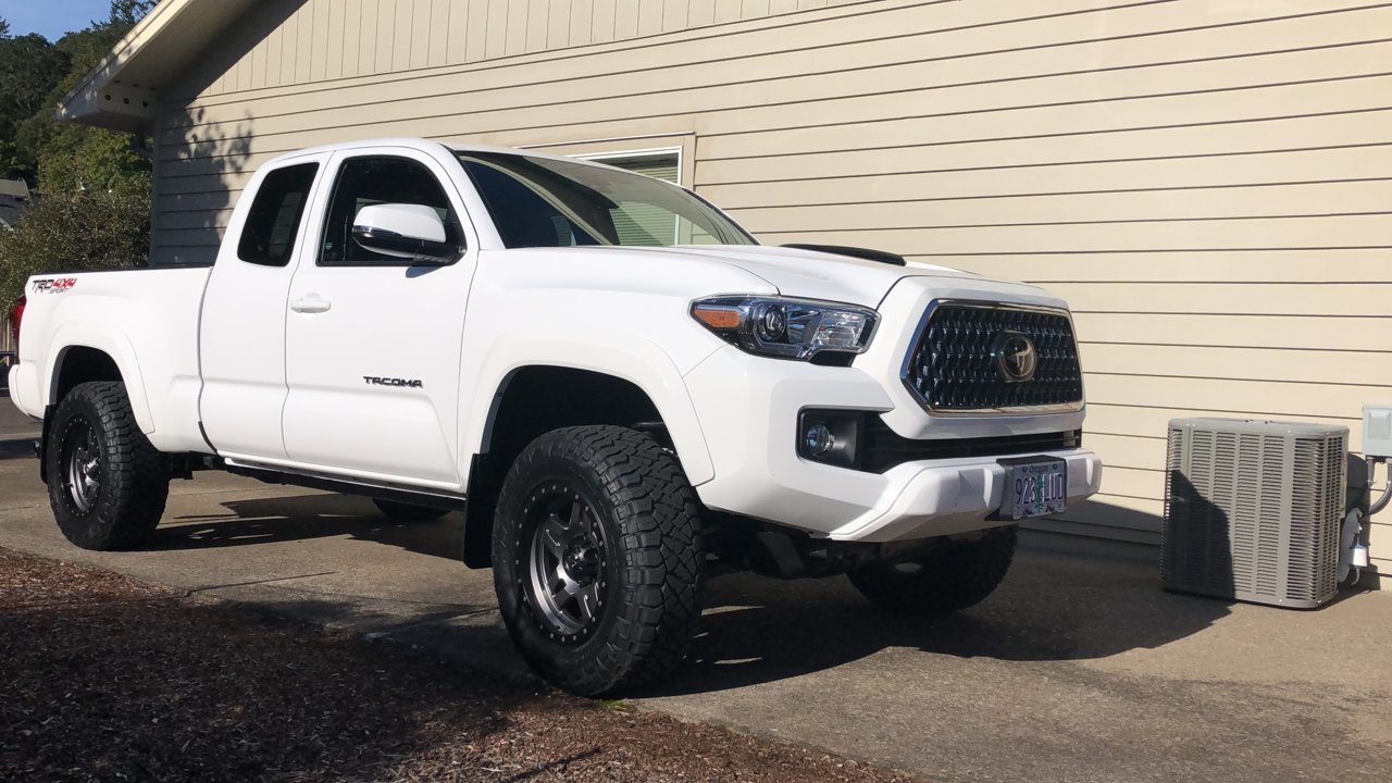

    Traction in sand has been great and now the mud and snow are coming to Oregon, our Touareg has all wheel lock in a straight line and open when turning but in off road selection it locks the transfer case in and its all locked. Do the new Tacomas lock the axles in low range. If not what lockers do you guys recomend.59D6A04F-EDD9-49C0-B0DF-B92447F30936.jpg

    Negative. TRD Off-roads and TRD Pro's feature a rear axle differential lock only. Available only in 4lo.

    Tacoma does not have a center differential, meaning the front and rear axle differentials receive the same driveshaft revolutions when in 4 wheel drive.
    Your VW Toureg does have a center differential, that can be locked making it behave like your Tacoma's 4 wheel drive system.
    Those vehicles are often referred to as all wheel drive or full time 4wd.

    And I assume you know this, but in 4Hi and 4Lo, the Tacoma transfer is (by definition) locked. Your Touareg has a center differential which is normally open in AWD mode, but can be locked as you describe.

    You can add aftermarket front lockers. But a lot of people recommend not locking CVs you can do it and a lot of people on this forum will tell you they have done and it is flawless but you have a higher chance of breaking with CV’s

    I’ve got an off-road, and honestly i haven’t hit a situation where i needed the rear diff locked that a-trac didn’t do just as well.
    maybe if you’re doing axle twisters, or need the wheels to spin...
    I’d imagine the traction control system
    Is even more impressive with the automatics, given the crawl control tech

    I believe TRACs is disabled in Crawl mode (for sure it is with diff locked). TRACs works well in Subaru and Volvo. I cannot wrap my mind around TRACs and drum brakes.

    The truck only has one true "locker" and that's for the rear. I believe when the rear is locked, the front uses brake limited slip (aka A-TRAC, MTS, and Crawl Control), and when the rear is unlocked all four wheels use the brake limited slip. The limited slip system is quite good... much more clamping power than a standard traction control system, so you can use it to wheel up steep hills and through ruts.
