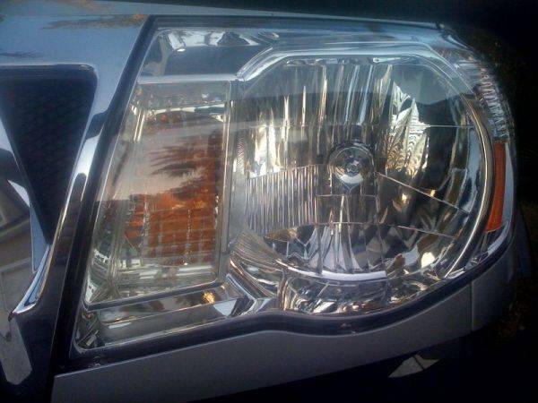

    Mine were bubbling up and the clear coat was starting to peel and on top of it all they were starting to fog up. I got them replaced under warranty today. I'm glad I didn't do any mods to headlights.
    New ones:
