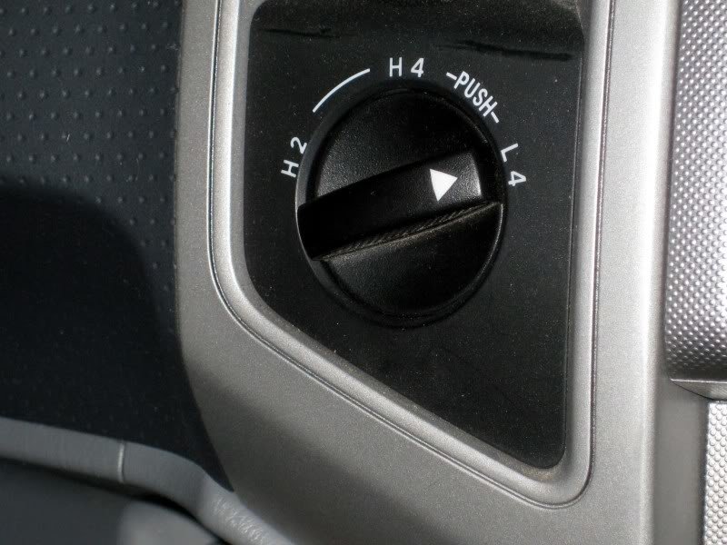

    After reading a few post on here where people were experiencing problems getting into 4L I decided to check mine out again seeing as how I use 4H but hardly ever 4L. So I tried it yesterday and lo and be hold I can't get into 4L with out first being in 4H. When I first got the truck I could go right into 4L without any problems. Is this normal. And yes I am doing it correctly, to get into 4H I slow down to 5mph or less and just turn the knob, that works fine no problems. Now after being in 4H I stop and shift into Neutral then press and turn the knob and bam that works too. What I can't do is go from 2wd to 4L without first getting into 4H.

    No you can't...
    You can't physically go directly into 4lo without passing through 4hi first (on the knob).

    Thank you for your response. I was starting to think I was nuts, I must have been mistaken and just thought I used to go directly to 4L without first engaging 4H. Lately I have been engaging and disengaging 4 wheel drive. It seems the more I do this the smoother and quicker it gets in gear, I barely have to roll for it to lock

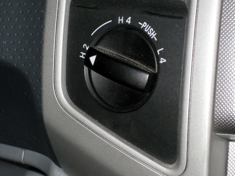

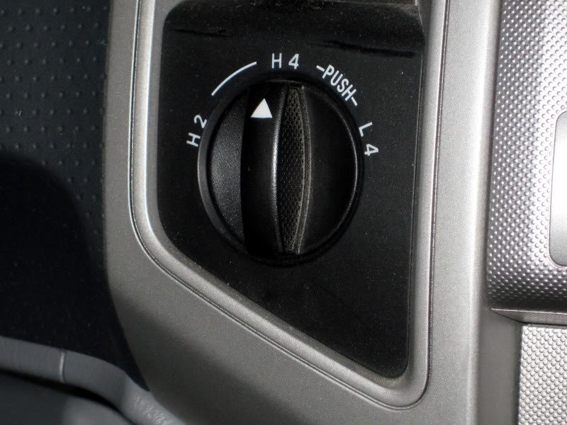

    Old thread, I know, but I've been researching some old ones and still haven't found an answer, and this one seemed semi-on topic.
    I know how you're supposed to shift from 2h to 4h, keep it under 60mph and turn the not clockwise, once that light stops blinking you're set. To shift from 4h to 4l you stop, put it in neutral, and turn the switch the rest of the way. That much is easy enough.
    That all sounds great if you're riding down a road and think 'it would be nice to be in 4wd' and have time to plan it, especially because my truck seems to like a a few blocks before it engages fully. My concern is what happens when I parked my truck on a nice sunny dry day in 2h, and don't need to drive again until there's a foot of snow that has been packed down. I parallel park next to my house facing uphill, and I feel like I'm just gonna be out of luck with the 4wd.
    A normal thought would be to park it in 4h or 4l when I think snow might be coming, but it's really tough to take tight turns when the 4wd is engaged, and obviously parallel parking consists of turning you wheel pretty much to full lock in one direction, then full lock in the other. I haven't tried it yet, but I don't even know if it would be possible to park in a tight spot on a dry road with 4h engaged.
    Is there anyway to get into a truck parked in 2h, realize you now need to get into 4h/4l to get out of a parking spot, and convince the truck to shift, or is that function only useful if you can plan ahead for it??

    It is impossible to go into L4 without passing through H4 first... there is no shortcut... no worm hole through a parallel universe... LOL

    You shouldn't need 4L to get out of a parking spot, 4H will do it. Start the truck, put it in N, turn the knob to 4H and the light will blink, put it in D (or R) and the light should turn solid. If it doesn't put it in gear and LIGHTLY hit the gas. Don't floor it or it'll slam into 4wd and you could do some damage. You should be able to move forward and backward at least a little.

    Go ahead and do that while parked like the poster asked about, you still won't be in 4LO , the truck needs to be moving , so you would still be in 2wd with the dial in 4LO .

    It doesn't take a few blocks to engage... It will engage instantly or within a few feet or a few wheel spins. Yes, difficult to steer sharply on dry pavement in 4WD... but it pops back out into H2 almost right away if you leave it in H4 at night and it didn't snow the next morning, when you turn the dial back to H2.
