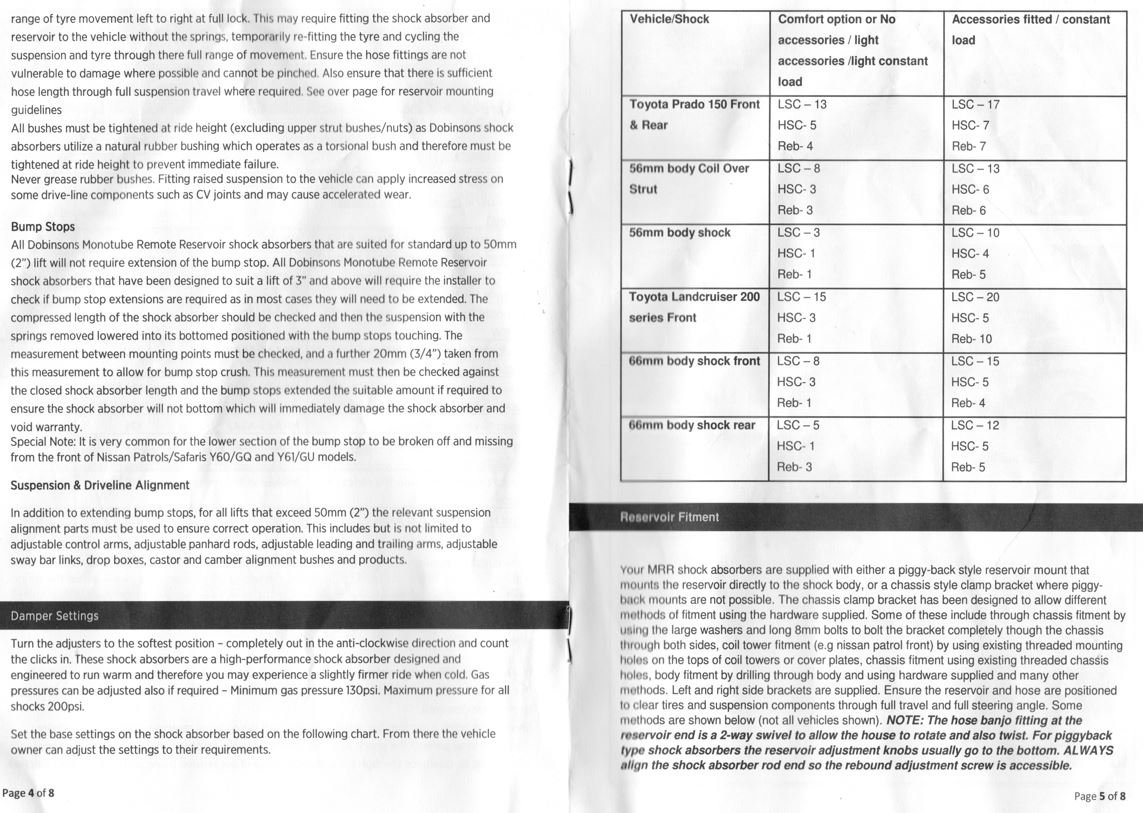

    I received this via PM by @Crikeymike :
    They're only supposed to go to 226mm maximum (8.89764 inches) from the bottom of the coil seat to the center of the lower mount hole. Anything more than that and it's going to put too much preload on the coils.
    Here is how to measure it:
    From the Fitting Guide (below, also, you can try post #21's baseline settings too). My DCLB hub to fender measurement was 20.5" stock :notsure:

    Just measured from center of lower bushing to top side of lowest point on ring that supports spring(lowest point of spring to center of bushing)
    9-1/8'' +/- 1/16''

    My re bound is at 2 full turns low comp.is 4 and high comp is at 6. I have alot of weight so I have comp a bit higher.

    Yeah, like the other guys said, sounds like too much preload and too much lift. Do you have all the front accessory weight on it that you'll have? That's the heaviest and tallest spring Dobinsons offer, and it requires a heavy front end load to ride correctly (and to compress the springs to the correct ride height) but additional preload is definitely causing it to top out. Ideally the front of a Taco shouldn't be any more than 23.5" hub to fender.
    Taco's have varied from 20", 20.5" and 21" from hub to fender when new and Dobinsons use 20" as their baseline for stock height up front. AC's are 21".

    Just check with them what actual springs they used. 314's give 2" of lift with the stock coil seat height of 213mm, so if you do have 314's, you'd lower it down to that setting and get the proper ride height.
