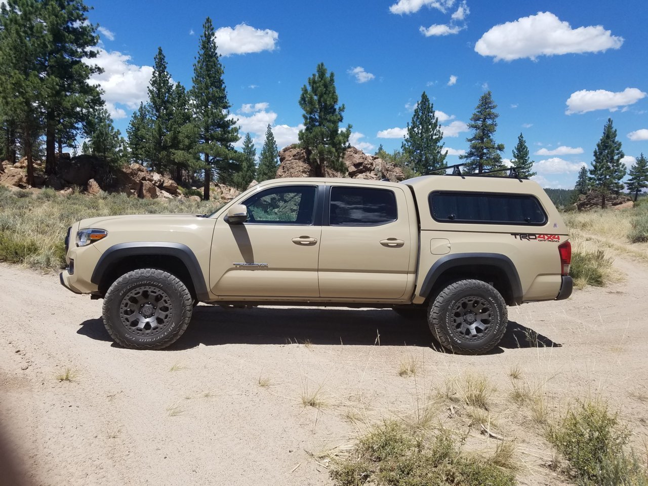

    None whatsoever after two months. I recently spent a week traveling forest roads and it worked great.
    I'm really glad that I went this route vs 5100's or OME.

    Is the truck leveled or do u have some rake? I have a dclb as well and I'm looking to level it out with 2.5 up front and wanted to replace the leaf like you did.
