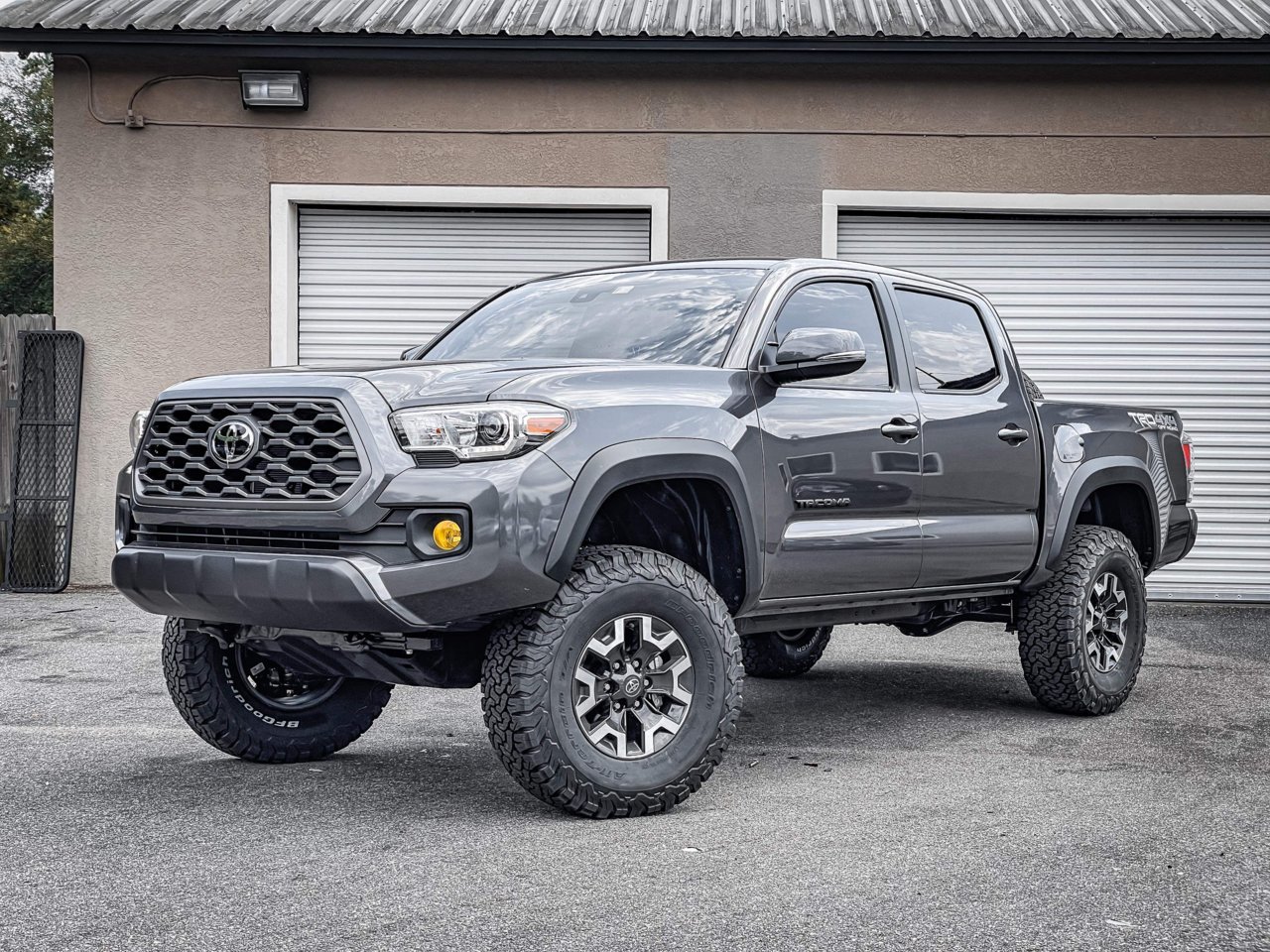

    Very pleased with the way it all turned out! 3/2 w/UCAs on 285s rides like a cadillac!
  9. Apr 20, 2021 at 10:35 AM
    #1009
    BeachBum2012
    BeachBum2012 Well-Known Member
    May 23, 2018
    #254316
    231
    Brian
    Downey, Ca
    2018 Tacoma TRD OR DCLB
    A bunch of shit...
    That looks fantastic!

    Thanks! Im super stoked with the outcome and drive ability

    Damn man niiiice! Which springs and shocks did you get?

    Its kind of refreshing to see a nice looking truck with the stock wheels still on it. I love the look of them and will be sticking with 'em myself. Going for a very similar stance to yours.

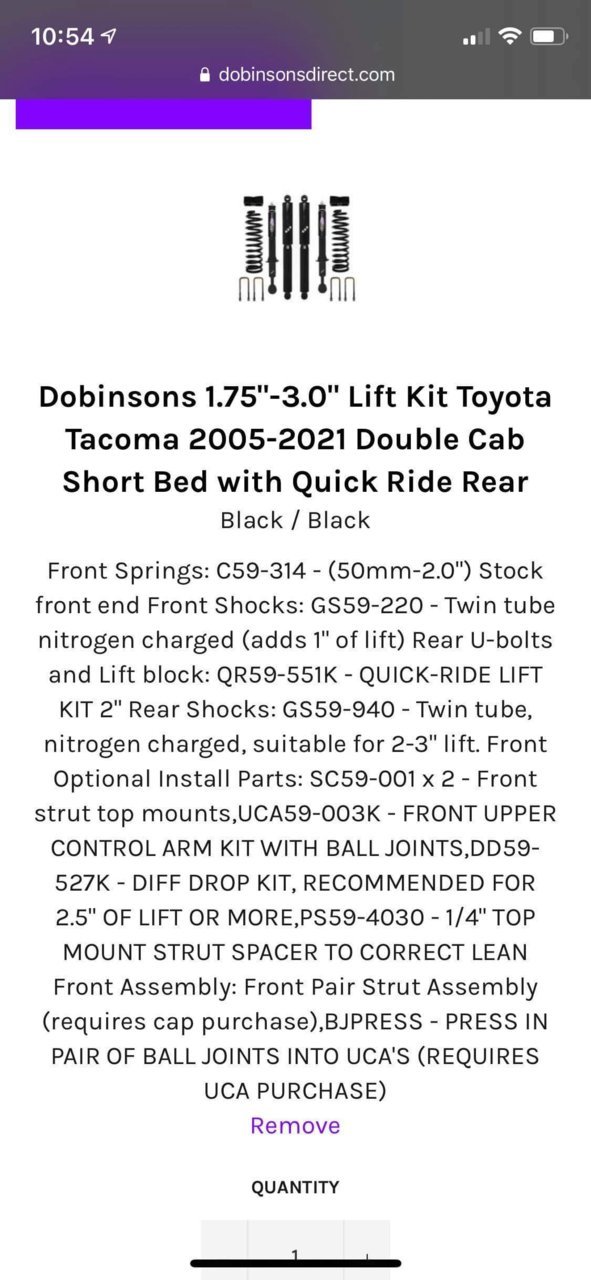

    here is my order:
