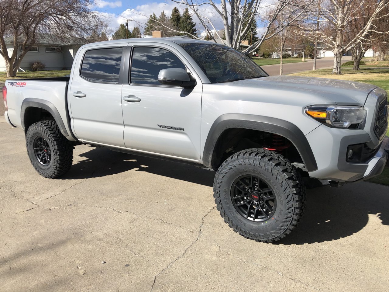

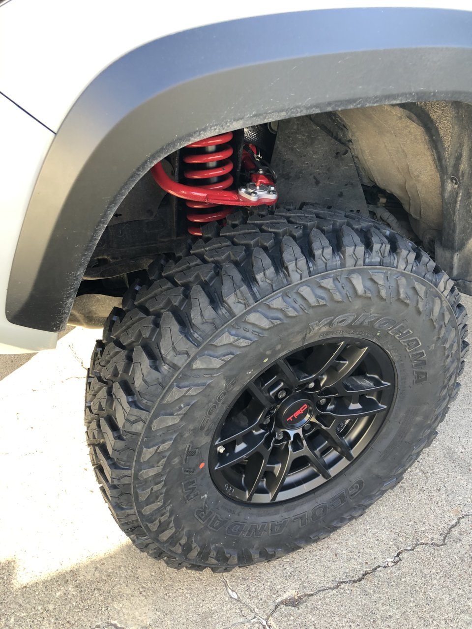

    352 springs IMS no reservoir 220mm, jba, 1.25 wheel spacers, 1 inch body lift. Put 2 inch blocks in the back till leaf springs and shocks come in. 2021 TRD Pro wheels and 285/75r16 Yokohama MTs34DFE1B4-62DD-4B34-8409-4E55932A6105.jpg B9D0C006-8C83-4A94-ABAF-14CF48E0D764.jpg @Crikeymike

    Nope not yet waiting for alignment on Friday.
