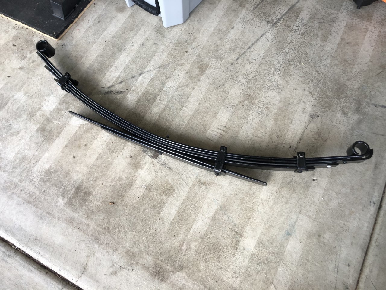

    Anyone know where to add the additional leaf to 110 in order to make it a 111? I went the hard way of getting my medium-duty pack :(

    I will only fit in one place. Once your have the new leaf and you have it next to the 110 leaf pack it will be obvious

    You’re right. Hardest part was getting those stupid barcodes off. Thanks!

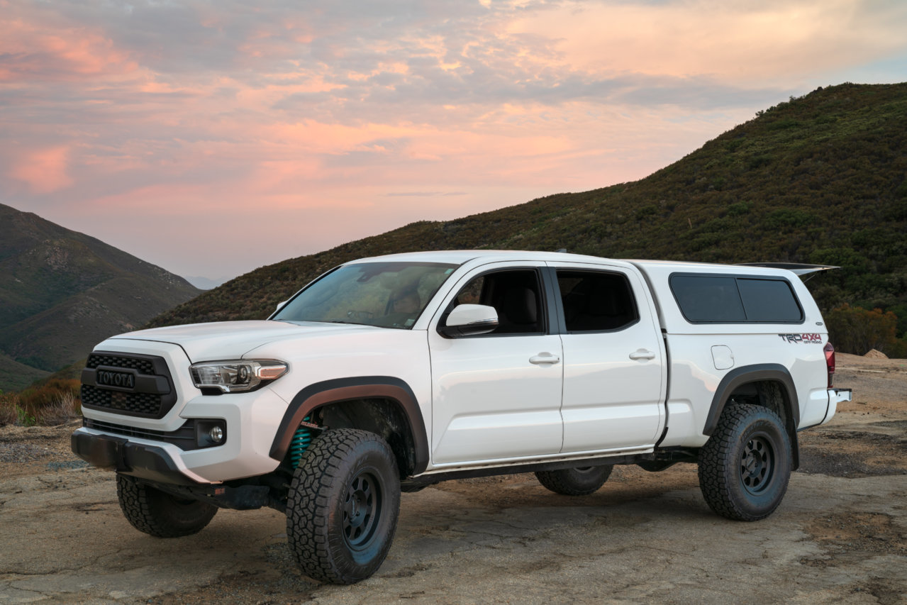

    Whats up all. I recently had my lift put on my 2018 DCLB Offroad and so far I'm pretty stoked. I know a bunch of people are wondering about measurements with Dobinson's springs, etc. so here's some pictures and measurements of where I'm at so far after 300-400 miles on the new suspension. It was pretty tight straight out of the shop but since then has softened a bit almost back to the same ride feel as stock which I actually liked with the Offroad Suspension. I will say this about both Dobinson's and Dirt King, both outstanding customer service. I had some questions along the way which I felt looking back were pretty obvious and dumb but both companies were more than willing to help a long the way. The San Diego Truck Shop did the install which I had to get a CMC and they did a great job imo.
    TMP04908-HDR.jpg Components
    Front
    Bilstein 5100's set at 0
    Dobinsons C59-314 front Coils for 2'' lift
    Dirt King UCA's (Had to support the local business)
    Rear
    Bilstein 5100's
    Dobinsons Tacoma L59-111-R Leaf Springs 2'' lift with shell
    Dobinsons U-Bolt Kit (UB59-453-2K)
    Dobinsons Greasable Pin Kit
    Dobinsons Alloy Strut Top Mount Spacer 1/4"
    Dobinsons Toyota Tacoma 2005-2019 Rear Polyurethane Leaf Spring Bush Kit
    Wheels
    Method MR701 16"
    Toyo Open Country AT3 285/75-16
    Measurements
    Front Left & Right
    Ground to Fender - 38.5''
    Hub to Fender - 23"
    Rear Left & Right
    Ground to Fender - 39"
    Hub to Fender - 23.5'

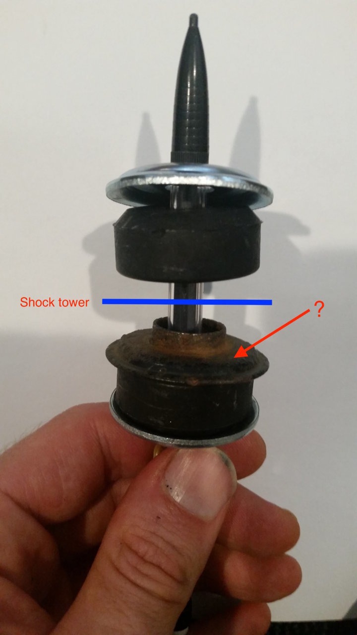

    I am almost done with a complete suspension replacement with Dobinsons MRRs all around and rxt leaf packs. I've got a really basic question on the rear shock install. What is the order of the top bushings and whether or not I need to reuse one of the stock bushing "caps" (sorry unsure on the terminology) below is a photo of the bushing stack. The part in question is the one with the red arrow. It was pressed into the bottom of the shock mount/shock tower on the rear frame but fell out when I was cleaning it up. Does this go back in? It seems like it should but it is also a rather crap/flimsy part so was considering replacing it first if it is required. Thanks for the input, I am really close to finishing this install, first time doing suspension, and don't want to have to tear it all apart because I messed this bit up.
