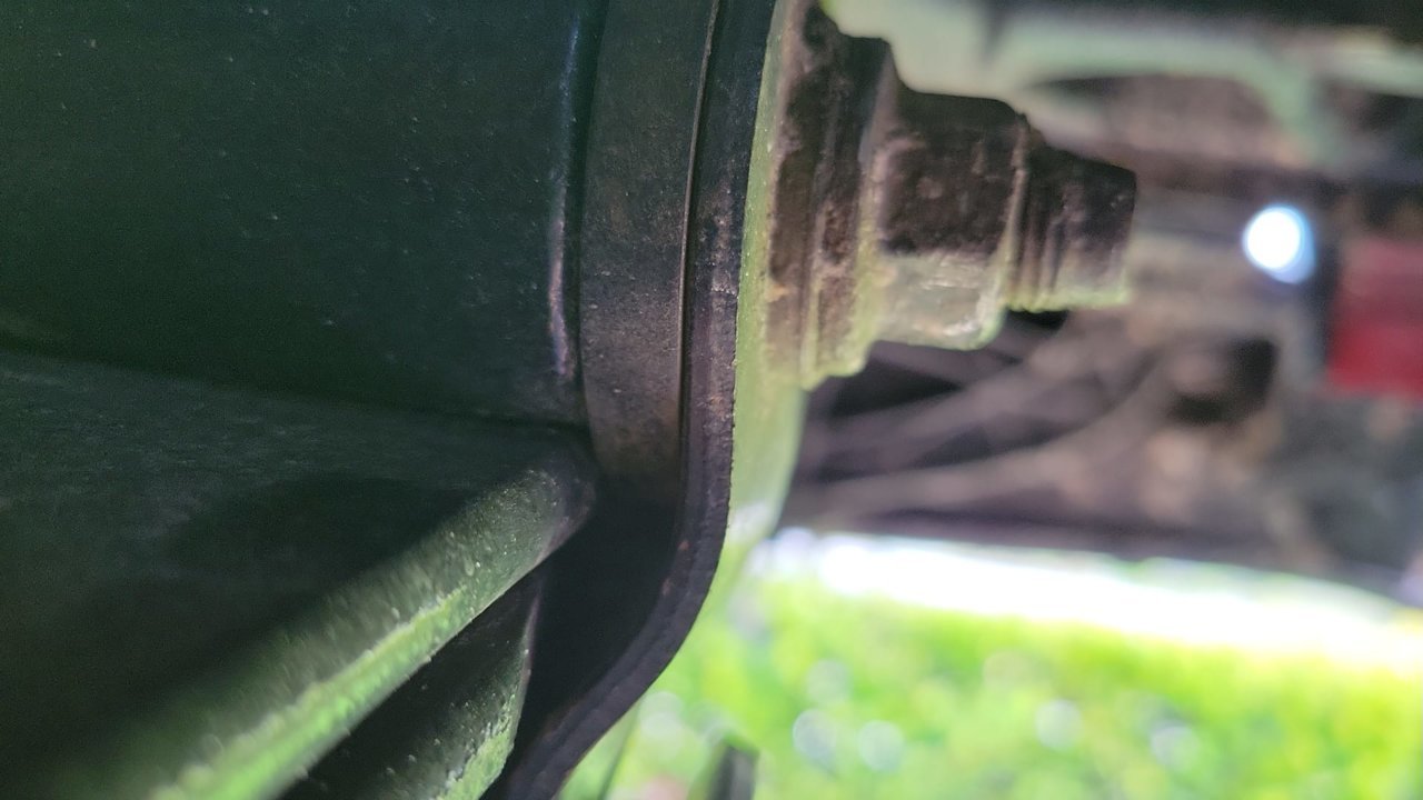

    The photo shows the correct orientation. The rear shocks are supposed to come with a new washer with the lip. That's called "the centering washer" to keep the shock stud dead centered in the upper shock mount. It was probably stuck to the shock mount just from rust, but it's not supposed to stay in there. The front struts use the same washer under the strut mount to keep the bushing and stud centered, so if you have some from the front leftover, you can use one of those.

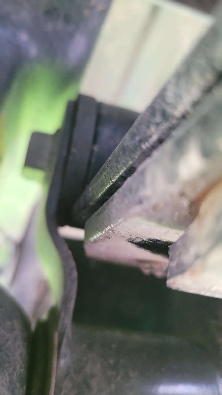

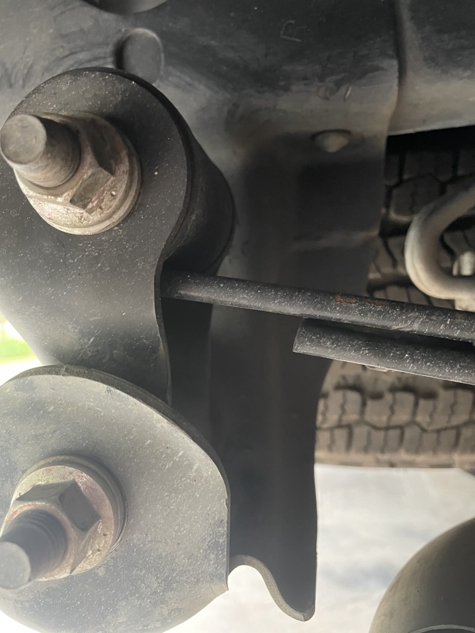

    Hey folks. Ive been seeing some discussion on dobinson leaf packs where the second leaf rubs inside the stock shackles during articulation causing wear/damage to the shackle. Does anyone have any insight on this? I was wondering if trimming the very end of the second leaf might be a solution or if there is a shackle out there with greater clearance. It sounds like this in not a Dobinson isolated issue its just that I've got a set off 111's and Hammer hangers that I'm getting ready to install. Any feedback and advice is much appreciated.

    It's been more than a year since the design change on the leaf springs, adding more clearance on the leaf. If you've recently bought the springs, there won't be an issue.

    Thank you. I picked them up from a local 4X4 shop so I'd have to reach out to them to find out when these are from. Do know if there's any obvious measurements i can take to determine if I have the updated design or not?

    Hammer hangers eliminate this problem along with adding a bit more strength and supposedly a little more articulation.

    I checked last night and that's actually what mine look like too. There's some pictures of 111's over on the Archive thread that show that second leaf extending back closer to the rear eye. I'm not sure which is the newer revision but it seems like something to pay attention to regardless

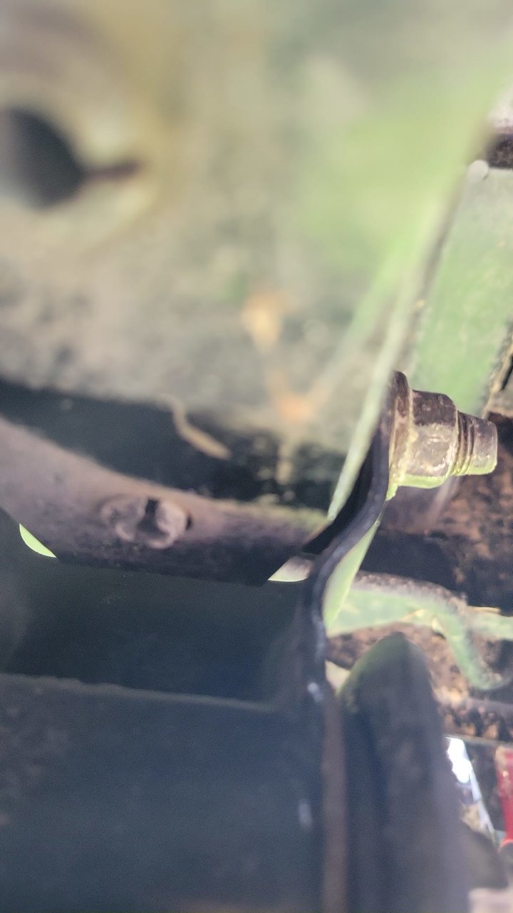

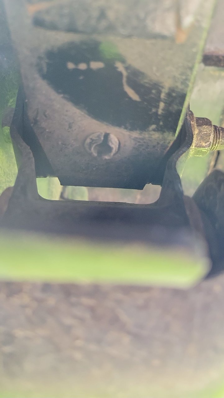

    I have yet to receive a complaint on the leaf springs since the design change over a year ago. Here they are, they clear the shackle. I think there's maybe an issue with an aftermarket product and their item doesn't fit all the other leaf springs being sold by the thousands around the country.

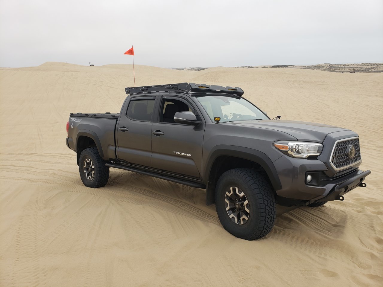

    20210828_160524.jpg Finally got to take the truck out and get dirty in the dunes after installing the MRA kit. Got a bit of rubbing on the UCAs and inside if the fenders where the flaps are. Im going to remove the flaps and take care if that issue. Any thoughts on what to do about the UCA rubbing?
