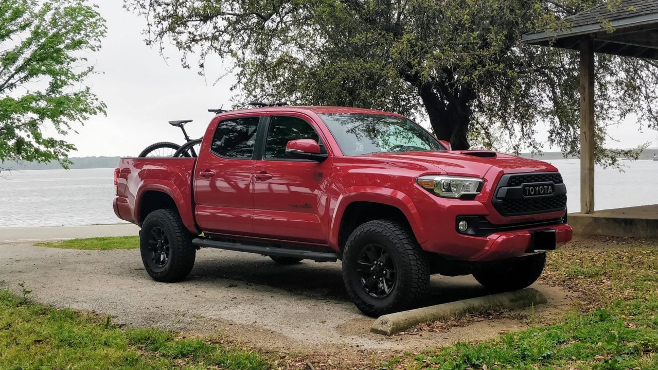

    Installed the Dobinsons thanks to Tandem Automotive in Fort Worth. Also, Thank you for the help Mike (and Dobinsons).
    Rear: GS59-940
    Front: S59-221 w/ C59-302 coils
    Compared to the OME 3" lift kit I had before:
    Ride is overall softer and smoother. Firmer than stock but an improvement over the OME kit. Noticeably soaks up bumps/potholes better than OME. Handles almost the same as the OME with only a slight increase in brake nosedive but definitely preferable to the harsh/stiff ride of the OME kit. Still, much preferable to stock or the OME 3" lift.
    Tandem removed overload leaf which in result lowered rear by about .5"-.75". Front sits noticeably lower with the 302 coils compared to the 886 OME coils. Although I prefer a complete level look with either the front sitting higher or the rear a little lower, it is fine as it is. Now, the front has all the joints, axle angles, at almost stock specs to save all the parts from premature wear and the wheel alignment came out almost perfect.
    This is how my truck sits now. I estimate about a 2" to 2.25" lift in rear. And 1.5"-1.75" in the front.

    That's good to hear!! The removal of 1 leaf in the rear really helps the ride quality a lot too. Thanks for the details in your review.

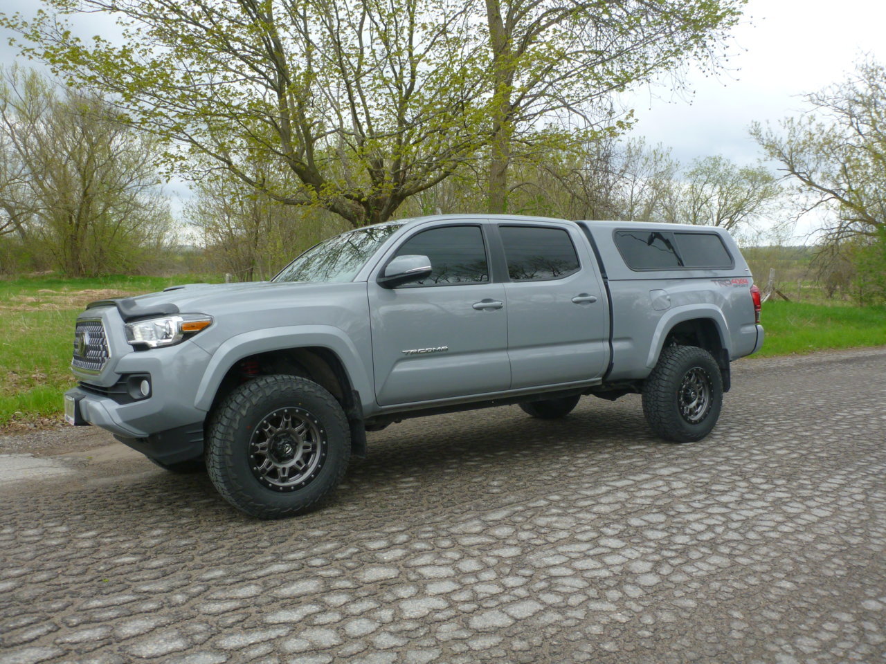

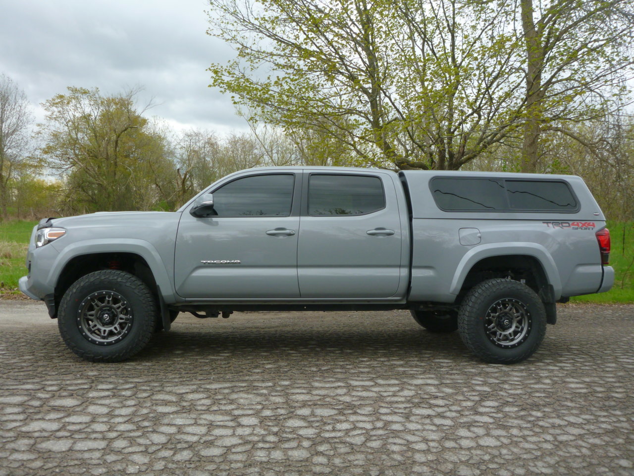

    Hey Guys,
    Just finished the install of my MLO Dobinson 2" lift on my 2019 TRD Sport. Faulken WildPeakes 265/70r/17 on Fuel Hostage III.
    Eric from MLO was great to deal with. Answeres all of my questions.
    Dave

    I'm guessing it's a softer ride than your old sport shocks?

    The ride is very compatible if not a little stiffer. Not sure, but maybe the new suspension needs to brake in.

    Stiffer? That's.... Impressive. And not in a good way.
