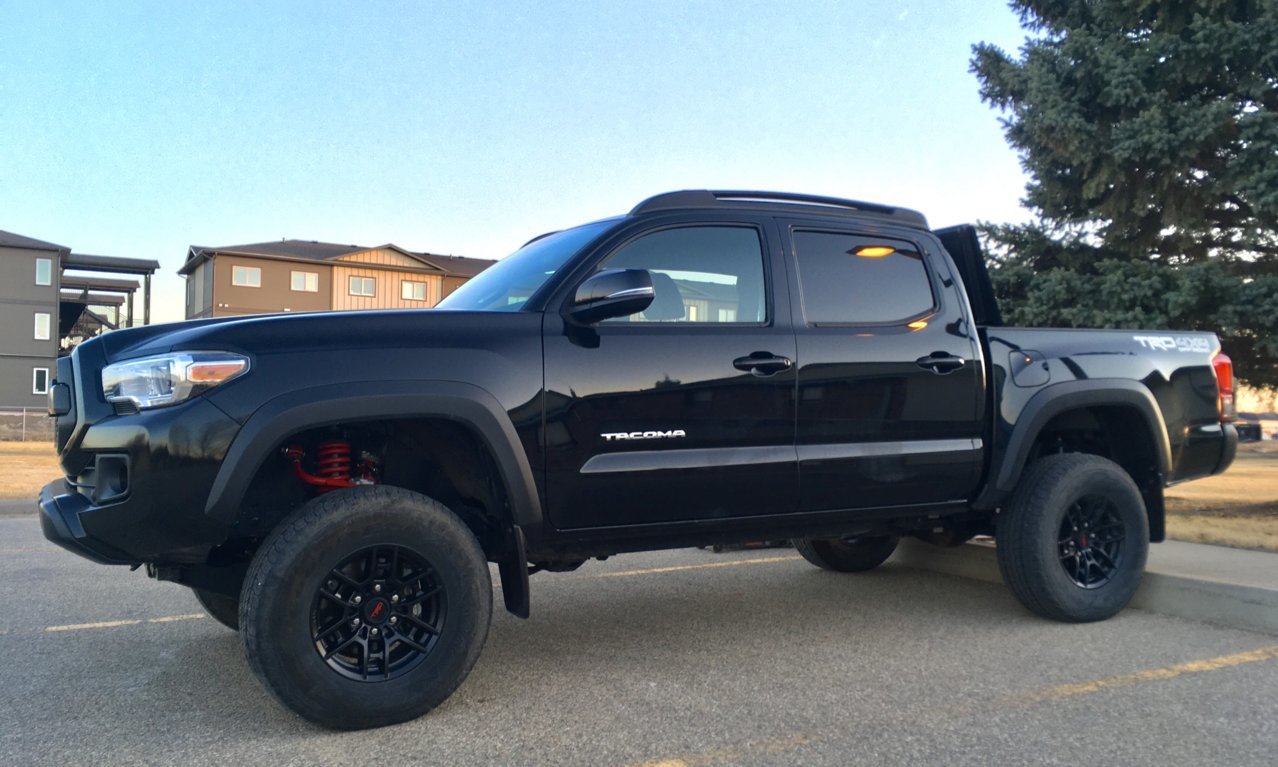

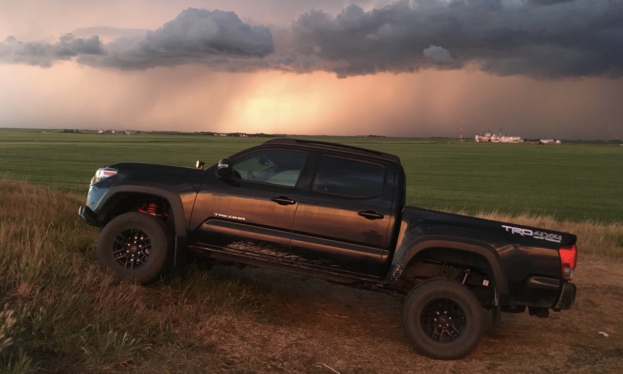

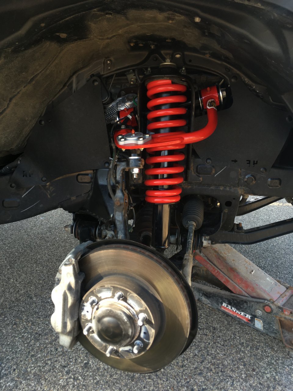

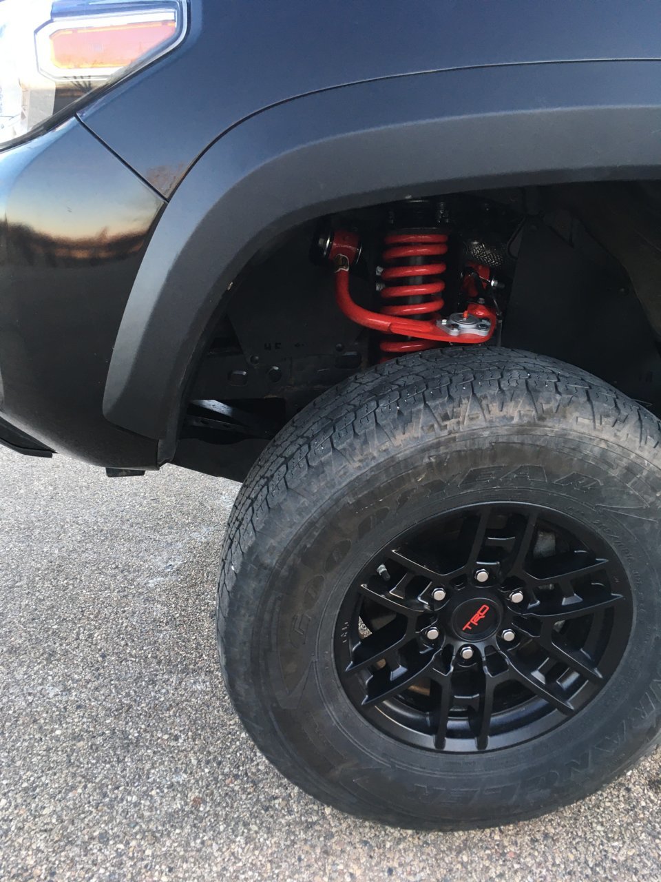

    Another day trapped inside, I thought I would update my experience so far running these Dobinsons.
    Original review here: https://www.tacomaworld.com/threads/dobinsons-16-taco-suspension.474308/page-22#post-22628006
    Or quick synopsis: I originally went with the 302/220 combo and 110 leafs, and with the help of a friend and the shelter of a garage, put them on at the end of January. The 302 coils were listed as 1.5" lift, and with the extra +1" from the 220, were to put me at 2.5" up front and the 110's at 2.1" in the back. After install everything looked good, the numbers, the stance, the ride...I was happy. However, I quickly found that the suspension seemed low, and sure enough, after a week it had settled to 1.5" in the front and 1.25" in the back. DCSB OR, no additional weight besides a tonneau cover.
    After a few emails, photos, and phone calls, Mainline Overland kindly offered to send me a pair of 314 coils (supposed to give 2.5", which with the 220 shocks would be 3.5"). They then put me in touch with Dobinsons who ultimately sent me the 111 leafs to try for size (supposed to be 2.75" with 600lbs of weight). Both claimed this was the first time they heard of the lifts not giving the height as advertised.
    Fast forward to end of April, I've moved across the country into an apartment and had the pleasure of redoing the whole install by myself in a church parking lot (No sarcasm ;) ). The second time around went much smoother as you have a much better understanding of how, what, where, why, but most importantly, you don't have to undo 2+ years worth of metal to metal contact. You'll notice I also threw on JBA UCA's, which for all intents and purposes are a perfect match to the Dobinsons red. And after having the sway bar get in the way quite a bit during the install, I decided to take it out and see how it would ride without, and worst case, fumble it back in.
    Because I don't want to write a book about it and you (maybe?) don't want to read one, here are my main takeaways from riding these Dobinsons over the last 6 months.
    Ride - Definitely stiffer than stock OR, which for the most part feels great on the road, however you'll notice the potholes more. For that, I would highly recommend removing the sway bar; the coils are plenty stiff to keep the body roll to a minimum without the sway bar, and not once have I felt unconfident in the trucks handling at high speeds. It also frees up the articulation off-road. I should also note that when Dobinsons sent me the 111R leafs they warned me the ride could become much harsher as they're designed to hold 600lbs constant weight, however, I didn't notice much of a difference between the 110R and 111R leaf springs.
    Height - My first setup with 302/220 front and 110R rear settled to 1" lower all around than advertised. It was no surprise to me that after installing the 314s and 111R they also did not meet their advertised height. 314 coils with 220 struts should net 3.5", and the 111R's should be 2.75" with 600lb load, likely a little more if stock like me. Of course, right after install the numbers were good, but a week later had settled to 2.5" in the front and 2.25" in the rear. After chatting with Dobinsons, it doesn't seem to me as if they measured the lift gained by each coil/strut combo on an actual truck, or if those numbers are just theoretical. If they did, I'm not sure if they ran the parts long enough to the point where they settled. I remember reading from two members in this thread whose lifts have settled like mine, notably the 302 coils and 110R leafs. Perhaps everyone else measured their gain right after install, was happy, and moved on with their lives? Or some of us just have heavier trucks by a half a ton? In any case, Dobinsons and MLO did their part to get me the lift I was after so I'm happy.
    Rust - I previously wrote a post on this topic (https://www.tacomaworld.com/threads/dobinsons-16-taco-suspension.474308/page-28#post-23253428) When swapping out the suspension, I noticed quite a bit of rust spots had developed on the coils and the struts had paint bubbling up with some corrosion underneath in a few areas. The ones on the coils are from abrasion during shipping (I noticed it on both sets of coils) and I would recommend touching them up before install. I'm not sure what caused the paint bubbling/corrosion on the struts, perhaps the coil scratched it up as I was getting them positioned. Nothing a wire wheel and a rattle can can't fix. We'll see after another winter how they hold up.
    Squeaking - A few weeks after this second install and a few local gravel road drives, one of the 111R leafs developed a squeak. It's a little dusty this time of year, but still, Dobinsons does say these don't squeak...I've had the pressure washer up close and personal with the leaf a few times already, though with the truck under its own weight, but after a day or two the squeak comes back. I've yet to get the truck up on a jack and manually clean between the leafs...I'm hopeful that will fix it for good!
    Bottom line - For the price and my experience so far with both the ride and the customer service, I am very happy with Dobinsons. No product is perfect, and none of these issues that I've had are not unexpected or unfixable.
    And here we are today (well, a few days ago technically):

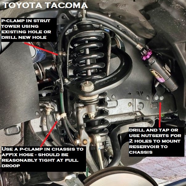

    I put this together from the great photo that a forum member recently posted, for those needing to see how the MRA 3-way adjustable resi mounts.
