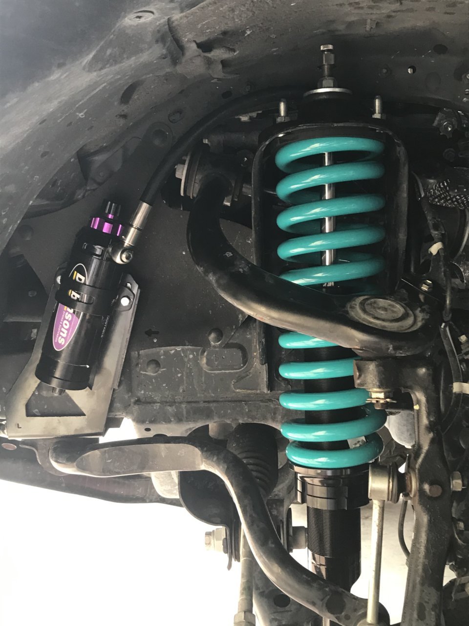

    Bracket goes on top of the sway bar brackets on each side. Note to self, it’s easier to fit the reservoir and tighten it up, then mount it. FYI. I also used two P clamps on the rear side of the strut mounts to hold the reservoir line in place and out of the way.

    PSA for anyone who might still have the MRR front reservoir brackets bolted into the frame. Mine stripped out on the driver's side. I'm replacing them with the new style that bolts onto the swaybar mounting bracket found here.
