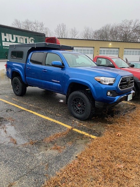

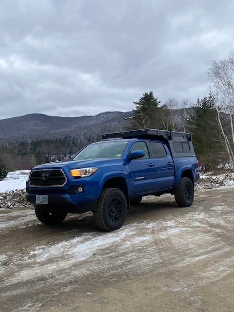

    finally got around to installing the lift and wheels have some slight rubbing at full lock on mudflaps but overall love how it turned out
