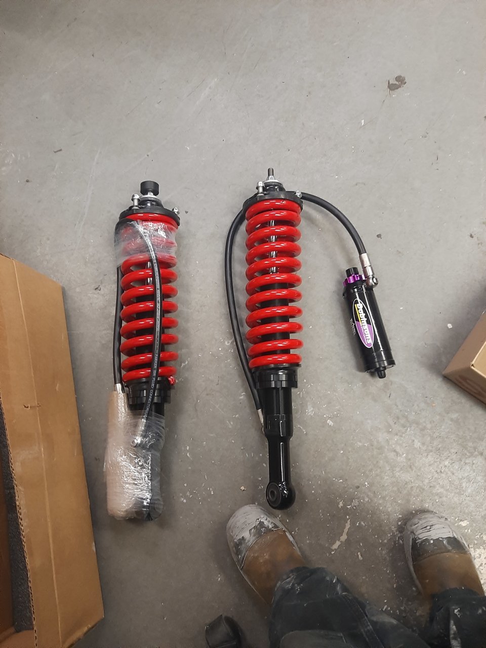

  15. Jan 26, 2021 at 12:52 PM
    #255
    Dalegribble02
    Dalegribble02 Well-Known Member
    Apr 27, 2019
    #291535
    1,368
    Savona British Columbia
    2014 SR5 4x4 meg grey sold
    Dobinson mrrs Deaver leafs archive garage hammer hangers.
    Just got these from @Crikeymike can't wait to install these
  16. Jan 26, 2021 at 12:56 PM
    #256
    DavesTaco68
    DavesTaco68 Well-Known Member
    Oct 22, 2016
    #200391
    3,349
    North Thompson, BC
    2013 Tacoma TRD
    - ICON UCAs, BP51/Kings, SCS wheels, 285s, Leer 100XR canopy. Greenlane aluminum winch bumper, Smittybilt X20 winch. Trying Falken AT3w now, Really like BF KO2s.
    They look good, once things are bolted up let us know what you think.
    Crikeymike[OP] likes this.
