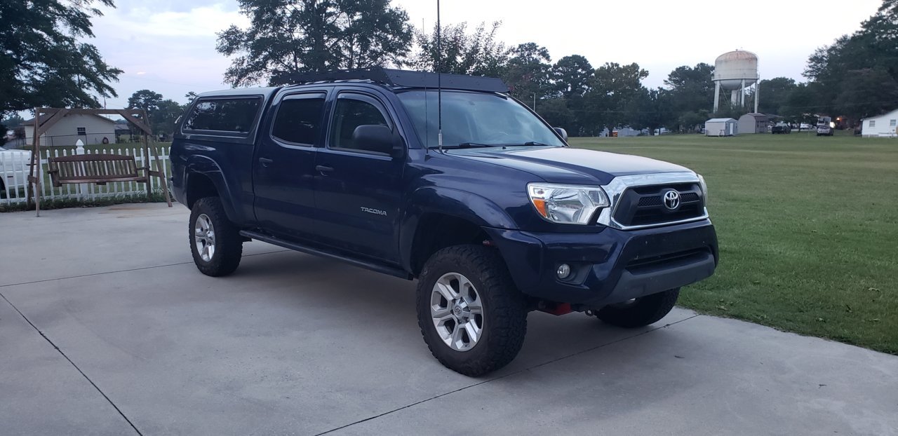

  15. Aug 16, 2020 at 9:03 PM
    #35
    gixxerphil
    gixxerphil @concretelander
    Mar 31, 2018
    #249012
    24,846
    Phillip
    Auburn, Alabama
    2013 DCLB
    Lift is done. JBA UCA, IMS struts with Dobinsons coils, HD rear leafs with 5160 shocks(until I can get the rear IMS's :D)
    Thanks again Mike for all the answers to my many questions. You've definitely earned further business from me :thumbsup:
