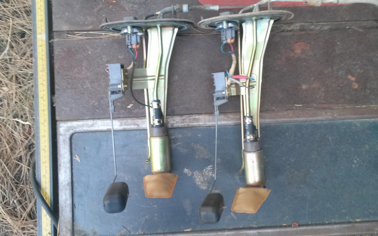

    So here is the difference in the pump assembly. The 1 on the left is from a 15 gallon and the other is from 18 gallon.

    Very nice, probably easier to just buy a complete 18 gallon tank used with the sender in it and fuel pump too

    Nice picture thank you
    This also informs about the general depth/height/clearance difference of the larger tank.
