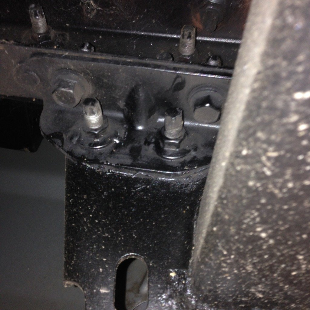

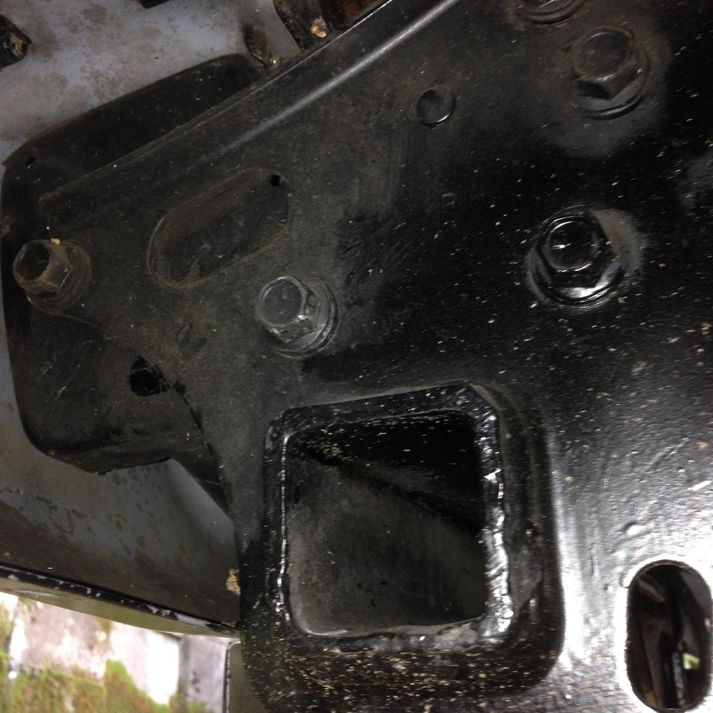

    That doesn't look like an OEM hitch to me. This is the factory hitch which came with my 05 DCLB 4.0. The ends are completely open and have 5 bolts on the flange. Also there's a separate angle bracket (first photo) Not sure if you were thinking that's an OEM part on eBay. Plus the light trailer light hookup cap doesn't look OEM.
    0735FD42-4F32-423B-A104-E3CF651D4744_zps_65115ecff4905dcea5e0979aa9db00c931975c72.jpg
    1ADCB04A-1FC7-4789-A965-0A80B2EEC9AA_zps_b13e326aeebb1719bd5498c411e0124f55cf5c97.jpg

    Not all 2.7L are 5 lug. They made regular cab and access cab in 6 lug with 4wd and also prerunners in access cab and double cab that were 6 lug. Also, hitch was not a standard option on 2.7L, although you could pay an absurd amount of money for one from dealer. You're better off buying a Reese or Hidden Hitch new. I paid $120 brand new for a Reese Class III from Pepboys on sale.

    I have compared the configuration of that one with my fram and it deosnt seem like it would fit. it doesnt sit low enough to clear the bumper...

    Further research shows the hitch to be part of a Toyota accessory kit, P/N PT791-04050. However, it's missing the large frame-attachment flanges. Here's what a full kit looks like (dealer listing): http://www.ebay.com/itm/NEW-OEM-TOYOTA-TACOMA-CLASS-III-TOW-HITCH-RECIVER-/251550491751
    I recommend messaging eBay seller easternautosalvage and ask if they can pull the frame flanges from the wrecked truck. Worth a shot since $50 is a pretty good discount compared to almost $300 for a new kit.
