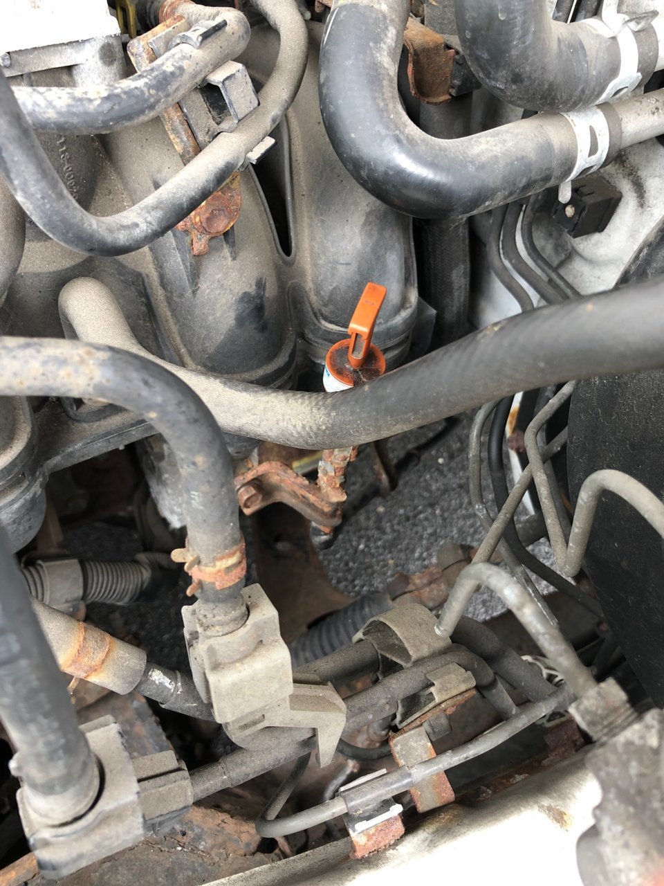

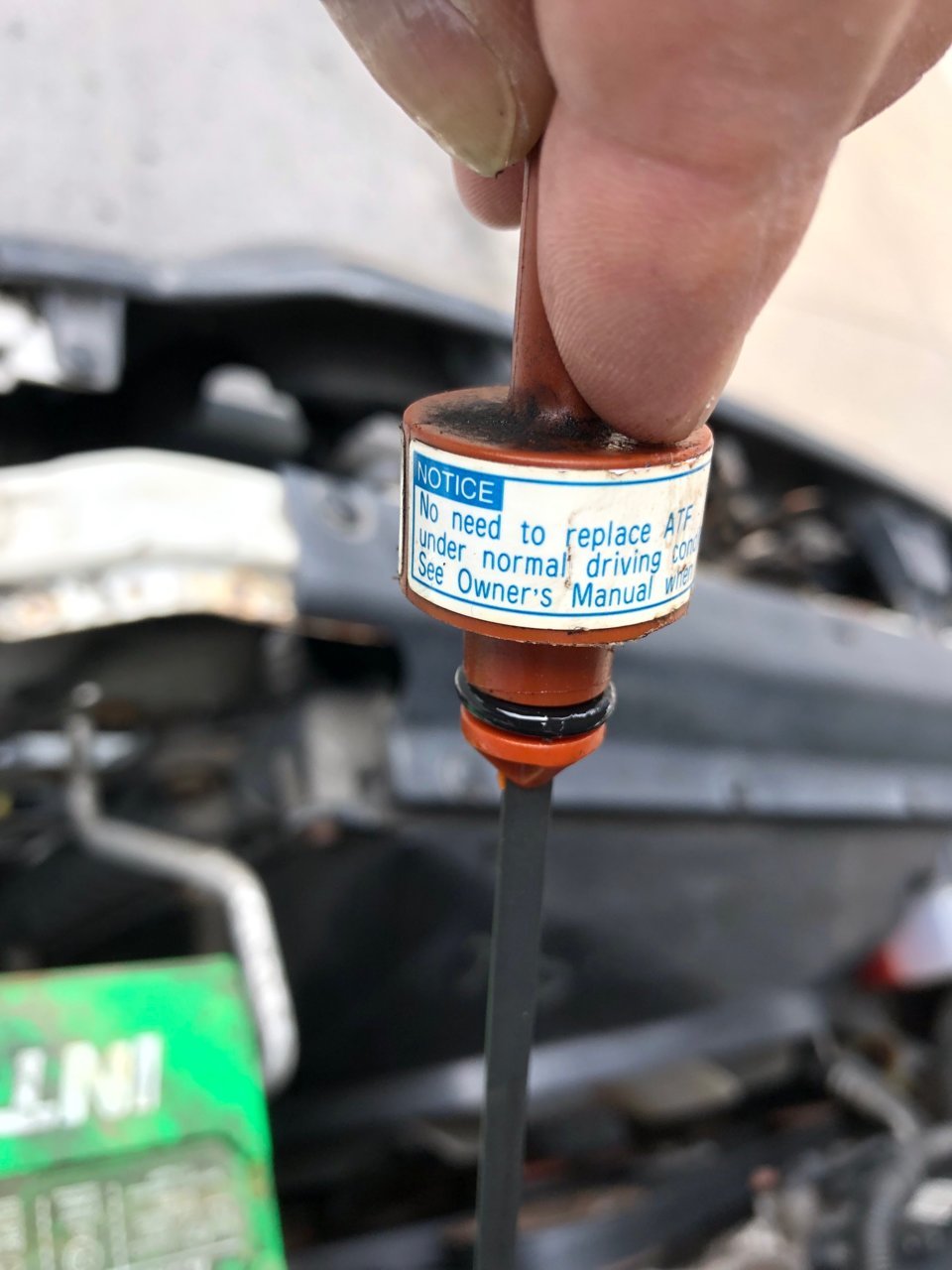

    Hello,
    I recently bought a 2005 Tacoma, Regular Cab, 4 Speed Automatic, 4 Cyl, 2.7. Although this car is not supposed to have a dipstick it does. Below are several photos of the dipstick in my Tacoma. Also after researching this on the internet I found a video that shows a 2008 with a dipstick. This dipstick is identical to mine. In addition the owners manual as well as the Haynes service manual says the proper amount of ATF on a drain and refill is 2.1 quarts. I took down the pan changed the filter. Before taking the pan down I drained the ATF into an old Antifreeze jug (1 Gallon). It filled the jug as well as an old quart bottle and a little more. After changing the filter i put in 5 quarts of ATF and drove around. After checking it was still a little low. I put in a little more and it was full.
    I will probably contact Toyota to find out how it is possible I have a dipstick and why it is taking so much ATF.
    https://www.carcarekiosk.com/video/2008_Toyota_Tacoma_2.7L_4_Cyl._Extended_Cab_Pickup_(4_Door)/transmission_fluid/check_fluid_levelDipstick 1.jpg Dipstick 2.jpg
    lynyrd3 likes this.

    No mystery. The 4 cylinders all have a dipstick, the v6 tacomas do not. Your 4 cylinder with a dipstick is not rare or special.
    Also it's not unusual for the tranny to be a little low from the factory, which could be why you had to add more to top it off after your fluid change. Did you check the level before draining anything?
    OP there is a procedure for checking fluid level in the v6 without a dipstick. It's a pain. You get the trteams up to operating temp (a specific range) then open an overflow bung and fill until fluid drizzles out. There are posts on this forum with how to write ups.

    I drained the ATF into a gallon Antifreeze bottle and into a quart oil bottle. Therefore I replaced 5 quarts and it still took a little more. The owners manual and the Haynes service manual both say 2.1 quarts with a drain and refill. I know the filter can’t hold 3+ quarts.

    Rear End Oil took a little over 3 1/2 quarts. I am doing a complete maintenance on this vehicle. Just became confused about the discrepancy in the ATF amounts.
