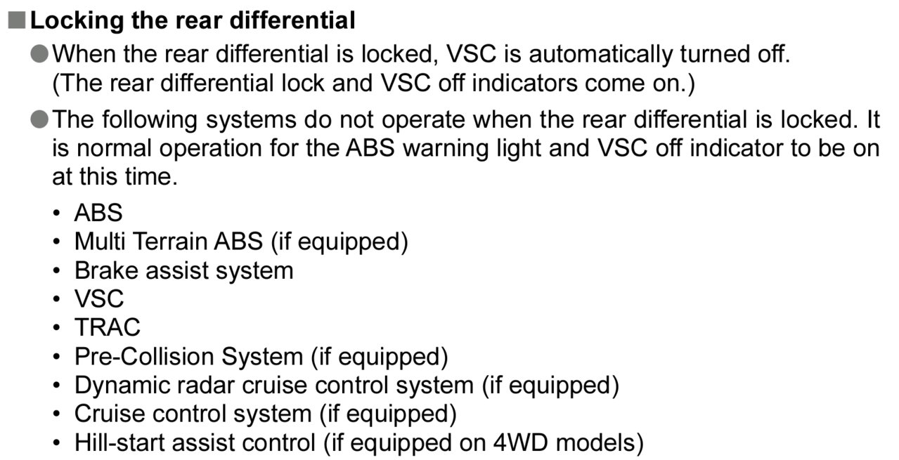

    From the manual:
    Also, I don't imagine ABS will kick in for your above scenario (for the others). Sounds like everyone was moving at slow speeds. I believe ABS will kick in based on wheel speed and a difference in speed between wheels. If all of the sensors are showing that the wheels are stopped, it has no idea the vehicle is sliding.

    I think you are confusing ABS (anti-lock brake system) with traction control. Both use the same hardware, but the purpose is different. The purpose of ABS is to prevent the brakes from locking up the wheels during emergency braking. On the the other hand, traction control is for preventing wheel spin when accelerating.
    Also, I mentioned ABS being disabled when the rear is locked to explain why my ABS didn't work, but it doesn't explain why it didn't work for the other rigs. I'm also wondering if mine would have worked with no locker engaged.

    I'm not confusing the two. ABS is tied in to your wheel speed sensors. I had one go faulty on a previous vehicle and every time I applied my brakes, ABS engaged. Why? Because it saw 1 wheel at 0 MPH and all others moving.

    4 channel ABS CANNOT work if a diff is locked....how would it independently control the rear wheel speeds while they're locked together?...not possible. Without a center diff, it's tough for them to make a front wheel spin a different speed than the rear also. Also, most vehicles disable the ABS under a certain vehicle speed since it does more harm than good at low speeds.
    A-trac applies the brakes to manipulate the differentials, which is entirely different.
    Keep in mind...if all 4 wheels are locked and you're sliding, the system thinks you're standing still.
