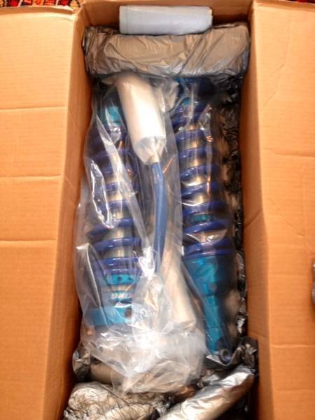

    Aloha all, just got my King Coilovers Remote Reservoirs in the mail and was wondering if anyone knows what they come set at from the factory, or if there is away to determine what they are set at with out installing them and measuring, then taking off and adjusting?
    I'm looking to get 3" of lift.
    From what I've been reading they come set at 2", and it would behoove me to rent a spring compressor.

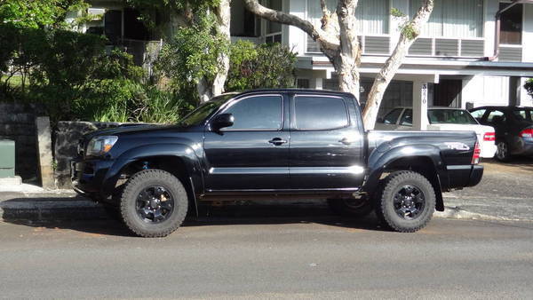

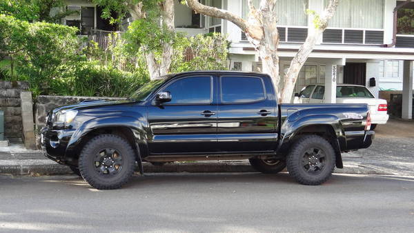

    I can go measure later, but when I put my kings on with factory settings, I got around 0.5 to 1.0 in of lift on the front. My rear alcans didnt lift as advertised so I havnt dialed the kings taller yet.
