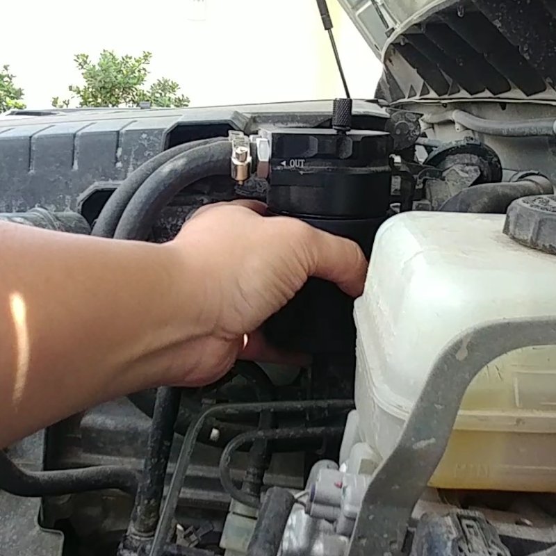

does anybody run a catch can on their 2nd gen 4.0 v6?
Discussion in '2nd Gen. Tacomas (2005-2015)' started by 4X4ACCESS, Nov 20, 2019.
  1. Nov 20, 2019 at 10:46 PM
    4X4ACCESS
    4X4ACCESS [OP] Active Member
    Nov 6, 2019
    #310056
    41
    North Texas
    2015 Tacoma SR5 Access 4x4
    Bilstein 5100s OME 883 coils
    always ran one on my ram and it was necessary. Would it be necessary on my 2015 4.0 Tacoma? Any pics or DIY's?

    You can but they don't have pcv recirc issues. The intakes stay pretty clean even at really high mileage.
    I've actually never seen a 4.0 with excessive blowby in all my years working on Toyota. Saw lots of Nissan VQ's with oil in the intake when I worked at Nissan for one year.

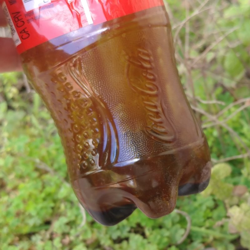

    Had it on for my smog in SoCal. The dude didn't mention my catch can. He was more interested in aftermarket y pipe and skids. The catch can is a good idea. Not only for your intake but exhaust as well. Do you call this clean combustibles? Screenshot_2018-05-14-18-23-17-01.jpg Screenshot_2018-05-14-18-19-38-01.jpg 20180514_120907-01.jpg

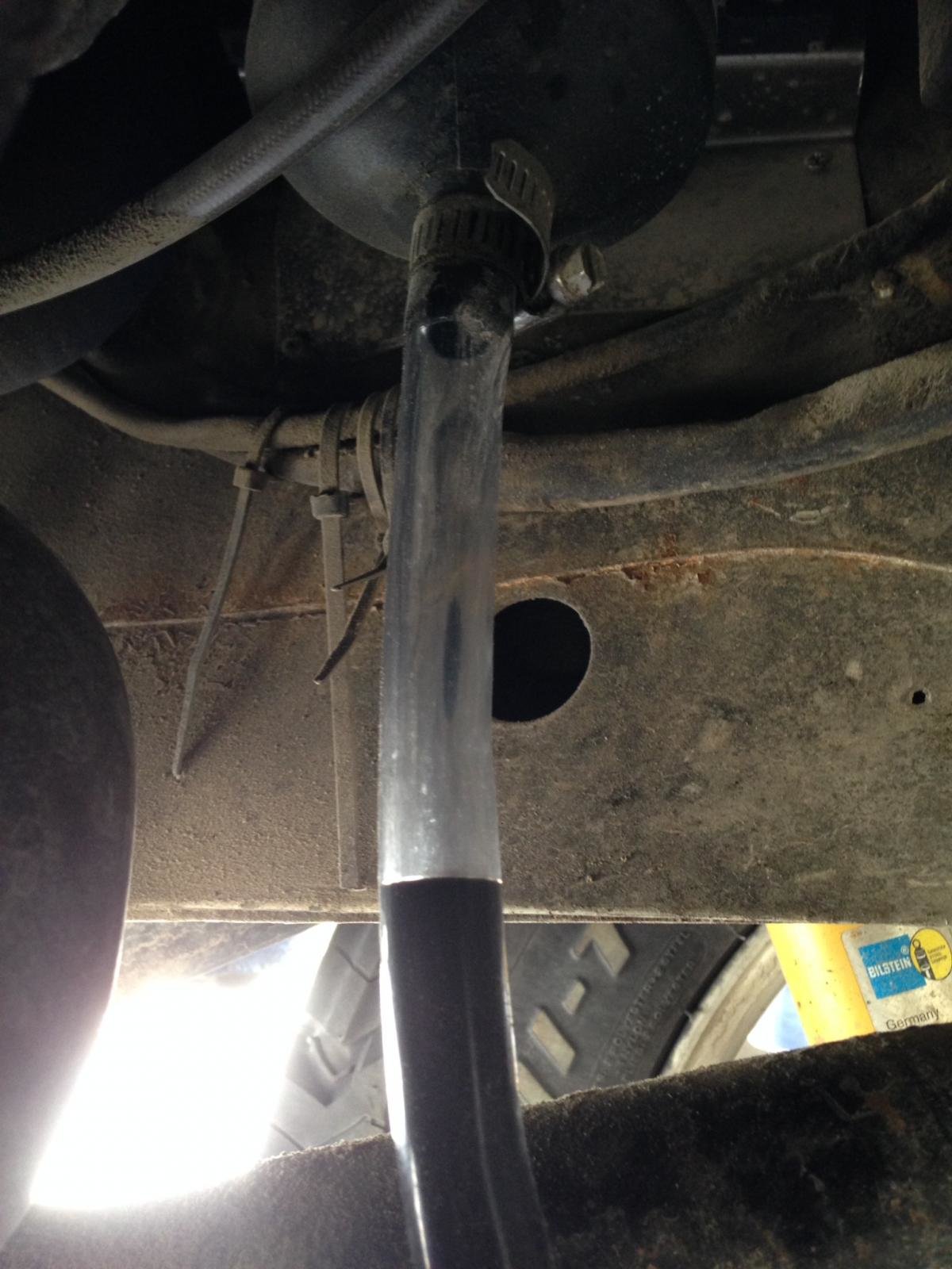

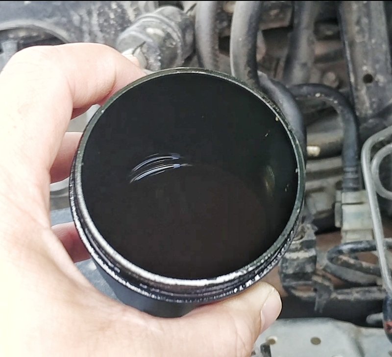

    I have had one on my taco for a couple of years now and it is suprising how much it collects. It gets drained same time as an oil change and I would guesstimate it has 1/4 to a 3rd cup in it. I put a valve in place of the drain plug so generally it takes longer to find an empty cup.

    Looks pretty nasty

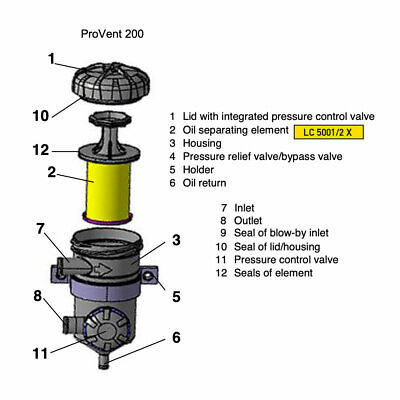

    does anyone know if there is anywhere on the engine that can be used as a drain back
    the Mann ProVent 200 offers this capability in the way of a port, hose, and one way oil valve
    To allow the oil portion collected inside to drain back. Becoming maintenance free.
    other nicer cans may also offer this
    I just don’t know if the engine is compatible with that feature. If there’s a place to put that. That hopefully doesn’t involve drilling a hole anywhere.

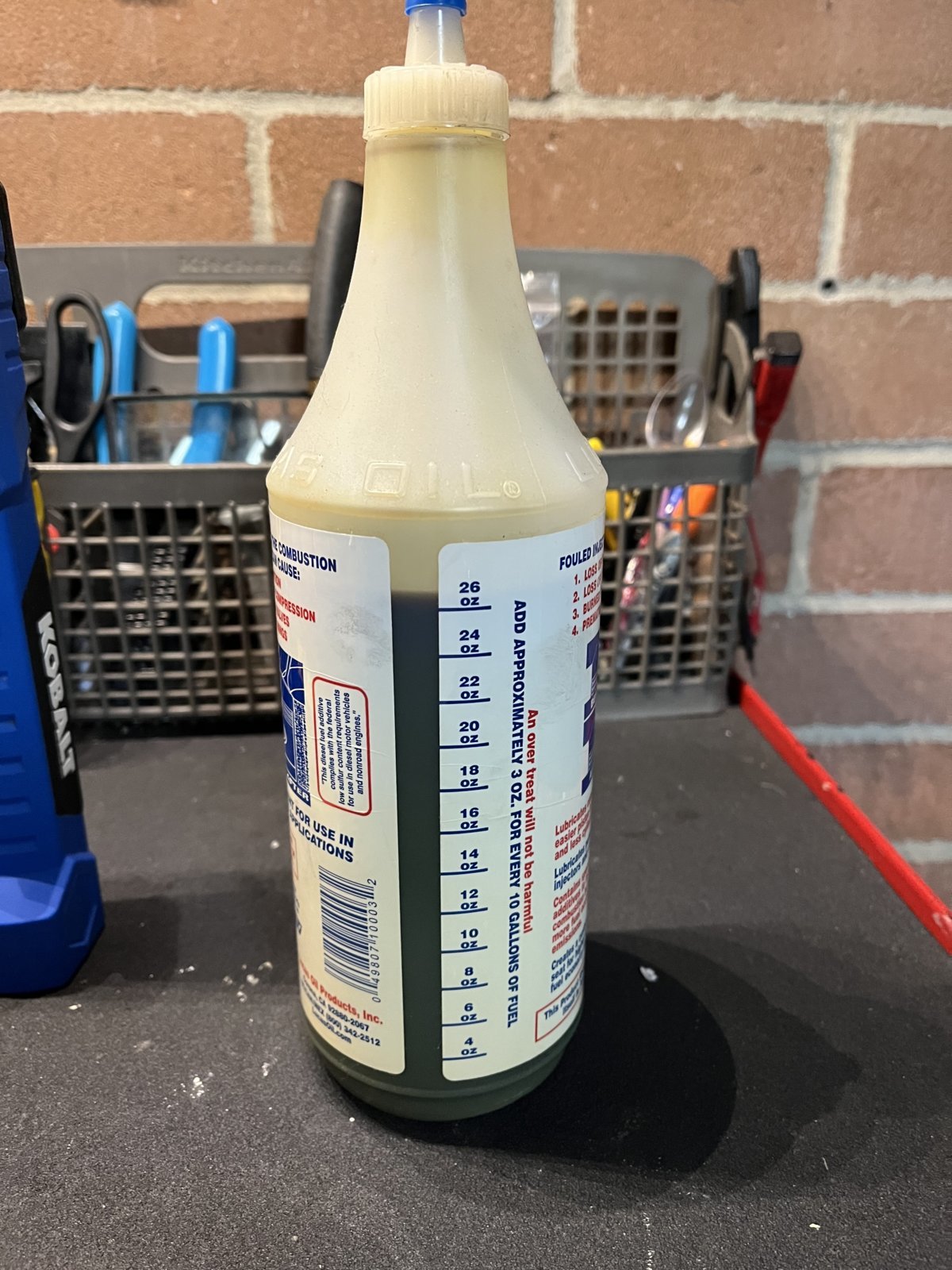

    I collected the sludge at each oil change and after about 45K mi:
    Miles current - 94000
    Miles at catch can install - 49500
    Miles on catch can - 44500
    Total Oz collected - 26
    Collected oz/mile - 0.00058427
    Collected oz/Oil change (5000 mi) - 2.921348315
    Is it worth it?
    You decide!

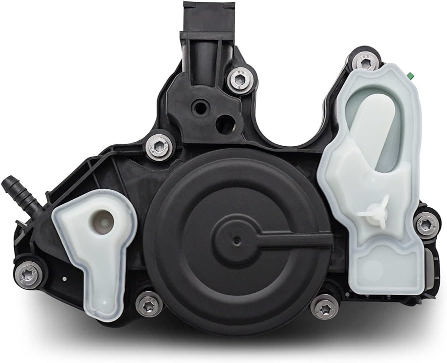

    VW has the system built into the engine. Usually integrated into the valve cover.
