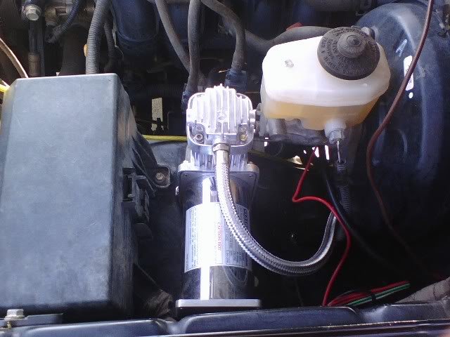

    not high output, but i have this for my train horns....... just an idea

    I think silverback07 has the best OBA set up on here.

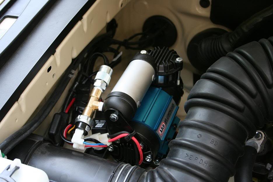

    I'm in the process of having a 3.5 gallon tank fabbed up and that will go under and aft of the rear axle. I will run a fill line and a line that runs then splits to the fron bullbar and rear bumper. For now I just pop the hood and op in the hose and go.
    I have to say that the ARB compressor came with everything you will ever need. Wiring loom, relays, pressure switch, switch and conectors for future air locker switches. Instructions were clear and concise. The hardest part of installation was finding a place to put the air compressor.

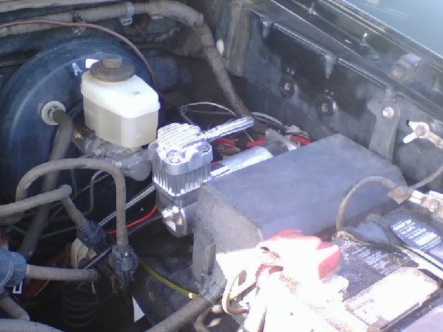

    I have the Air Zenith unit that PB installed on his. I haven't mounted it yet as the truck is in the shop. I'm going to try and put it in the same place he did. It's a 100% duty cycle pump that puts out 2.83 cfm.
    I also have a 4.5 gallon tank that I need to mount somewhere. Since the BakFlip has a small 6" section that doesn't fold, I may see if I can mount it up there.
