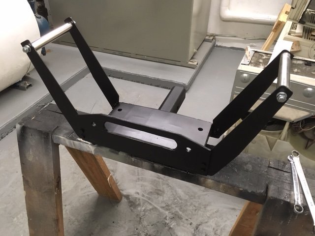

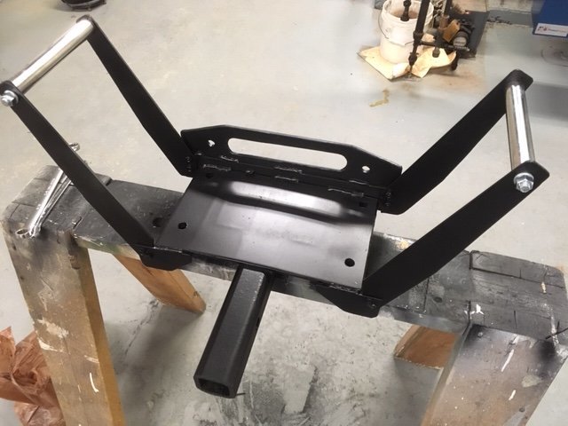

    I use a recovery bar as well and made my own cradle, not to tough. Fun project.WC 2.jpg WC 1.jpg

    Looks very good. What size steel did you use?

    I used 1/4" for the base, 3/16" for the front face, 1/8" for the handles. I have some 1/4" angle gussets on the bottom as well on the stinger.

    That sounds pretty sturdy to me. Did you use any dimensions or anything? How did you cut that oval in the face plate?

    I bought my winch first and built the cradle to fit. Most winches use a standard bolt down pattern. I used a hole saw and a grinder with a cut off wheel for the face plate.
