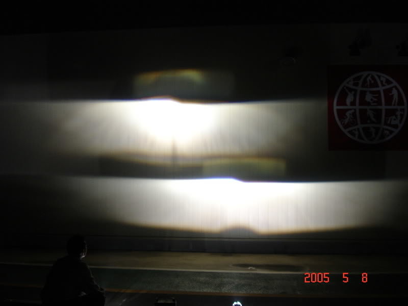

    To sum it up for anyone interested:
    The only notable difference in a hid projector vs a halogen projector was the size and shape of the reflector. Everything else is the same, but the way the bowl reflects the light (nothing to do with the lenses) seems to focus the halogen light in a tighter beam.
    You are not losing any light if running an HID in a halogen projector, but since the HID bulb has more lumens, a HID projector will more effectively distribute the light throughout the beam.
    Here is a good pic from that thread... these are both OEM projectors (one being HID and the other halogen) taken from a Toyota Avensis both running HID bulbs
    (it isn't noted but im going to assume top beam is halogen projector)
    As noted before, Ill try and get a good shot of the Beam from these headlights in the OP soon.
