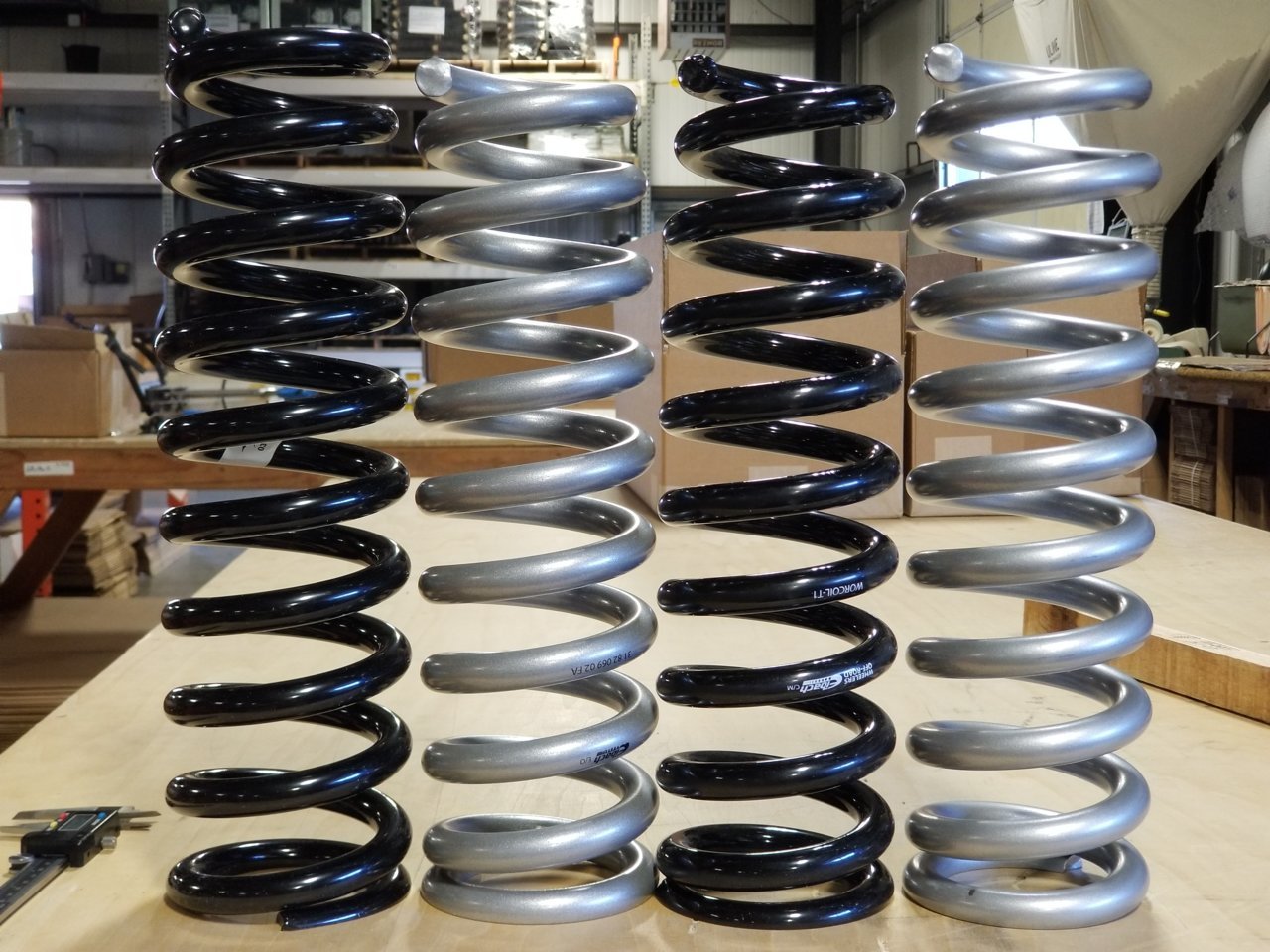

    3rd Gen is different than 2nd gen. I have a 2018 TRD double cab long bed and while planning and doing my lift I found that it's not straight forward (like 2nd Gen). It takes a lot of research to make sure you end up with the lift you really want. For example, I wanted a 1.5" front lift and it took the "2 inch lift" Eibach springs. I found the people at Wheeler Off Road to be extremely helpful and really concerned about making sure I ended up with what I wanted. This is how they helped me... they sent a picture with measurements of all of the logical options.
    "From left to right. First is an OME 2887 that measures 15.75" long with a .675 diameter wire. Next is the Eibach Pro-Truck coil for 16+ Tacoma that you want (E30-82-069-02-20) that measures 15" tall with a .7" wire diameter. Next is the T1 coil that measures 15" tall with a .675" diameter. The last one is the the Eibach Pro-Truck coil for 05-15 Tacoma (E30-82-007-03-20) that measures 15.25" tall with a .7" wire diameter."
