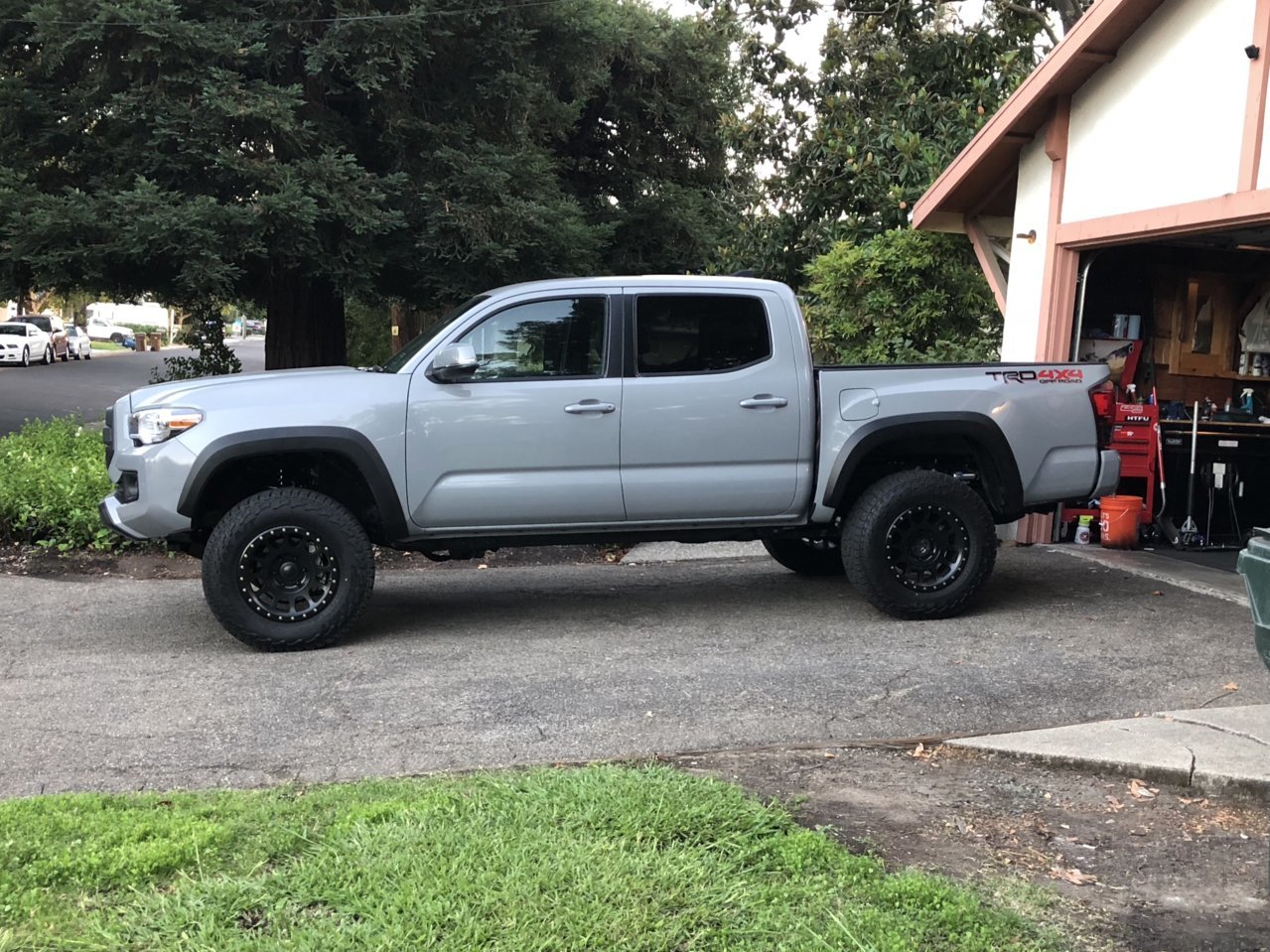

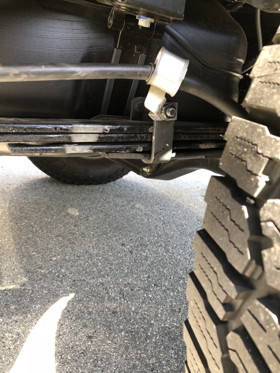

    i did! The worst part was grinding down the rivits and then hammering them out. You could just grind it flush and not pop it out but i was ocd and had to pop em out.
    Thanks! Front end is about 38.25 and rear is about 38.5. Swear i’m never anywhere near a level surface when i think about taking pictures of it. I’ll get more down the road. I ended up using a step drill bit to ream the e-brake cable bracket hole to fit.

    Here is the same exact set up, except with the overload left in:

    Almost wanna toss the overloads in now! Looks good! The max lift for the rears are 1.5” though, aren’t they? Only reason i didn’t put them back in.

    I believe it is 2”. Leaving the overload in is fine.
    Thanks and yea, I prefer the overload as I like the 1” rake.
