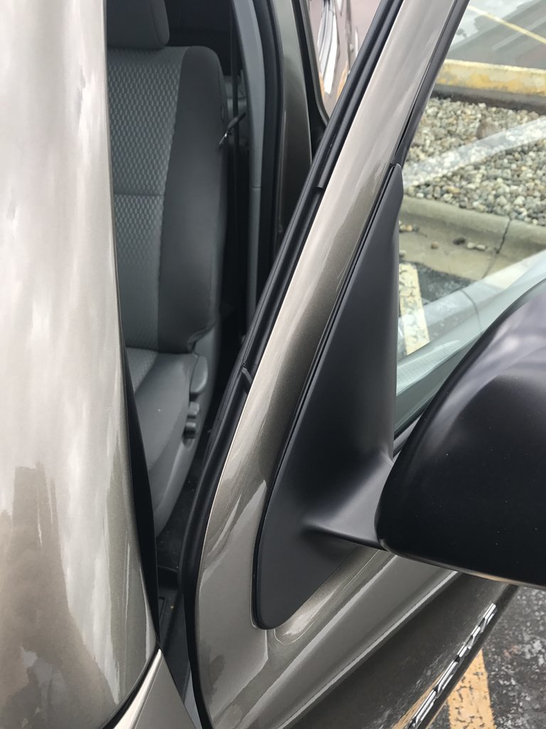

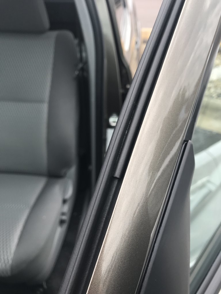

  9. Apr 2, 2018 at 3:56 PM
    NMTrailRider
    NMTrailRider Well-Known Member
    Sep 28, 2009
    #23469
    5,292
    New Mexico
    Here are pics of the updated (TSB) seals. Identical to originals but they have a ~1/8" foam bead glued into the strip on the leading edge.
    It runs from just behind the top "corner" of the window to about 2/3 of the way down the front.

  10. Apr 2, 2018 at 4:14 PM
    DarthPow
    DarthPow [OP] Well-Known Member
    Feb 27, 2018
    #245786
    2,570
    2012 DCLB TRD Sport 4x4
    oh, that's interesting. Thanks for the pics, looks like something that would be very easy to just put in yourself.
