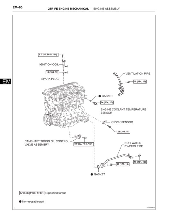

    the spark plug coils and the intake cover on a 2010 4 cyl ? thanks for looking

    Tight, but not too tight, not that you can really measure this low but how bout 6-8ft lb. Honestly just snug em up nice and use blue loctite if you're really worried

    13 ft lb for spark plug

    2017 4Runner

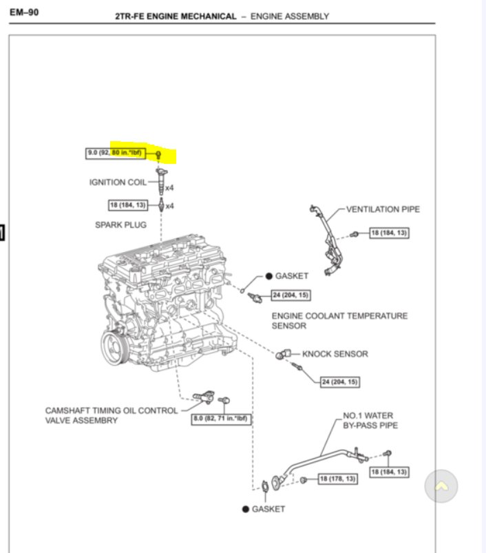

  10. May 3, 2018 at 9:27 PM
    OldDog
    OldDog [OP] Well-Known Member
    Aug 15, 2010
    #41754
    132
    w.mass
    2010 reg cab 4X4
    Torque would be 80inch pounds =6.6ft pounds for both
