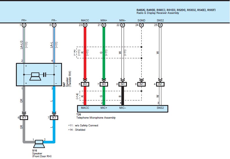

    Remove the fuse, see if you get the effect you want without adding a CEL...

    This is the location of the DCM:

    You don't want to pull that fuse, your hands free won't work without the DCM getting power. You'll be able to play music from your phone, and hear people while on a call, but the other person will not be able to hear you.

    He can "re-wire" the mic if he wanted to...
    And Bluetooth is not inside the DCM...it's in the Head Unit...

    Lamens terms for everyone but @caribe makaira who can build a tacoma from scratch. He can connect the mic, but DCM needs power, so he has to disconnect the non-essential pins on the DCM.
    That won't work either. Mic is gone. Your vehicle can't hear you with the fuse pulled.

    The easy part is that MESO & DSIM already sell a T harness of IN1...

    @BlessThisMess & @caribe makaira Thanks for digging into this and providing the information. I had hoped that removing my OEM HU would eliminate the "phone home" feature, but that is not the case. Since I already have swapped out my HU for an Android option with a self-contained mic, I don't think I will lose a thing as far as functionality when I yank that fuse. I'll be pulling it tomorrow as a test.
