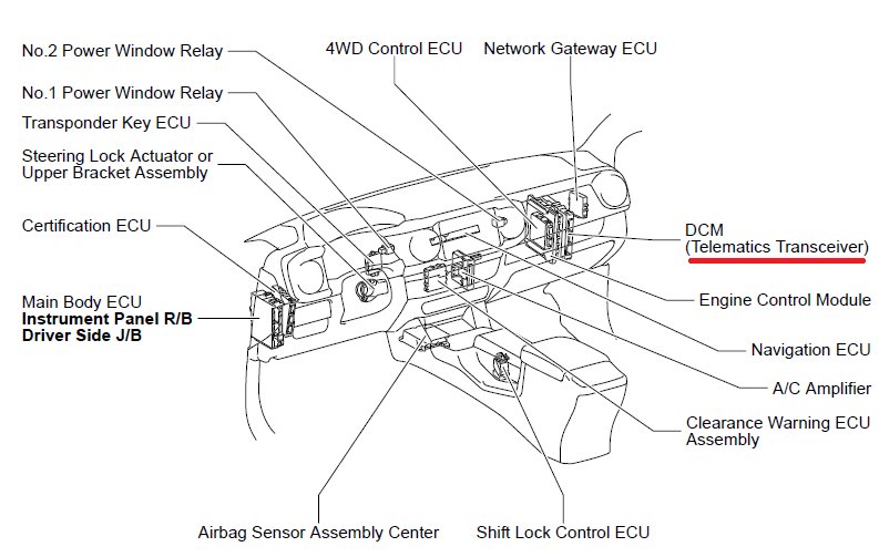

    Wow thats kind of nuts to see how many computers are in the newer trucks. Does anyone know what the "certification ECU" does, or certifies as it may be?

    It does the stuff on checking your key.
    For smart key users it verifies the key is inside the vehicle (theoretically). It also does smart key door handles and stuff like that.
    For H key, it will make sure the key transponder is recognized.
    (I assume it also does unlock and lock buttons on the key....)

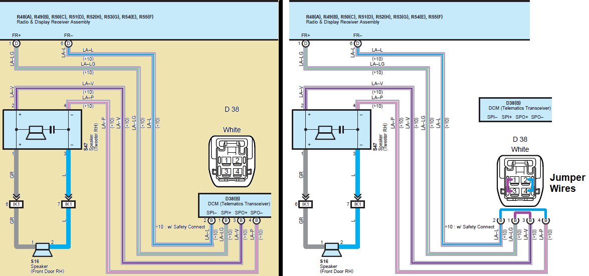

    To recover the Right Hand tweeter and door speaker:

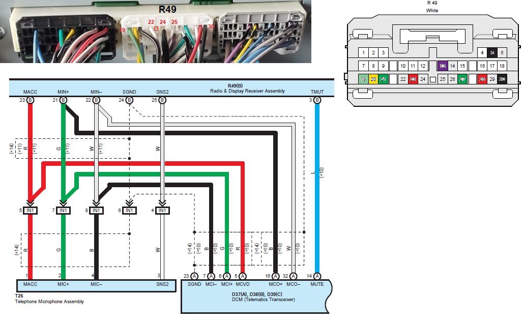

    Microphone recover (A):
    Jumpers on connector D37
    (B):

    It be better if it was easy to acquire the mating connector, but I think it's not a Toyota or Denso. It looks like same type used for the Certification ECU and the Main Body ECU...TYCO...

    No..that you will need to add some wires as jumpers...

    Been waiting for a thread like this for a long time, following! Has anyone physically looked at the DCM Telemantics Transceiver or the network gateway ECU to see if it can simply be unplugged?

    Not sure yet. I never checked for audio output from my stereo yesterday, I was too busy checking everything else.
    @caribe makaira shared a couple diagrams that suggest that the speakers on the right hand side may not function correctly if the fuse is pulled or the wires are disconnected.
    EDIT---
    Didn't get out until this evening, but did crank up some tunes on the drive.
    No issues at all, my speakers all work fine. Think the wire connections and jumpers have to do with making things work correctly after removing the module entirely.

    OP, this is what connector R49 on Head Unit should look like with the DCM wires to it. Notice it is missing the red wire from mic MACC to Head Unit MACC.

    Really? Do you have your cellphone linked to the Head Unit? Did you do a call test to verify if the other person hears you?
  19. Apr 15, 2020 at 3:35 PM
    #39
    nwlinux
    nwlinux Member
    Jan 17, 2015
    #146557
    8
    Mark
    Tacoma, WA
    2020 TRD
    SoftTopper
    @caribe makaira - I just placed a call to my wife using the hands free cabin microphone. Your suspicion was correct - it doesn't work. Thank you for asking the question. This test tells me that the cabin microphone is integrated, or has access to the DCM. You may also presume that the Toyota/NSA/others are listening to our conversations and transmitting those data every minute we're driving, regardless of our consent. I'm keeping my fuse out. I'm okay with not having that function. For others, I can see that it might be a critical component for work or other purposes.
