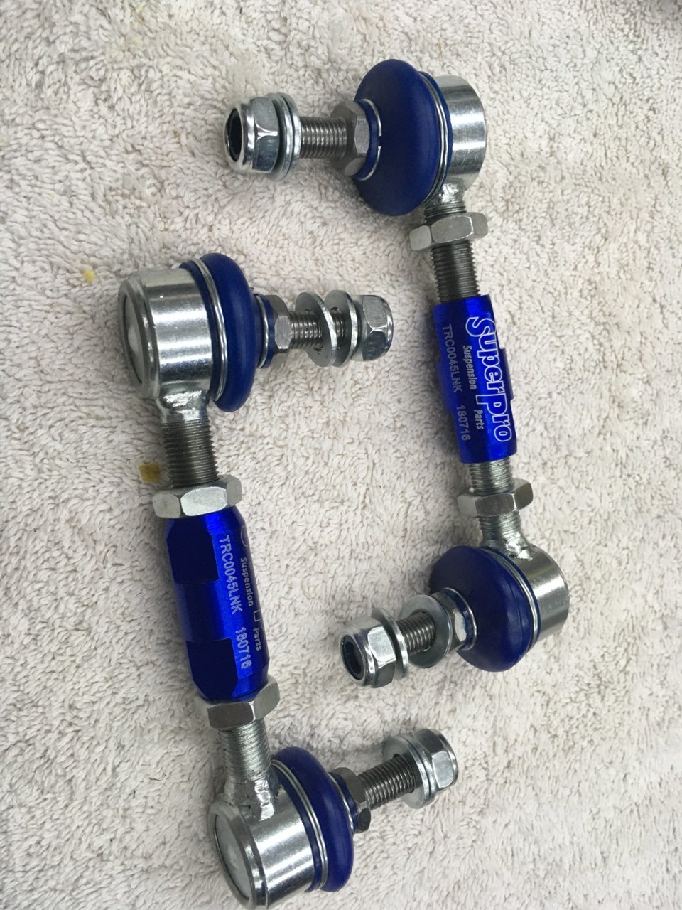

    I have searched and searched....for a Sway Bar Extended Link. After my lift installation the links fit but appear to be at an angle. I would like to find some about 2-3" longer. Has anyone else dealt with this issue and what options are available?
    BTW....I have drop brackets already installed where the sway bar attaches to the frame.

    had to search my history but @mstudt makes custom, I've had the thread sub'd for awhile but haven't purchased for the '04 yet, I think he's got them hashed out now

    Thanks guys...exactly what I was looking for. I just never thought about searching for a "non Tacoma" one. Those should work great.

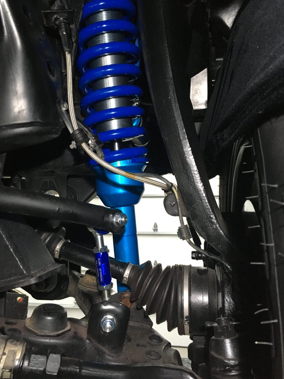

  15. May 19, 2020 at 6:32 AM

    do you have a measurement of stock versus these? did they give an extra 2-3" for the height of the bar? I'm thinking maybe my bar is causing some of my harshness

    I did not do an accurate measurement but I believe it gave me 2-3"...basically doubled the length of the stock ones. I also set them at the shortest length they can go so you could definately get 4-5" over stock if you want. I am happy with them and you can see the angle of my sway bar....good angle.
